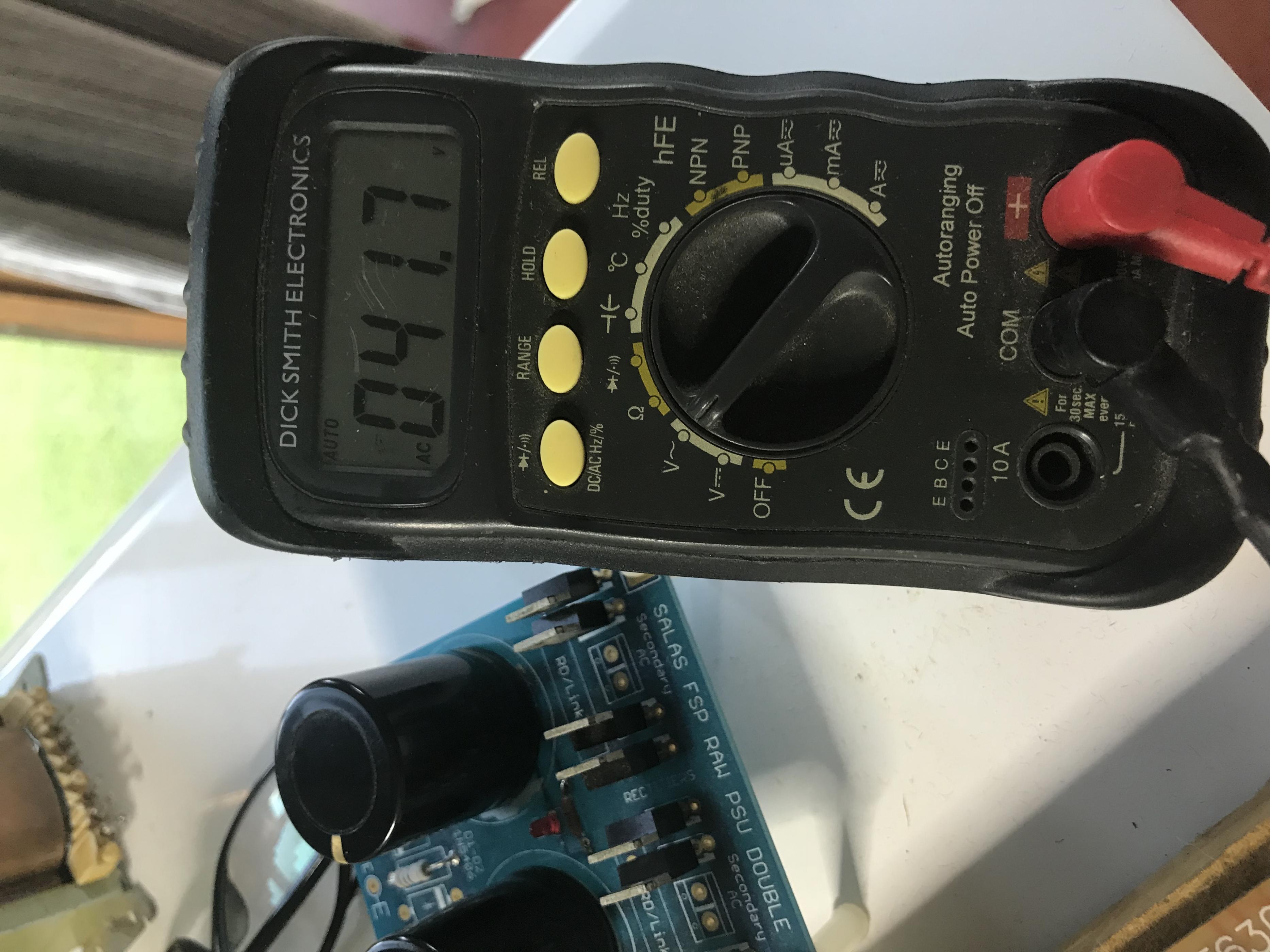

Ok, I’m off again. Psu toroidal 41.7 v ac, this okay?
diyAudio Chief Moderator
Joined 2002
Its high AC. But no worries, because there is provision. Where the raw pcb has the RD/Link marked positions put 47-50 Ohm 5W resistors. That should drop enough Volts.
Test the raw DC outputs across 560 Ohm 10W dummy load resistors before connecting it to the main circuit. Around 45 VDC when loaded will be fine. In case it proves too low or too high DC we will readjust the RD/Link dropper's value.
Normal quality cement resistors (like those white bricks in passive speaker crossovers) will do the job alright.

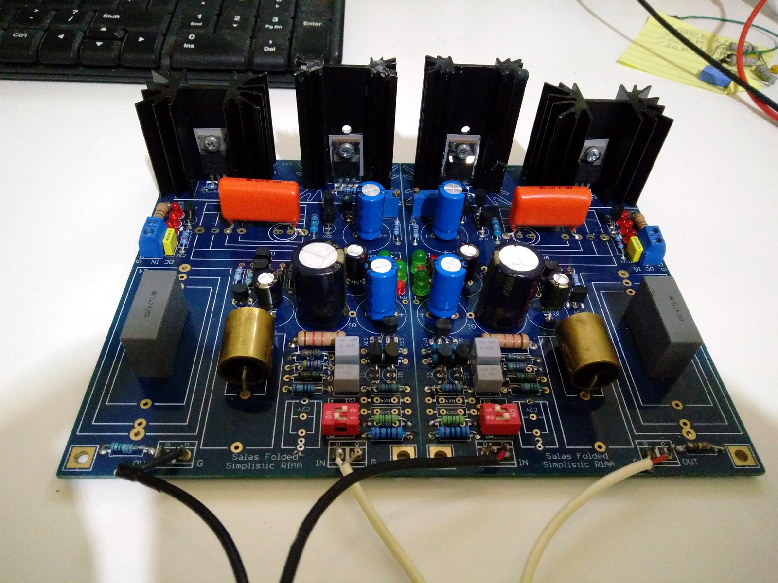

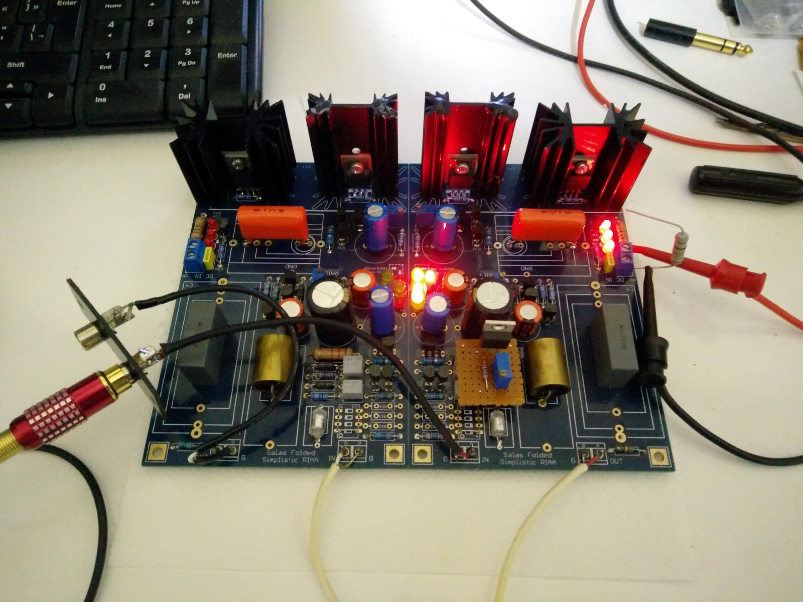

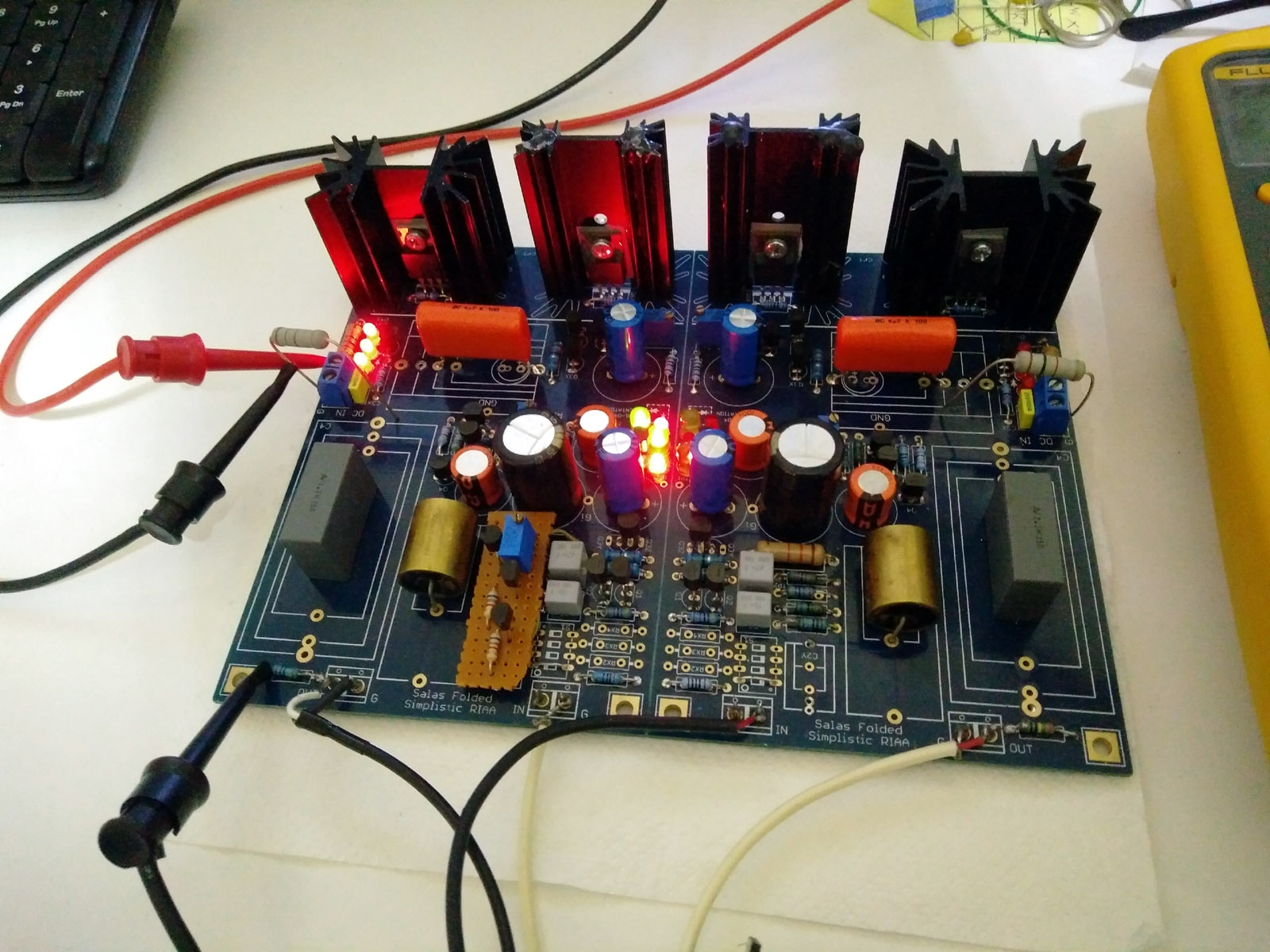

Input stage CCS tests
By the way, on another more general FSP topic now, there was discussion by me a couple of times in the past about what actual noise penalty an active CCS would have brought vs the standard R13 passive CCS and how it would have helped for the K369s drift in MC builds where the source resistors are very low value so the input stage's thermals are wilder.
Well, given the opportunity I was examining a local fellow's rather hit or miss for active parts selection modest FSP attempt, I decided to also test CCS options while reworking it. So I made two mini CCS perfboards for substituting R13 and measure. One has DN2540 depletion mode Mosfet, the other has BC560C cascode and BC327-40 Zener mode ref BJTs. In other words one like those plate CCS we often see in tube amps input stages and another like the Gingertube's Baby Huey input stage current sink but reversed to a source.
I had trimmers in the current sources so by adjusting their current to the folded cascode stage I could change the TP1-TP2 test voltage alike when changing the rail voltage with the FSP's VR2x trimmer when having the R13.
The Mosfet source controlled the TP1-TP2 voltage drift best but gave 6-7dB rise on the noise floor. On the other hand, results with the particular BJT source were erratic. Sometimes it would give the same added noise as the Mosfet's but with worse TP1-TP2 drift, another time the noise would jump too high. The K369s should have been setting off to spurious oscillation due to the small BJT cascode CCS's much wider bandwidth.
Anyway I would have possibly accepted up to 3dB more hiss from the extra active components current noise injection, if with medium sensitivity loudspeakers, but not 6-7dB so R13 is better left to where it is. I did not see THD improvement either when using a CCS. Because the signal swing there is tiny, a higher impedance source than R13 did not matter to better distortion.
I could have argued about better rail noise rejection at least but when I measured the FSP shunt reg's output rail from power off to power on through capacitor coupling to FFT analysis nothing changed from what residual it could display. The same -145dB audio card's grass 10kHz baseline and the same hum spikes that the test cables alone picked up when power was off. So no real ripple or random hiss problems to reject from the B+ line in this. Its all about building with good shielding, careful wiring, and correct grounding, for best harmonic noise result (hum & buzz).
