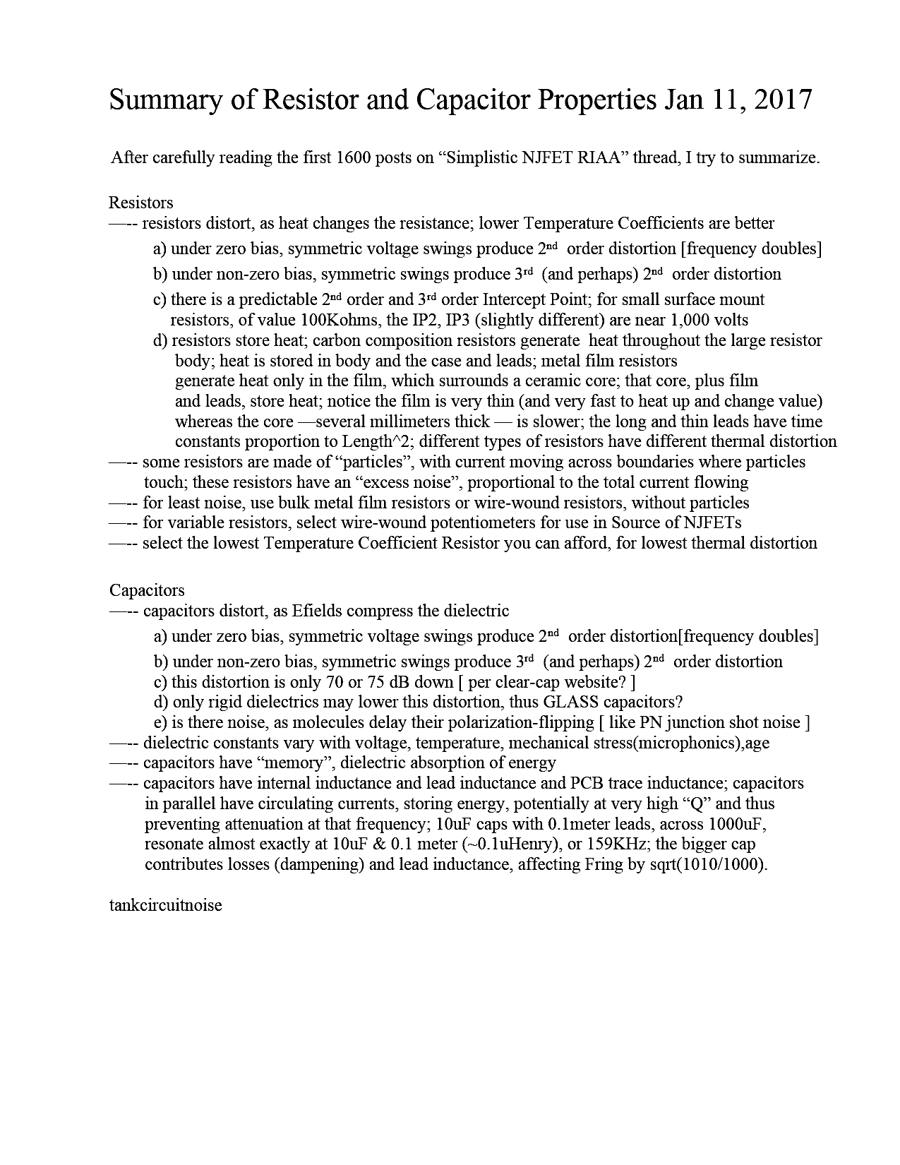

Resistor and Capacitor Properties for RIAA success
hello "Simplistic NJFET RIAA" forum
I've been reading, from post #1 forward, to learn about necessary properties of resistors and capacitors. Now at page 162 (post 1,620)
and still reading, I want to offer the attached attempt, intended to summarize what properties of resistors and capacitors are important for RIAA success.
Please be very critical of my ideas, because its a learning experience for me.

Hi tankcircuitnoise,
Sometimes too much detail will only stop you dead in your tracks. Some of the issues you are concerned about are completely swamped by other issues. There is always a certain amount of inductance in leads and wires. But those frequencies where you would be worried about are so far above the audio range that you can normally ignore them.
Dielectric absorption is normally a problem with high "K" dielectrics. So polystyrene, polypropylene and NP0/C0G ceramic capacitors are the preferred types of capacitors to work with. The worst would be solid tantalum and aluminum electrolytic capacitors.
Noise in resistors is minimized in good metal film resistors. Bulk foil and the like really aren't any better than metal film parts. I would go for the Dale series of resistors. Temperature coefficients aren't really a problem unless you allow the ambient temperatures or the dissipation in the resistors to climb to high values. It would be nice to stay in the 100 ppm per degree celsius.
When choosing component types, keep an eye on which properties are the most important, and the properties that don't affect the circuit strongly. Optimization for one issue normally means that the overall performance is compromised in one or more ways. So don't go for perfect in each part - within reason. Avoid the bigger problems and ignore the small ones unless they become performance limiting.
Design of an RIAA stage could be perfect on paper, yet building (execution) of the design is often where things break down and deliver lower performance than you anticipated. A good RIAA stage has a balance of the design, and the execution (building the actual circuit) of the design.
Best, Chris
Anatech....just thinking here. The Dale (now Vishay) resistors of metal-film, large in size and thus slow to respond to heating, with the 25PPM/degC temperature coefficient, costs $1+ each Mouser, compared to capacitors for RIAA or DC-blocking in the signal path. RN70E is physically big, 17 millimeters from left-to-right. To bend leads, you need 3+3 mm for the needle-nose-pliers, thus 23millimeters plus bend radius, perhaps 3+3mm more, plus 0.5+0.5mm lead radius, totally 23+6+1 = 30millimeters in center-to-center PCB hole spacing.
In exchange for allocating this space ---- for critical resistors exposed to changes in current and thus generating change in power and in temperature, what might we gain? The diameter of 4mm, or radius of 2mm, provides (2mm/1mm)^2 ) 11,400 microseconds thermal tau, or 4*11,400 =45,600 microseconds tau. This is about 22 radians/second or about 4 Hertz.
Which resistors are vulnerable? Those with high voltage & high current, thus the 2 Drain resistors, that set gain.
The "E" rating promises 25 ppm/degreeC thermal coefficient.
Given this is a transient condition with the music dynamics, the resistor never reaches thermal stability as the music changes. To model the distortion, to compute the temperature_rise, I'd just use the core_mass as the storage volume. The larger core, the larger resistor size, the RN70, seems the better choice even given 30mm center-center requirement.
Andrew and I do agree on most things. Not in this case as far as resistor heating is concerned.
You should be using a low tempco type of resistor, but you don't have to get crazy low in that area. For your feedback path you absolutely need a metal film (or better) type part. But there are lower limits where the extra performance does not benefit you. I wouldn't use any better than 50 ppm, and 100 ppm is a lot better than you will ever see in a carbon composition or metal oxide resistor. Don't forget too, some resistors have a voltage coefficient too. Consider any feedback path critical in this regard, and also tempco. Metal film resistors are fine for this location. If you really want to push the limits, they do make resistor networks where the two resistors you could use for the feedback network are together and share the same tempco. This generally makes the absolute temperature coefficient drop out of the equation. Pretty neat eh? Again, audio doesn't need this type of extreme performance. The thermal performance of your speakers will not be nearly as good as your amplifier. The sensitivity of the speaker drops as the voice coil temperature is increased. The types of circuits that use resistor networks and very low tempcos will be Military (guidance systems mostly) and Electronic test and measurement equipment. That's why they exist. With the variables that exist in home music systems you would be just throwing your money away by using the very low tempco resistors (anything below 50 ppm). Even the 50 ppm resistors are somewhat overdoing things.
-Chris

I think we are both agreeing that metal film 50ppm/C, or 100ppm/C, are good enough and provided the voltage coefficient does not ruin the ratio of upper to lower then all should be OK.
What part did we not agree on?
Something to do with the recommendation to not overheat the upper resistor by keeping dissipation below 10% of Pmax? where I said
I have recommended using <10% of the maximum power rating after reading much from proper Designers,
Administrator
Joined 2004
Hi Andrew,
Feedback resistors are often called upon to dissipate large portions of their rated power and sometimes do exercise their thermal temperature coefficients. I've actually seen some that have burned a hole in the circuit board as they expired, amplifier following moments later. The exact amplifier that actually burned through the PCB? Carver Lightstar series 1 amplifier. I suspect it was allowed to run well into clipping without a load for an extended period of time. I forget which reviewer had it at the time, but he was completely irresponsible.
Anyway, the point being is that you cannot assume the feedback resistor going to the output will not be called upon to dissipate high amounts of power. This is especially true in a fault condition or operator abuse. Why do I assume that in the example above there was no load? Well, if there was one, there probably wasn't a load by the time the amplifier expired. I still have that circuit board around here somewhere. It reminds me to look past what would normally be considered a performance limit.
As I said Andrew, we normally do agree, but I wasn't certain that agreement held to everything I was about to post.
