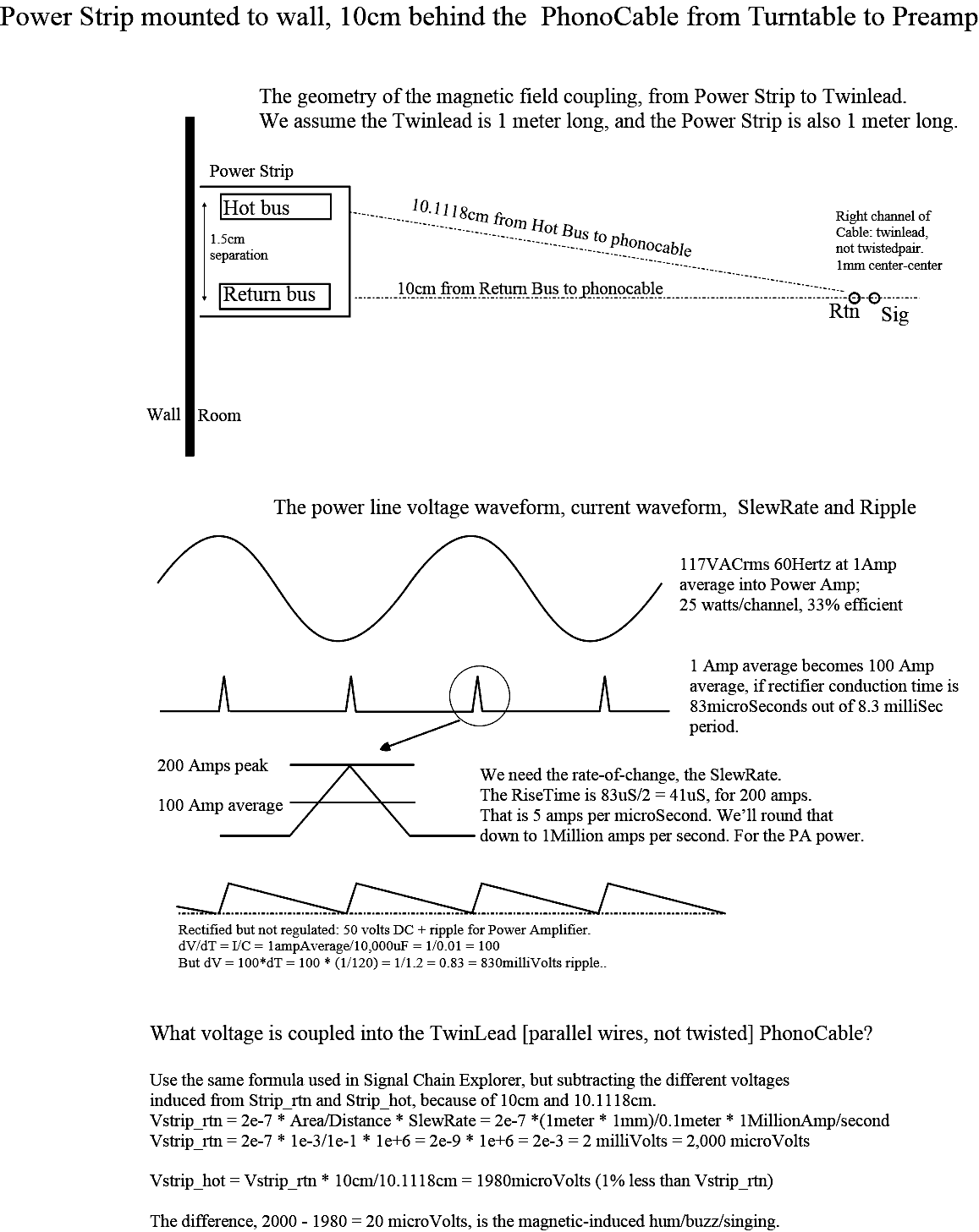

Power Strip induces 20microVolts into TwinLead, 1uV into TwistedPair
Looking at PCBs, there are loops everywhere. And wiring/cables are loops.
When you make your own twistedpair, the irregular twisting will cause inconsistent nulling of external fields. And where any cable is soldered to a connector, there will be a vulnerable loop formed by Signal & Return.
Having simple math for planar aggressor_wire and victim_loop, I use it.
I assume a PowerStrip attached to wall, 10cm behind the Audio Rack and extending a full meter left-to-right (yes, I know that is a huge Strip). I also have the TwinLead (not TwistedPair) running a meter from TurnTable to RIAA PreAmp, exactly parallel to the PowerStrip and 10cm away.
Result? A lonely wire, Hot or Return, of the PowerStrip induces 2,000uV.
The real PowerStrip, with Hot bus close to the Return bus, induces 20uV.
Into TwinLead.
Into TwistedPair, this should drop another 20X (26dB), else why use TP.
The loop area of the TwinLead is 1meter * 1mm, or 1cm*10cm, with 20uV induced.
If your construction has 1cm*1cm loops, that Power Strip will, worst case,
induce 2uV.
Here is the attachment. Avoid nearby PowerStrips.

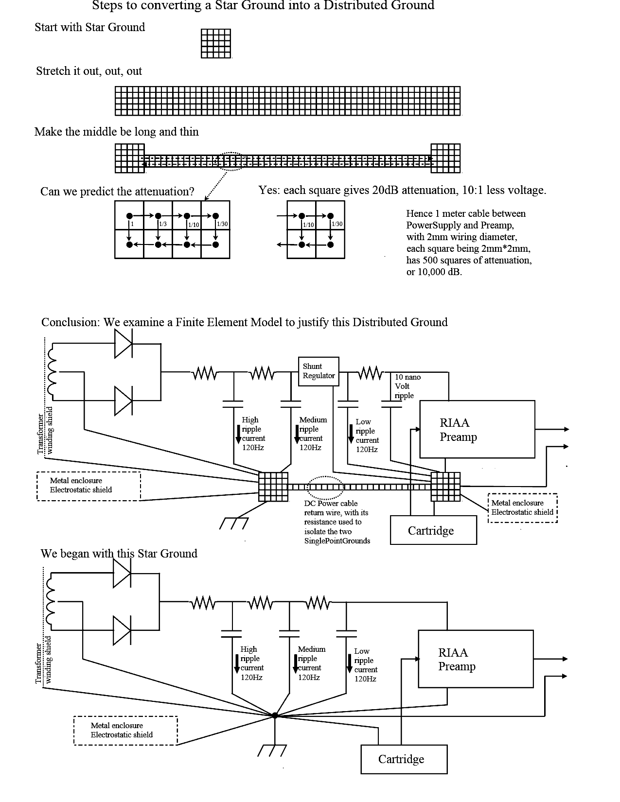

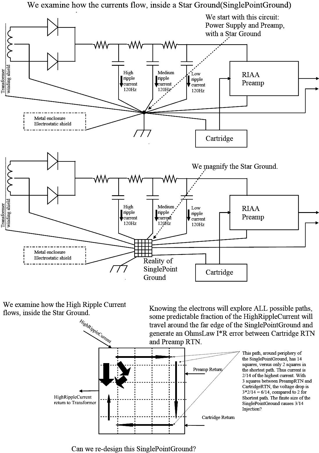

Convert Star Ground (SinglePointGround) into Distributed Ground
Respecting the need for very low noise (random and repetitive) in RIAA Preamps, I'm revisiting some thoughts on Grounds.
Any comments from the forum readers are VERY WELCOME.
With 100 milliamp DC currents and 10microOhm resistances, the voltage drops "inside" the Star are 0.1 * 10u = 1microVolt. The DC blocking inside Salas rejects this. But out of rectifier diodes, the surge currents will be 1 to 10 amps with waveform an ugly narrow-in-time broadband-in-frequency 120Hz hump.
What is to be done?
In attachment#1, I magnify the Star Ground into a 5*5 grid, with High Ripple Currents entering and exiting on the left side. I show how a fraction of that current flows between the Preamp RTN and the Cartridge RTN.
My crude FEM Finite Element Model uses Count_the_Squares analysis to predict the voltage drop between Preamp RTN and Cartridge RTN.
Observation: a large distance between High Ripple Currents and the path between Preamp/Cartridge seems a good idea. Can we do that?
In attachment#2, I stretch out the Star to bring a large distance into the grid. And I greatly narrow the middle portion of the grid, into dogbone shape.
To my surprise, again using FEM thoughts, the attenuation of the middle is approximately computable. Attenuation is 10:1 per square (2*2 elements in this square). A 1 meter wire, 2mm GND wire diameter, has 500 squares.
We expect 10^500 isolation. (Magnetic fields are another issue.)
Conclusion: we have a (approximate, using FEM) huge isolation of Ripple Currents, if we locate PowerSupply away from Preamp.
Again, comments from Forum readers are very welcome.

I slowly came to the conclusion that each current loop needs to be resolved locally using the lowest loop area to minimise emi.
Then connect these loops together where required.
Using your first diagram. That means the charging loop into the first capacitor should be done as a local loop, but for three wires since you have two rectifier outputs.
The second loop is the charging circuit for the second capacitor. That connects from the previous capacitor pins. This too is resolved locally using minimised loop area.
This is repeated for the third capacitor by connecting to the pins of the second capacitor. Comparing those first three loops, I can see a similarity to your second diagram. Just stretch your first 5x5 grid to a 3wide by 10long grid. The first cap -ve connects to the middle square at extreme left, the second cap -ve connects to the middle square on the 10th row. And you move the -ve route to beside or over the +ve current route.
The RIAA pre gets it's power via a low loop area two, or three wire (if dual polarity), connection from it's power source.
It is the use of low loop area connections that minimises the loop impedance, just reducing resistance does not achieve this lowest impedance requirement. Ground and power planes also achieve lowest loop area by minimising loop area. The planes allow the currents to flow in regions of the planes that lie one above the other to minimise loop area and thus minimise impedance and thus minimise emi.
I disagree with the transformer shield going to the Audio/Power Ground plane.
The shield must go to the enclosure using the lowest impedance (very short) connection. This allows the very high frequencies to couple to "Earth" via the capacitance between the enclosure and "Earth"
H.Ott discusses this. He reminds us that the very high frequencies do not return to "Earth" via the protective earth wire. That wire has far too high an impedance.
He also discusses the advantage of using wide and thin tape/strap for interconncting when lowest impedance is required. But no transformer I have ever seen has a tape shield connection. They all use a stranded (bundled) wire and make it far too long. This excessive length tempts many Builders into the trap of taking the shield via a higher impedance to some remote connection that is often not part of the enclosure.
