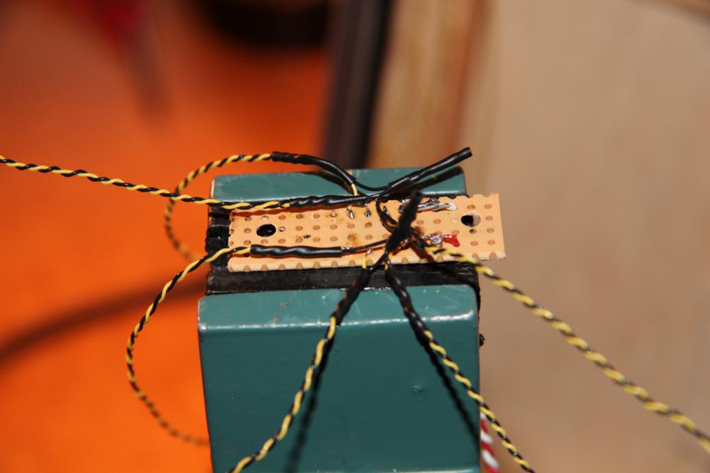

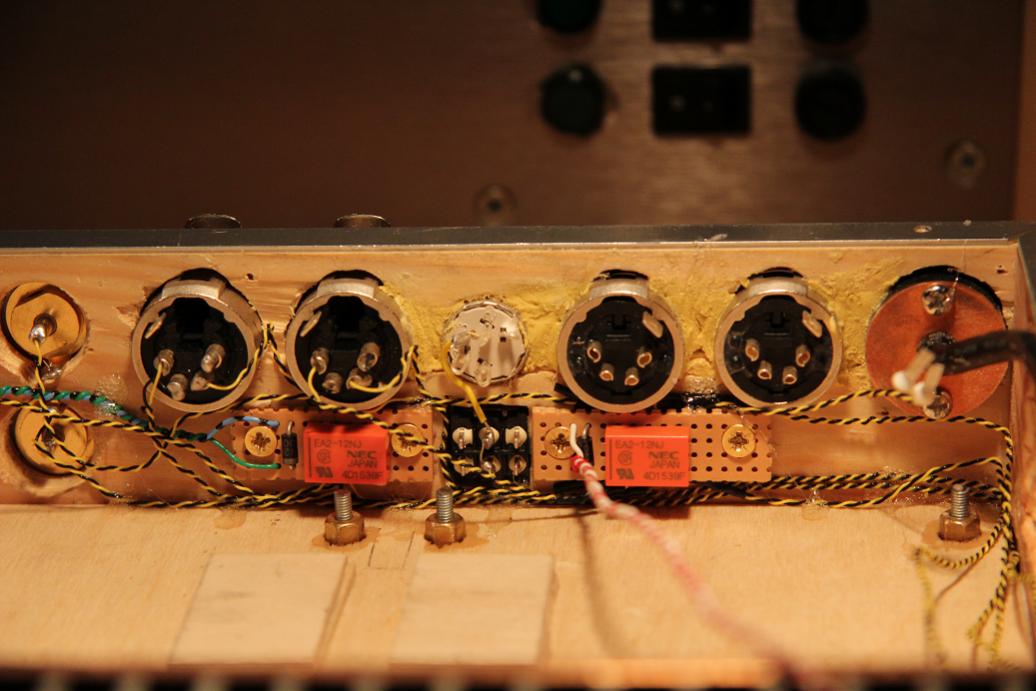

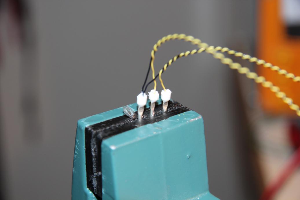

Halfway though backpaneling. I use very thin solid signalcabling so I clamp them in the ends so I dont kill them everytime I test install them. PCB relays was a little tricky to solder but I hope it will work in the long run. Works now anyway.
Todo is FSP in, 4 pole XLR Line 1 and 2 in. Left relay is output select between leftest 4 pole XLR and the two RCA, soldered to XLR as NC. Rightest relay is select between FSP direct out (NC) and FSP to Muses Electronic volume control.
That meens after soldering FSP in from the female 5 pole DIN in the middle (2 ch plus ground lug), mounting the boards, convering a vinyl rig to DIN, and rig a temporary PSU I could play some records if I get starved:)
Now off to some boatjob, update in the evening.

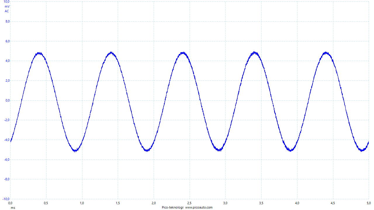

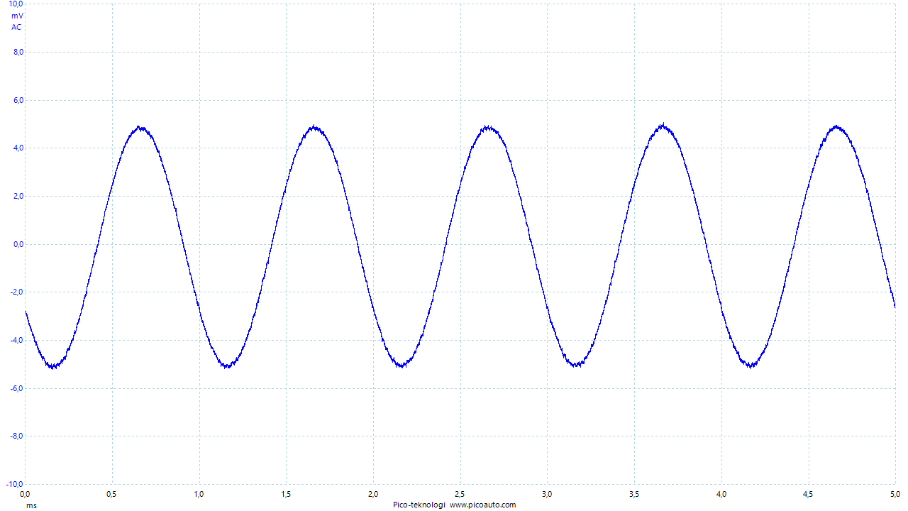

Firstly I went over it with DMM Buzz and made sure there was contact where it should, and it was. Then I wanted to look for eventual interferences so I rigged the scope and signal generator. A tiny 5 mV RMS sinus signal was sent thru each and every signal way, switching the relays to see that it worked and donesnt pick up interference from relay coils or other stuff. Showing a pic on scope to gen direct and then a general picture on the same with a signal way inbetween, this one is DCB1 out thru activated relay to XLR female. All of them looked pretty much the same. Interference is background noice cause it so small signal and no top plate on box.

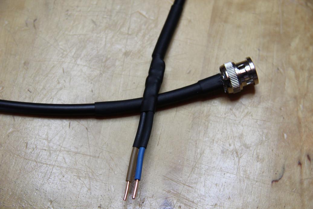

For the female XLRs I had to make an adaptor cause it was to crowded to mount any probe or clip anywhere. Made it from RG45 and solid 1,5 mm copper wires to stick into the XLR holes. Worked great.
The relay coil operates on DC with a bit of noise.
The DC current cannot create emi. It needs a changing current to do that.
The interference/noise mixed with the DC is a changing current and can emit emi. We attenuate that by keeping the noise/interference level on the DC feed as low as reasonable and by sending the flow and return currents along a close coupled, or twisted pair.
The combination of low noise and close coupling turns the interference into a non problem for line level signals.
Compare the AC heater current in a valve and what it does to interfere with the wanted signal. Here the interference current could be nearly a million times (+120dB) higher and yet I believe they only do noise/hum attenuation for low signal level stages.

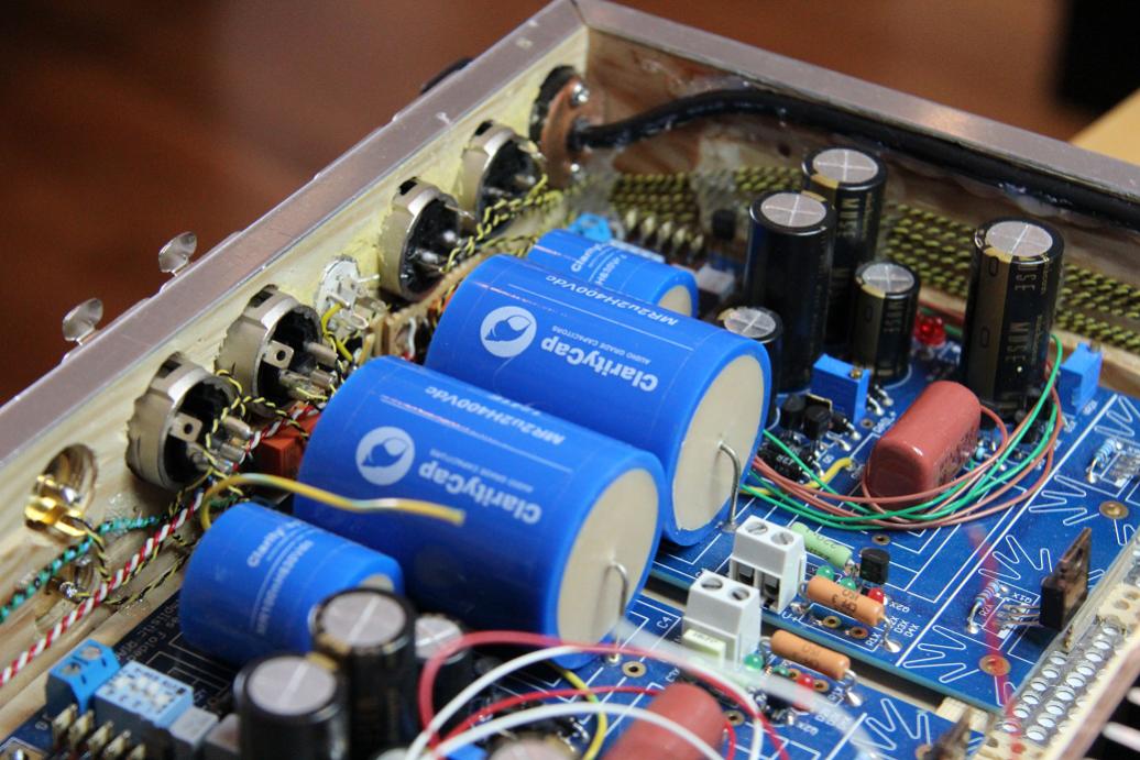

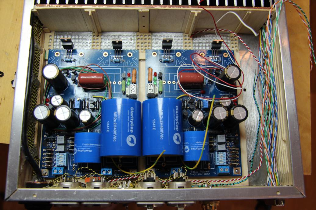

The inside
As you can see I cut back the PCB to allow the four power devices to heat sink against the aluminium chassis. The chassis is the pressed against gap pad and onto the heat sink. The four devices are isolated from the metalwork.
All the four devices run very cool.
The acrylic lid is not fitted.
