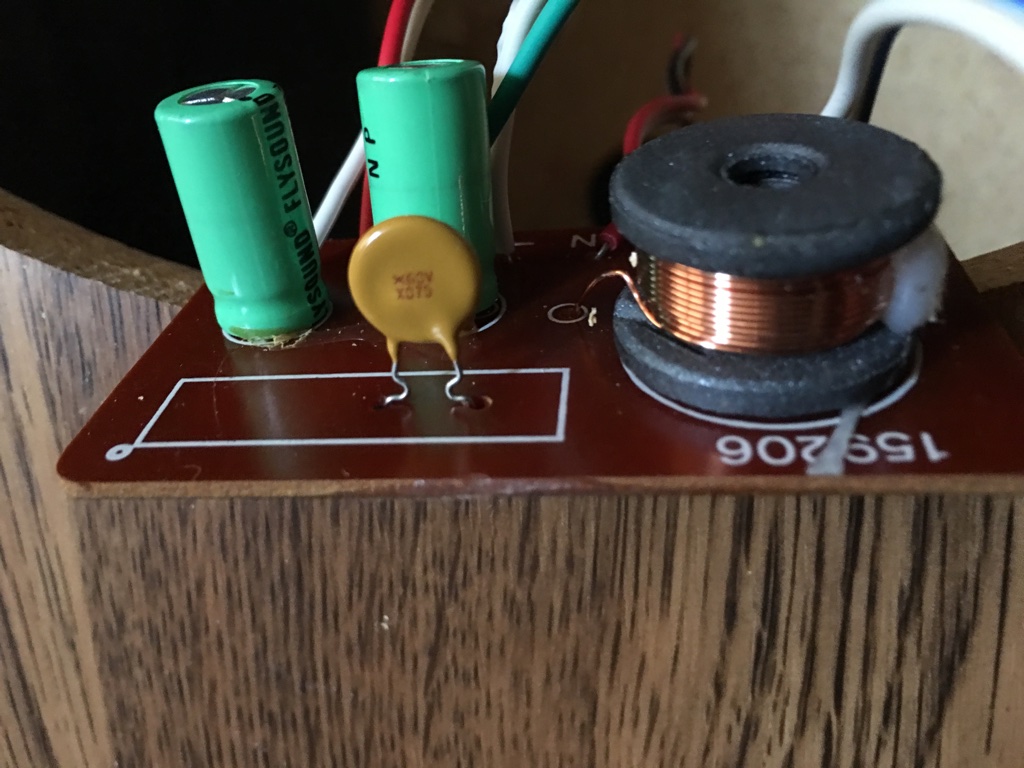

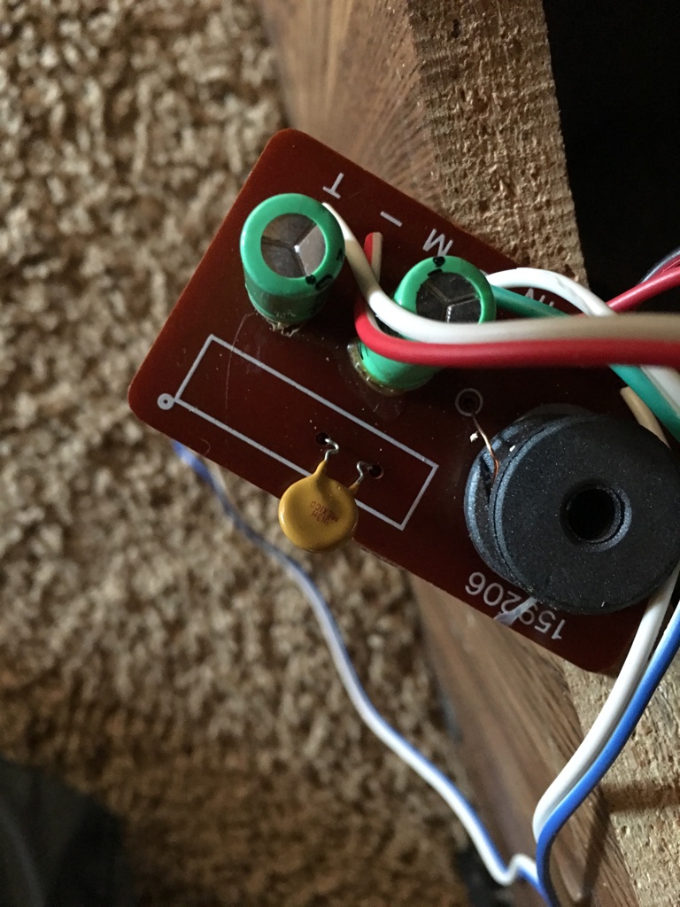

b. I have very old Pioneer CS-G7001 speakers for my general tests needs (got them for $20) and I'm trying to replace Ele caps in crossovers (40 years old caps). I find some part that I do not know what is it. I thought it is ceramic cap, but it is not. No capacitance on it. R=0.67 Ohm. Thought it might be Thermistor or Varistor, but can find any similarly looking piece on internet.
So, may you know what it is...

PTC "resistor" maybe. For protection like a resetting slow blow fuse. PTC thermistors are in essence resistors with a positive temperature coefficient.
Although you probably wanted to post (b) in some other thread in the multiway section for more opinions.
