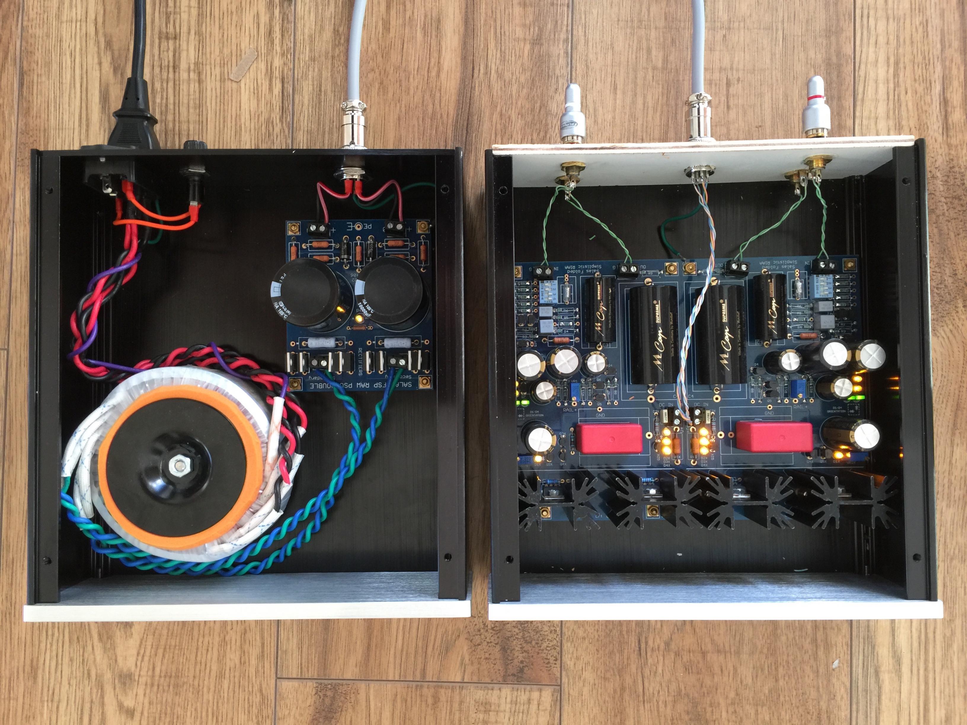

So some Led there was weak and went out. Maybe the soldering tortured it. 3mm Leds are kinda sensitive. Go there with the DMM in diode mode and measure one by one. No need to remove them for finding which one conducts and which one doesn't. Find the culprit(s) and replace them. If they are good maybe Q7 is out. Its their current feeder.
15,937 posts and finally some color. :rofl:
I finally was able to box them up. Separates are the way to go, I'd like to see the transformer at least 12" away.
Don't ask about the wooden panel.
