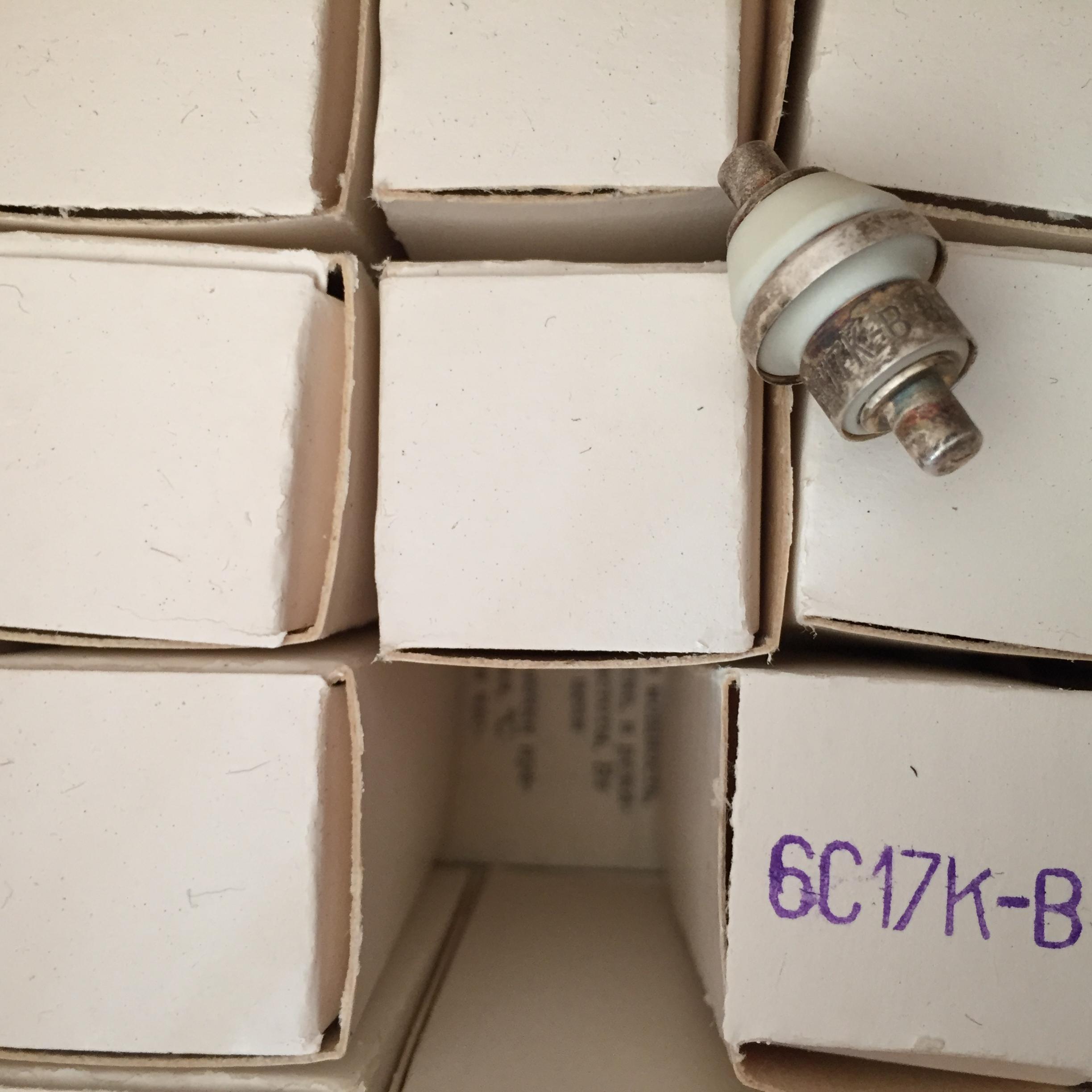

Salad, my curiosity is piqued by your altered version of the Millet design. I am looking at and wide for something to unseat the Simplistic.
That post is very old, it was before the simplistic started fledgling so don't be so hopeful to unseat your FSP with a modified S. Bench because meantime the Itch unseated the S.B. and so on and so forth.
Anyway I have in mind to revisit the valves phono route sometime since I got a wonder box of various interesting Eastern European matched types that Stajo kindly provided me at a point in the past. As a teaser to keep me curious...That crafty Viking
Whatever vacuum competent enough to weigh against FSP will most likely be way more involved and expensive to build though. Such things to come out good demand inspiration and much R&D work when no other asides are running nonetheless.

Rest easy my friend. Just moved a shipment of 7n7.RCA black anodes glued boxes. Pandora sleeps.
Good 6.3V Loctal tubes those 7N7s, 6SN7s in essence, most probably Sylvania OEM. There are even new Loctal bases still produced in Asia.
