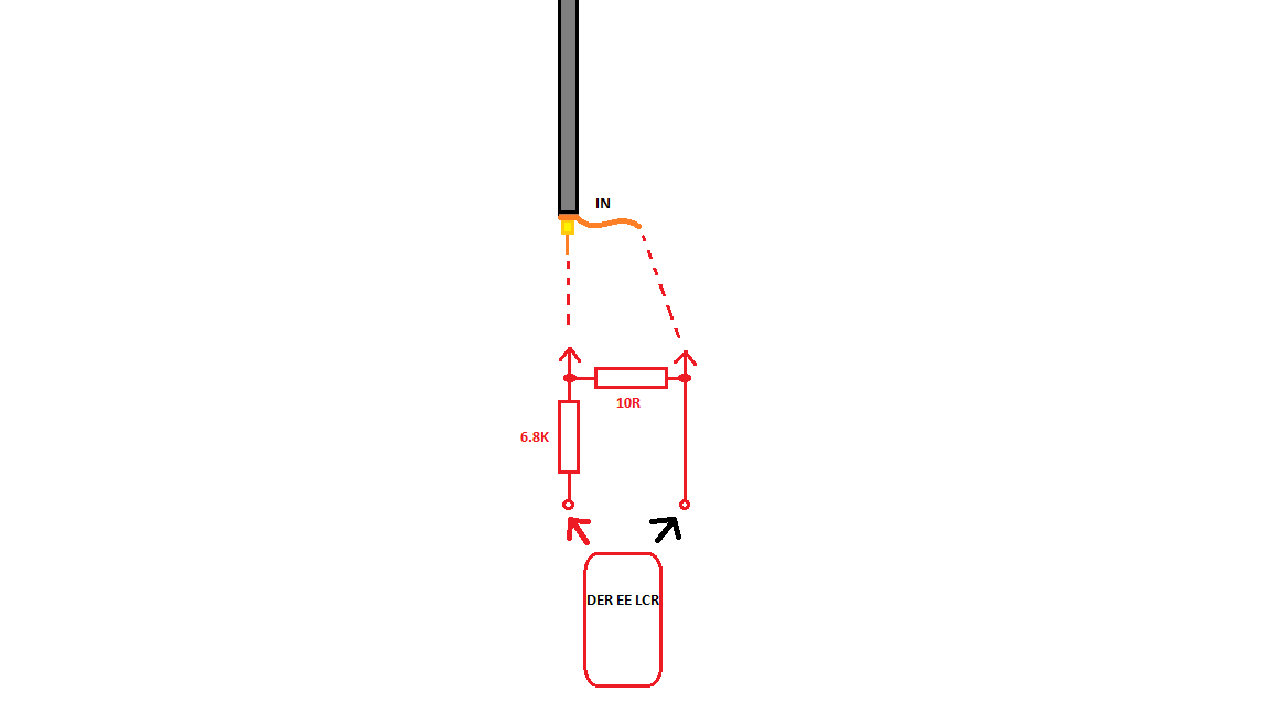

Yes, after last Salas's comments I got that we use classic V divider. Thank you guys. I'll test it soon and let you know. I can convert mV to dBm, but do not know how to convert to dB. Or dBm is good enough to see channels differences.

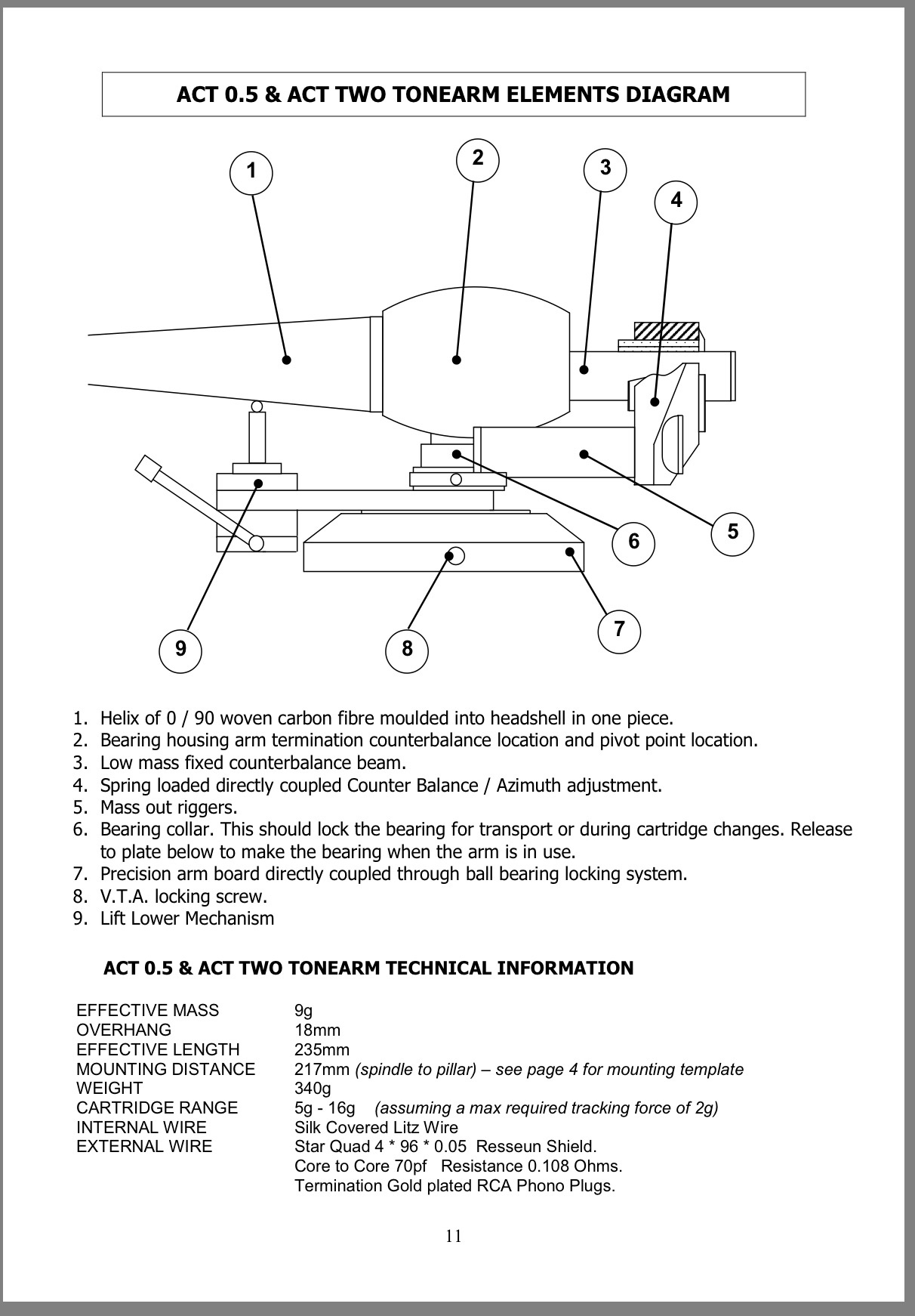

Yes, it is TT cable channels swap. I'll try to tweak anti-skating farther, but already spent some time to set it right. What model will be suitable for my low weight carbon fiber arm?

What's the effective mass of your tonearm?
I have Wilson Benesch ACT -0.5. It is 9 gr effective mass.
Looks compatible enough for ATs
