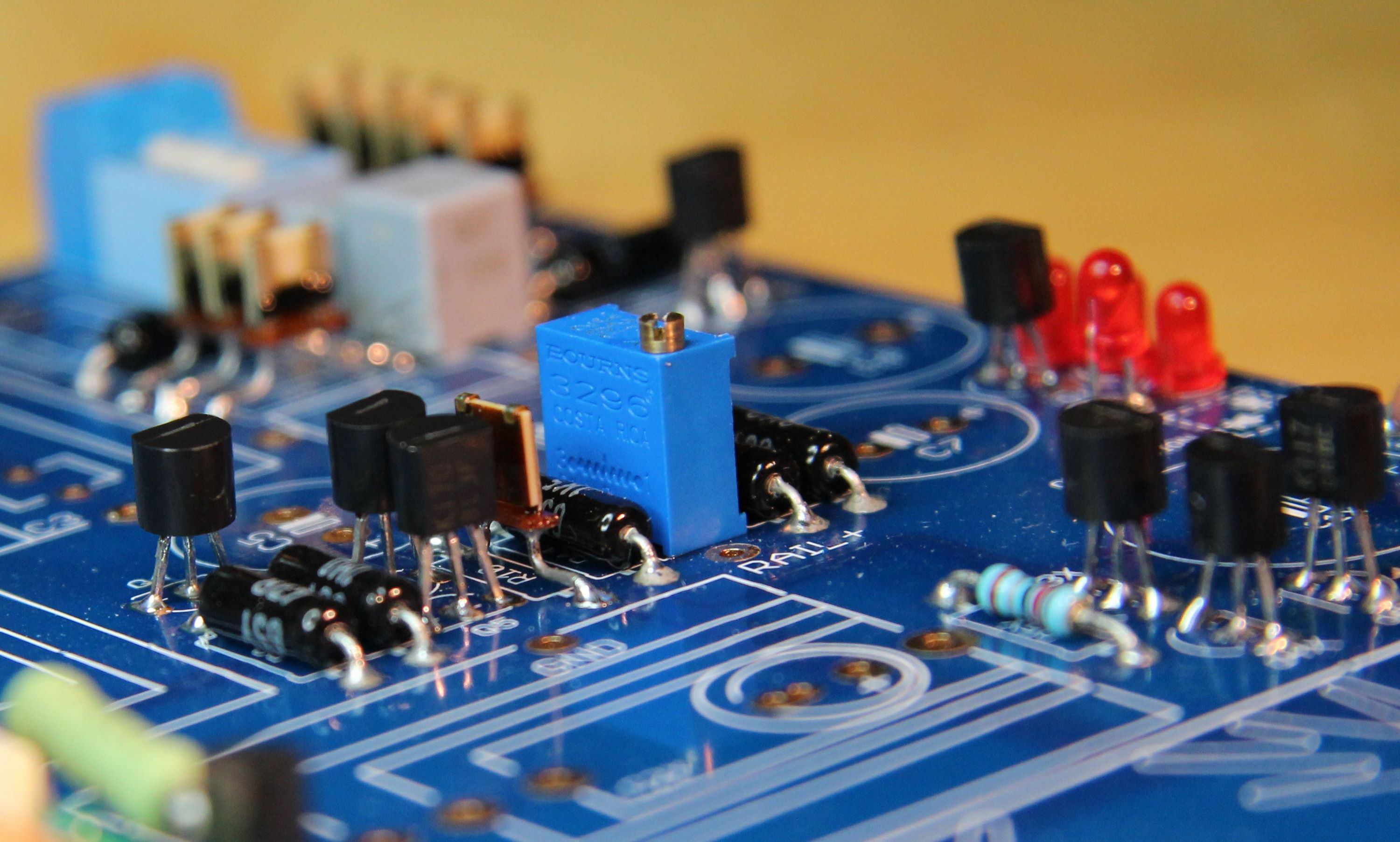

Anyway I ended up mounting the 2sk170BL's like this:
Q4 Idss: 8.33
Q5 Idss: 7.60
Q6 Idss: 8.80
For curiosity I tested them all in my little second stage dummy and performed automatic RMS measures with my Pico. It variated at the most between 5,021 and 5,040 VRMS since all was from same batch. Between the pairs it variated max 0,004 VRMS. Totally uninteresting for the performance of the riaa but interesting for other reasons maybe.

Finally got back to working on the phono stage.
Must admit again to my apostasy - using a Belleson 35 volts regulator instead of the on-board shunt.
Everything seems to work, but in the time since I first had a "working" board (in quotes because it never produced any sound - only tested it until something went wrong) I may have forgot how long it takes to reach the magical 3.6 V.
First off, to those who read this and have yet to apply power to your PCB - I now see (always have to learn the hard way) that when SALAS says to turn it on and leave it alone for 20 minutes, assuming one centered the pots before inserting them into the board, he is telling you something very important.
I immediately started fiddling with my one remaining pot and I am sure this is why it is taking so long to find the right spot.
BUT, is it normal for bias to take well over an hour to be reached? Just curious.
I made little lead hats for the 369's and this seems to speed up the process, I cannot imagine how long OR IF I would reach 3.6 V without them. They do not fit tightly around the 369s and there is a little space at the bottom so they are not sealed tight but I do think they add a measure of consistency. This is very early on and not meant as a proof of goodness, just a reporting of what I have done.
Mainly wondering if my slow attaining of correct bias is normal or is it signaling something else I have done wrong.
Voltage from the reg at the board is 35.05 volts. The reg has a bleed resistor at its output to waste about 20 mA. The raw supply is a pair of old DYNACO ST-150 power transformers (50-0-50), full wave with a pair of MBR735 that I had laying about into a HAMMOND 5 Hy/26R/500 ma choke, a 4700 uf cap and a bleed resistor whose value I cannot remember for an output when connected to the board of 40.5 volts. Glad to be putting these old lumps to work. No additional series resistance in the supply.

The higher the internal temperatures the longer it takes for temperatures to reach final.
During that time bias of many parts will change.
Keeping everything inside cooler shortens temperature stabilisation time.
My experience, now with the second board, is that if left out in the open air I do not think it would ever reach 3.6 V.
I do think the lead hat idea was bad. Had to try it. If that is what you were speaking to directly you are unequivocally correct!
I have now built a small enclosure around the PCB (sits upon the PCB) with thick wool felt and using a piece of SCOTCHBRITE pad as the top. This allow, I think, a fairly constant temperature. The SCOtCHBRITE seems to breath just the right amount.
I have got a fairly steady 3.6 - though one wonders what will happen in the winter? Not that it would bother me to have to check on it when the room temperature changes.
No question, this is a phono amp that should be left on which is what I would have done anyway.
