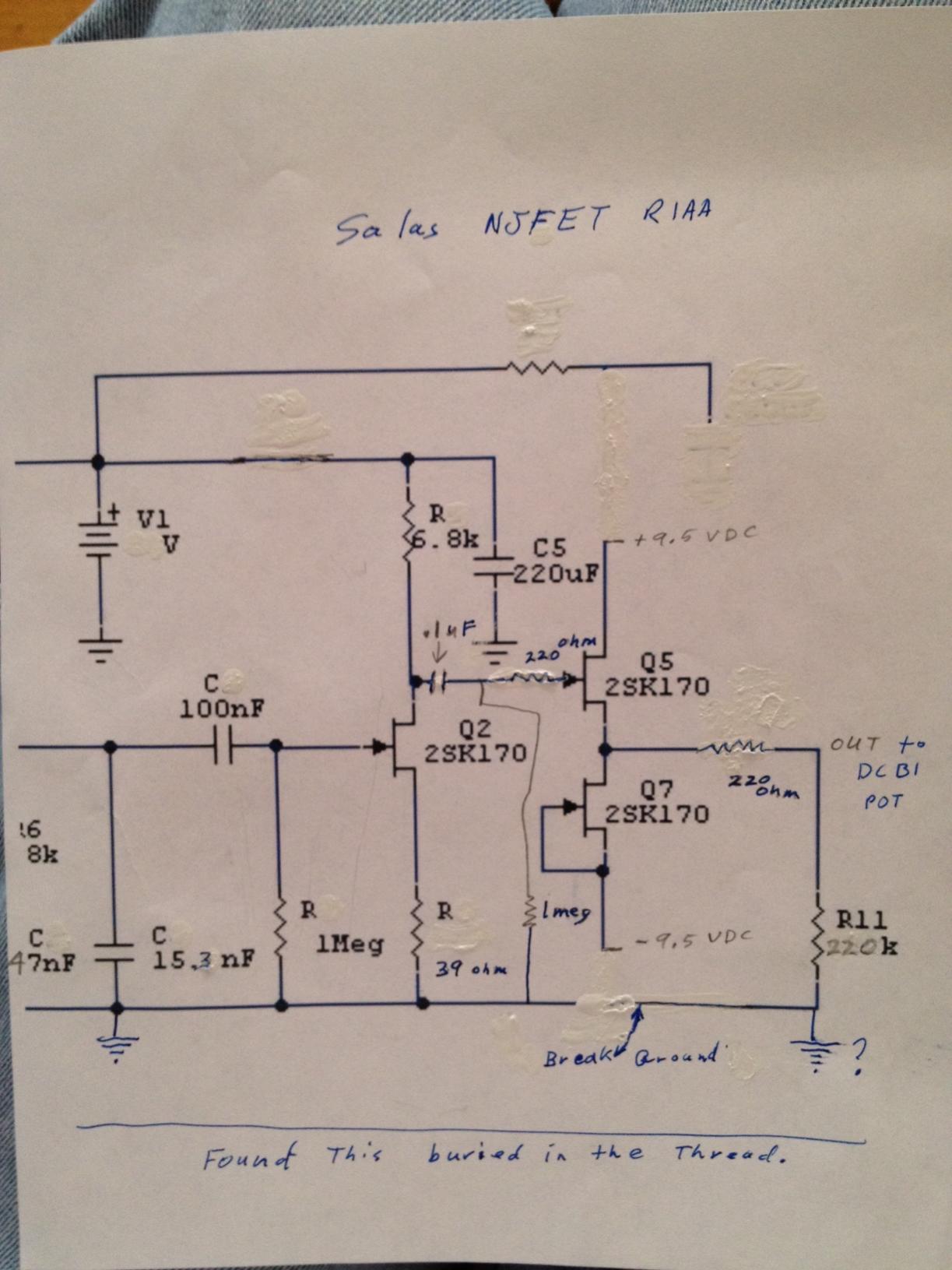

It worked great, no hum.
I can find the diagram when I get home tonight and post, but in a nut shell, used a common ground from both supplies in outboard chasis to single point in preamp.
So that was +/- 17 volts for DCB1 and +38 volts (or whatever it was raw) for RIAA and the common ground = 4 wires.

Here is my very rough white-out drawing.
Rush

I have two transformers that I can use with the FSP.A Toroidy Toroid which gives 43vdc unloaded and a Selectronique R core which gives 48vdc again unloaded.Both have 15v secondaries connected in series the toroid giving 33v and the R core 38v unloaded.
Which would be the best to use bearing in mind that I have been using the FSP with the toroid with no problems.The heatsinks barely get warm.
