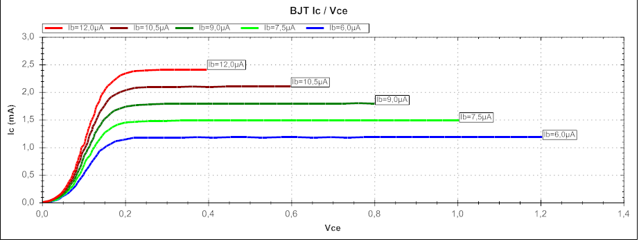

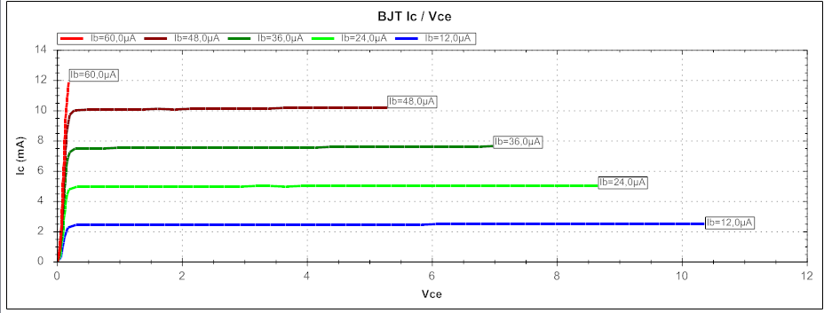

The PSRR depends on the specific transistor you use in the C-multiplier. You'll just have to try many different ones and see which kind has the lowest ripple at the output. If you follow through, I'll be eager to hear your results.
Simulation is usually optimistic on the PSRR here because quasi-saturation is not modeled. The reason simulation is accurate for the BC5xx/3x7 is because these transistors don't have much quasi-saturation to speak of.
