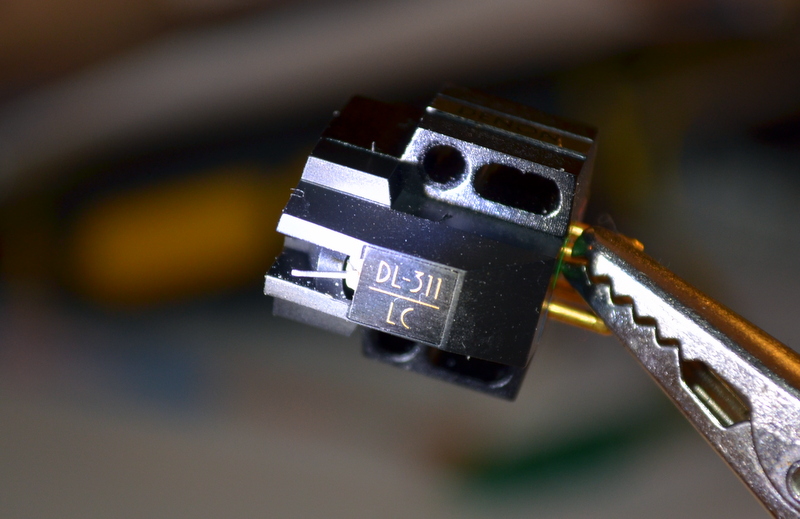

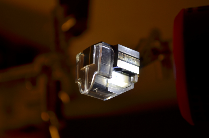

I got the cart today. It appears to be in excellent condition. I took a few pictures of it tonight, but I'll take more tomorrow in better light and mount it. Here are some teasers :)

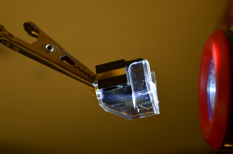

This was as it arrived, with stylus guard, but not in original packaging. It was in a nice rigid plastic box with cotton.
Other side:

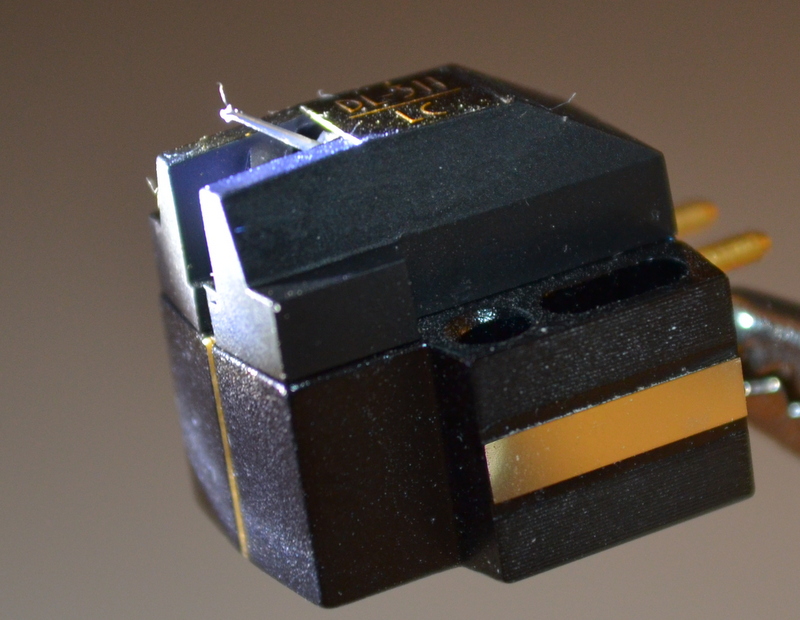

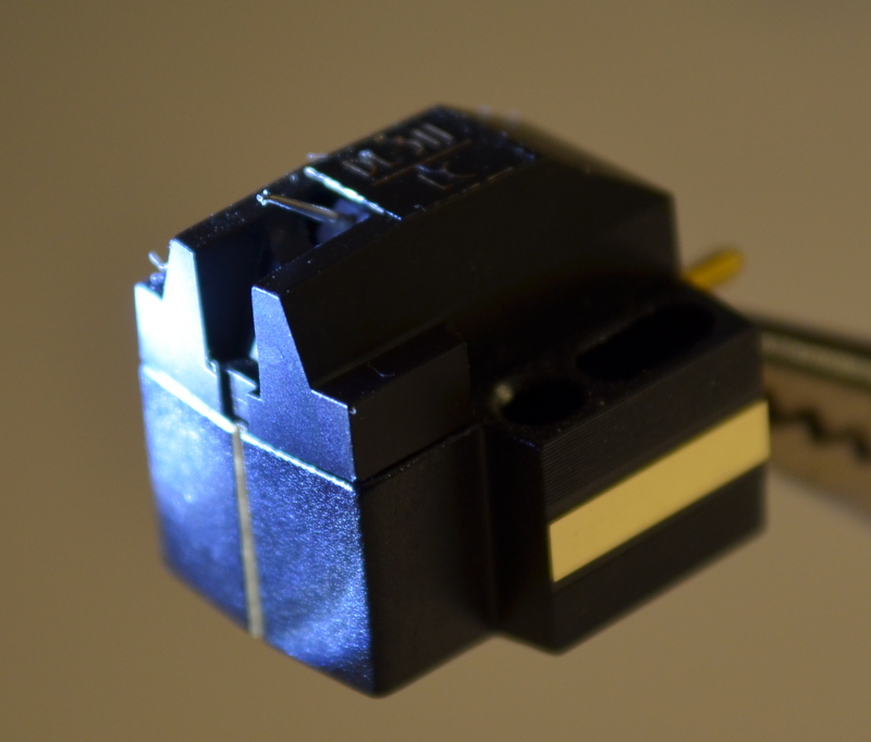

A bit of cotton was stuck on the stylus; I removed it later with a soft brush:

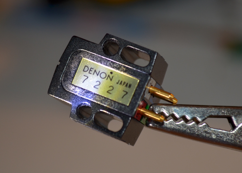

Here's the bottom and top:
