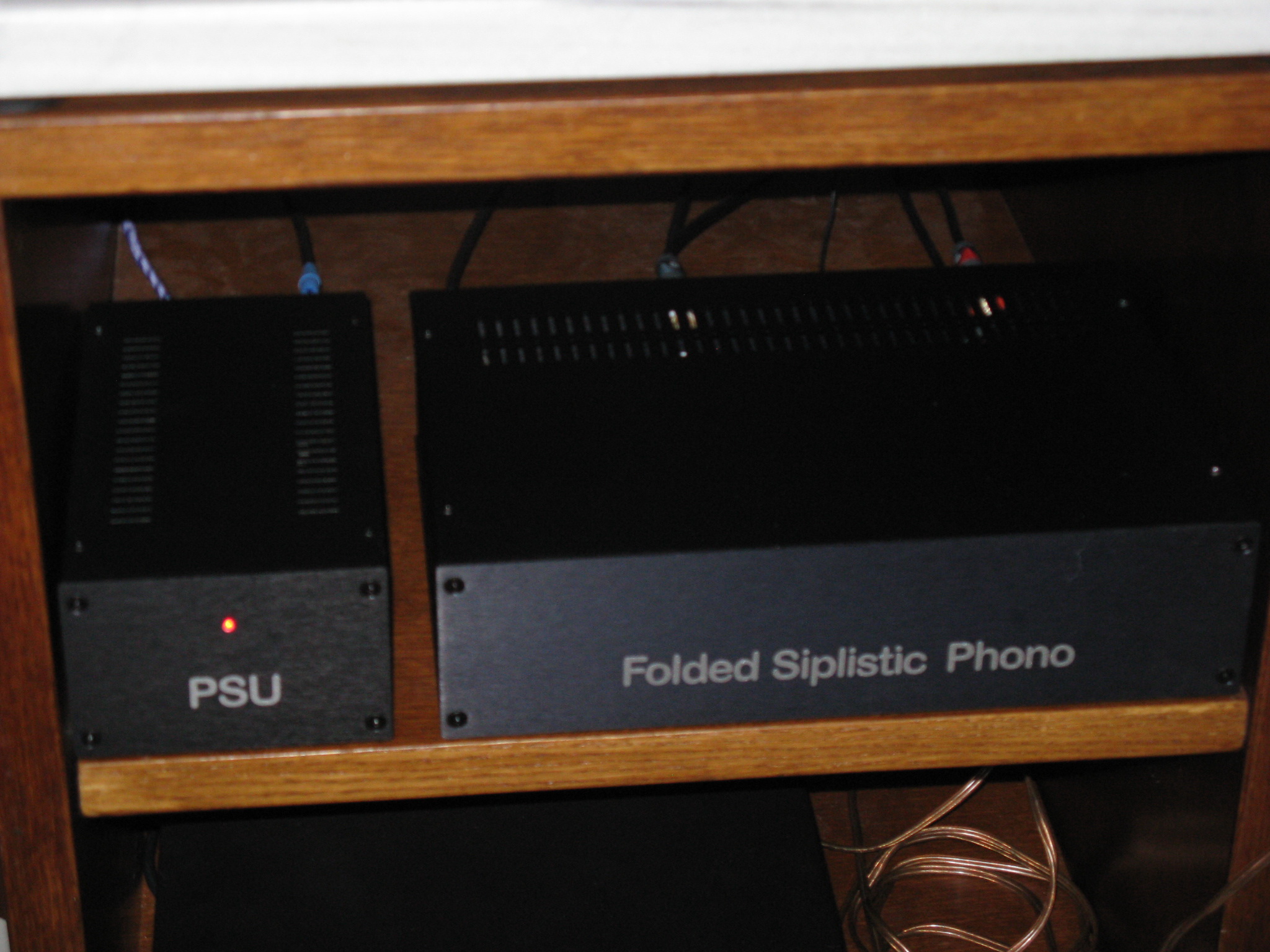

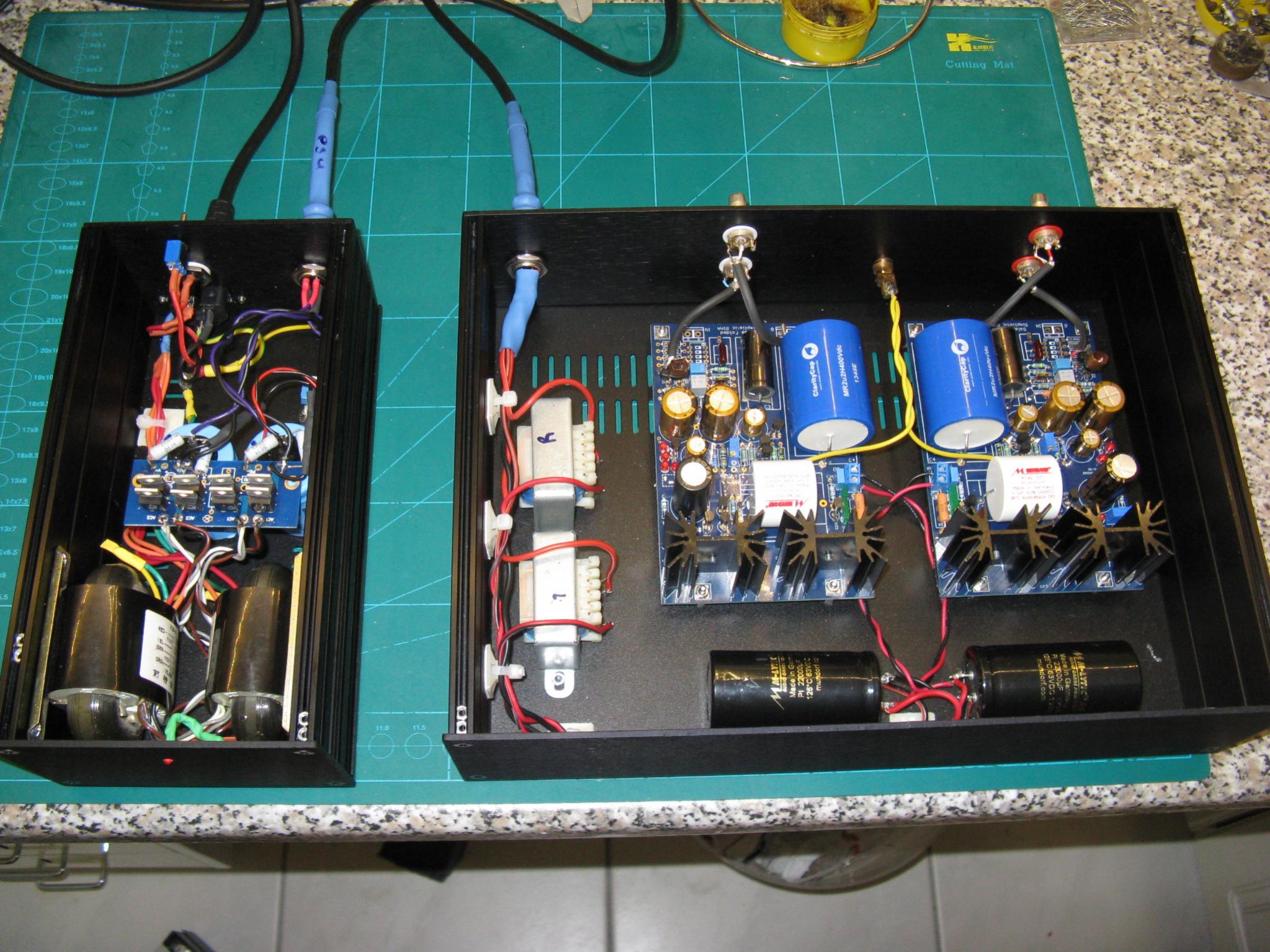

Finally my my FSP found a decent home :)

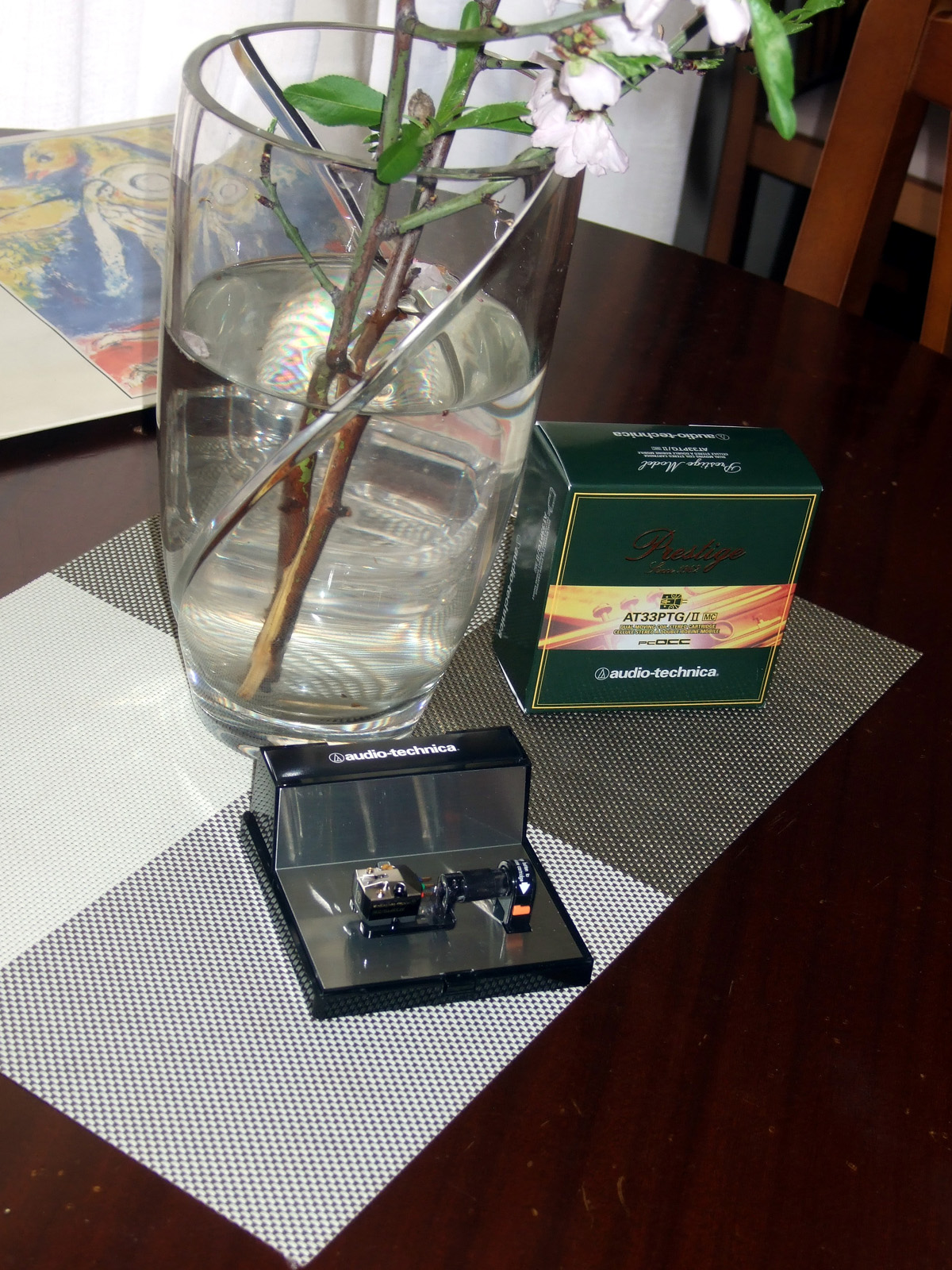

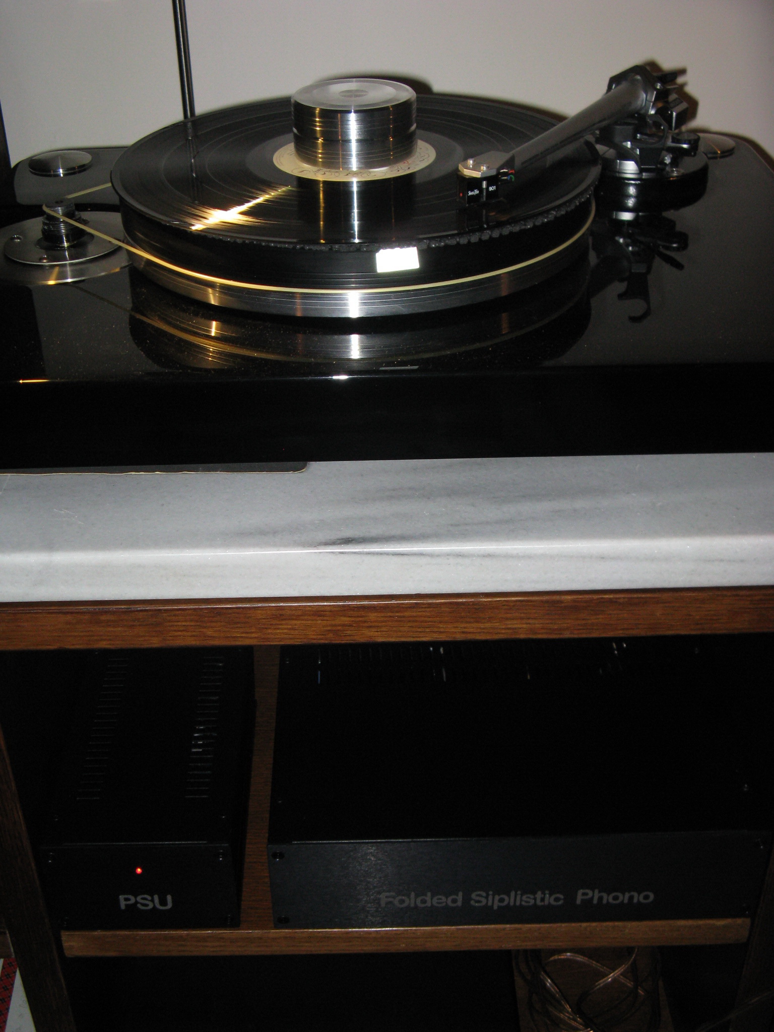

You affirmation about the 33 series which I was eying for a while helped to tip the scales so I took the decision to finally try one out. It came in from Japan today. Its the AT-33PTG/II. Took enough work to reset the arm about right when moving on from the Denon. Seems VTA sensitive and load sensitive. There are still some geometrical details I want to revisit. Only few Lps I played as for now. Nonetheless it greets with a realistic and smooth nature along with very good tracking, throws a wide sound not in expense of ambient clues leading to enhanced resolution. Circa 150 Ohm load looks its a comfort zone. But its very early to fix the set up or to know all details. Feels like a modern, neutral enough but not cold cart which hints to the better ($$) categories for less. Of course not with bombastic vintage colors and thickness of tone like Denons in the bit rough or in all glory like with SPUs, but honest and grainless. More like a Lyra sound but to the cooler and bit less colorful side of things.

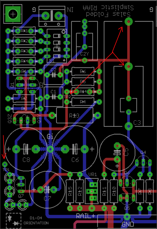

No voltage between TP1 TP2 means TP2 to GND = VLEDS to GND. You had 6.5V TP2 to GND so ~LEDS, correct. All it takes is to engage VR2x. 4.5V TP1 TP2 means you shifted the centering to liking, OK. (TP2 extends to C3 input lead bcs there is essentially no DC drop over R14).

Measures good +/-1.5dB including little but controlled and tame top HF octave rise. Boosts the power range 100-500Hz a bit. Certainly a touch of "voicing" there like Denon does. Listened to classical today, open and smooth, has perspective and information, no grain, fast, very good. The HF is particularly resolving, though not edgy. Traces like a champ. Seems like I will be staying at 145 Ohm load as I find it better focused in my TT and system like that. (220R//430R)//47K 2nd and 3rd position ON at the DIP switch.
