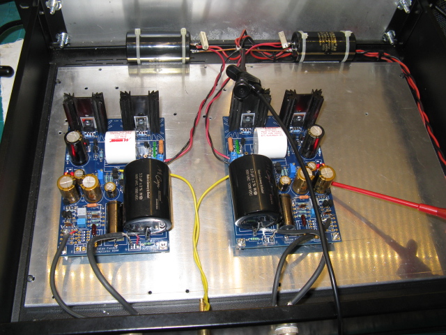

OK, after a hard days work finished everything, put in a box and adjusted it as per the guide. I used 2 2sk369 in front.
I matched and measured everything at the best of my abilities, even curve traced all the semis.
Also as many of you remember I was using the first prototype of the folded cascode, and put it in the same box with the same PS.
I didn' t expect much difference, but was pleasantly surprised. Almost every aspect of the sound was better. More defined bass, soundstage that was expanded in all directions and even more resolution. Noise was lower also.
Very happy! Thanks Salas!

I will build a second after I have fully tested and adjusted the Jfet riaa pre-pre's , at present adjusting the first one and all looking good (obviously one at a time)

Very nice George. This one not only has more gain but also few better passives, thorough matches, not to forget the integrated regs sans cabling, economical double layer layout, multiple star grounds and guards benefits. You are the second early builder stating its a sure step above a previous p2p folded own build. Chuffed to know that all the painstaking attention to the board design details, the slight reg tunings, and general planning payed in the end not to my judgement only. Enjoy your build. Thanks once again for your help during the initial folded evaluations by lending your time and system for the conceptual p2p test we did almost a year ago.
Sounds like a plan. Is Starfish the Naim derived(?) stuff you guys do on pink fish media by the way?

Very nice indeed.
Please let us know what where your cap choices and particularly the output cap.... Most important info for some of us

Lovely build there George. Is it a good idea to have those large caps from umbilical cord to feed the regulator?.

Output cap is Mundorf silver oil 3,3 uF. Interstage texas teflon .047uf.

Well, the idea is to have the caps near the regulator in order to form a small RC with the umbilical. In the PS box I have 15R after the diode bridge, 4700uf, 10h 200mA choke, Rcore transformers, all dual mono.
