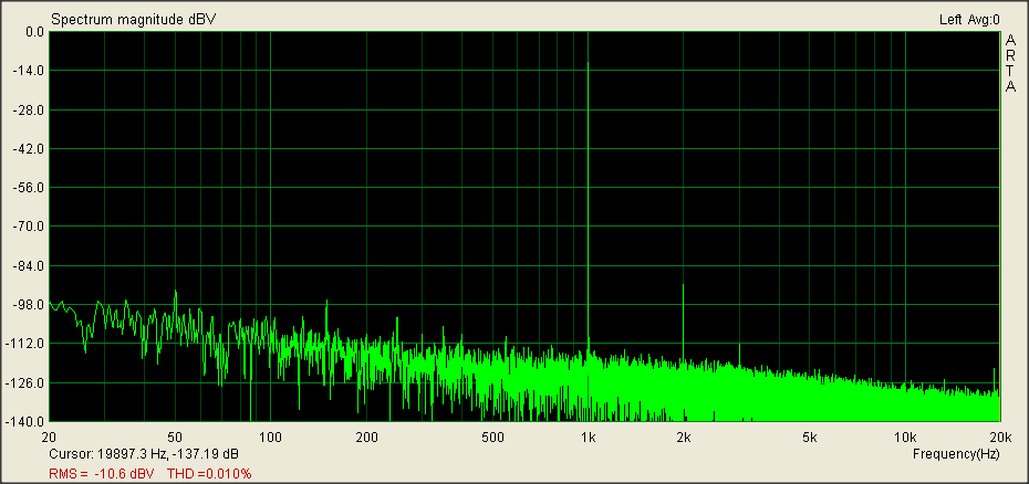

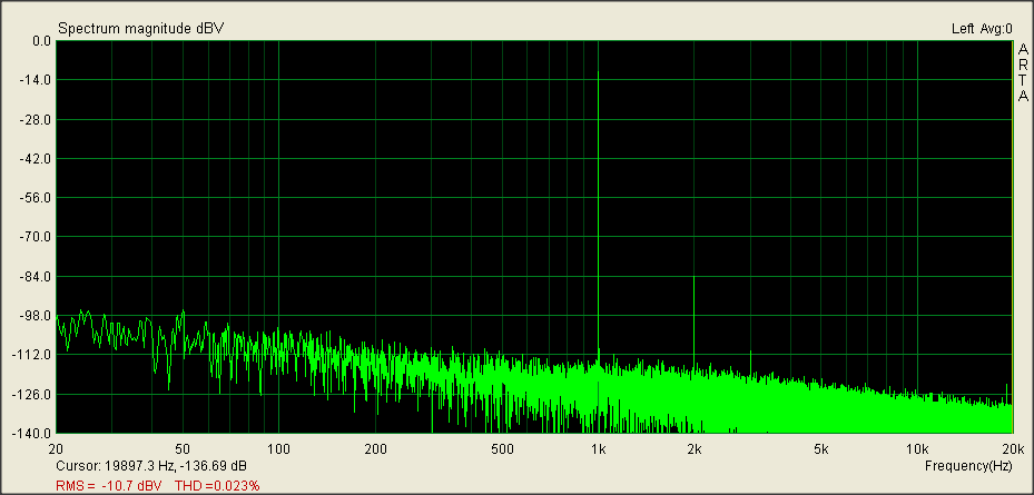

Very true. Talking about that. The riaa compensation network, R14, R5/6, C1, C2, C3. I know little about those things but now I have been messing around in some riaas lately and finds both values and even concepts differ quite largely. Nothing strange about that. People have different philosophys in speaker filter construction to. Can you tell us a little about yours?
Ps. I know you worked it out mostly in the Itch. They hardly differ. What took you there?
diyAudio Chief Moderator
Joined 2002
The jfet one was before the itch. Its a juggling act between loading the input stage light enough without adding non necessary noise beyond that, shaping synergistically to the THD profile not forgetting Miller. In open loop everything is just so, no brute force to pin things down where you would just like to.
Joined 2011
Interesting. THD-profile, does that mean you work towards the least distortion in the network? Is that some standardised thing in riaa-filters? Design is usually a compromise. Is it about finding a filter for most PUs or has the curve anything to do with finding a match in PUs? I digged most in old tube riaas.
Joined 2002
Its esoteric in the voicing, not in filters theory. In open loop you won't beat the THD down to nothing, so you better subtly shape the EQ helping the overall tone. Expect something like this attached chart 1 for the average 63dB FSP build at nominal input level for instance. 6dB (0.01%) better is possible through stronger sweet spot cancellation and I get it even channel matched but only trough curve matching in jfets and R8 trimming. But not that audible as the trend remains the same and the cart has more THD anyway.
