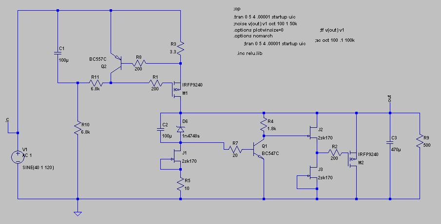

This one simulated nicely. I need to look at it more closely to check that the simulation isn't BS, and I'll probably build a prototype for comparison, if sanity checks hold.

We'll see if it works in reality :D but it sure looks promising.
The other thing I was playing with, but didn't get far, was meant to replace the 20 something V zener with some other reference. The higher voltage zeners are, apparently, more noisy than the lower voltage ones. Something based on the lm369 or some other low noise buried zener reference. We'd probably end up with a super nice solution. Not that we need anything better than what we've got already, but hey, what the hey. :)

Remember to match J2, J3 when prototyping. Also the Zener is well bypassed and CCSed so its self noise is pushed down in practice. Don't make it more elaborate there IMO. What we did by now is to idealize the npn driver bjt which bares logic.

By the time I saw your reply I already built it. I didn't pay attention this time to matching j2 j3, just wanted to put something together quickly.

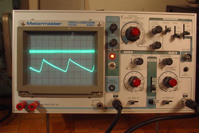

Attached is a trace. The bottom trace is the input to the regulator, a 100 mV p-p voltage, the top one is the regulator output, shown on 5mV/div on the scope, the tightest so far I got from any version regulator I tried. Don't know how it sounds.
I've replaced Q1 with a 2n6387 (darlington :eek: ) because q1 was getting hot and I didn't want to search around too much.
I'm sure this circuit can be done even better than my aerial construction and probably the results will be even better.

The card is good to get. To tell you the truth I haven't measured any 100Hz ripple spike on FFT with simpler shunt versions on the phono output as well, always buried in the grass, but the buffer to the V MOSFET can not hurt. Where is your measuring point? At dummy load or on phono's B+ including cable? How much current on load if with dummy? The key is the sound. To really hear something better. Try with headphones, you may discern and tell us. Only let it run enough before critical listening (2 days powering), I know that it smooths out in a day or two when from new, by experience. To preserve lower impedance gains, the output cap must be very low ESR (bypass with 0.1uF film), and the twisted cabling to phono B+ point and GND point, speaker grade thick. Congratulations for your results! Refreshing.;)

Meaured at the dummy load. I didn't check the current at the load. I've listened to it last night on the headphones. Subjectively only, I can say that it sounds "alive", very fresh. But this was a quickly put together prototype, without care on the layout and parts; probably can be improve with some care.
A film cap with low ESR? Be careful there, I haven't yet measured a film cap with low ESR. I just didn't put any film caps on the output.
And yes, it's nice to see the regulator so stable. :)
