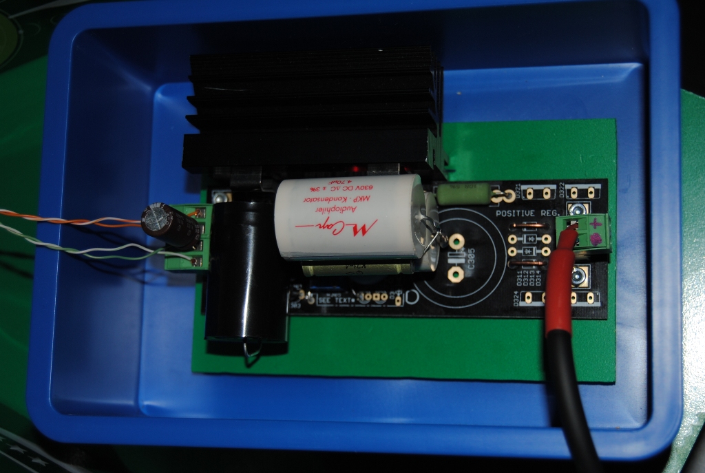

I removed C103 (47u EL) and placed 1 ohm on R107 and a 4,7u MKP as C104.
With 10k dummy load, I could not reach more than 31v even with the trimmer fully turned. Touching the dummy load made the DMM jump. Placing a 330uCap over the dummy restored normality so I thought that it would work with the folded that has two big caps on the power line... but no, I could not get it to go higher than 28v....
This touch thing made me oscilation suspicious so I placed a smaller EL (47u) on the output of the shunt across the sense lines and bingo... everything came into place.

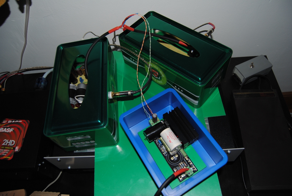

Some pics

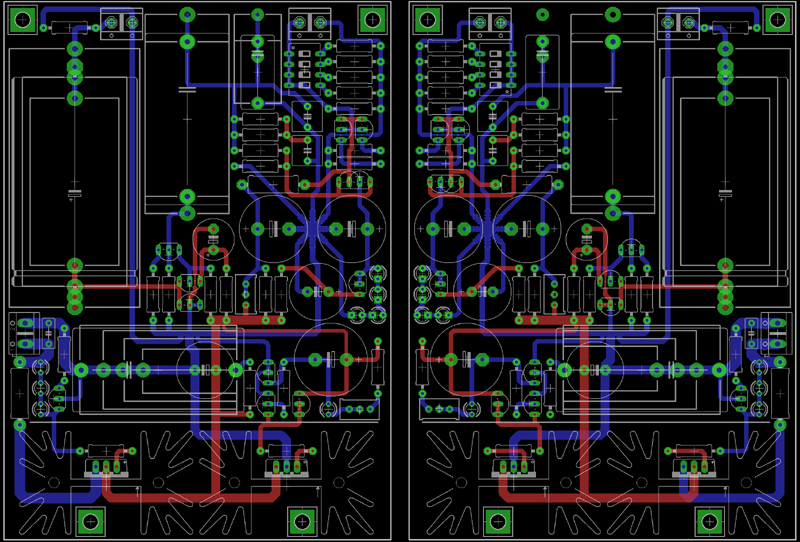

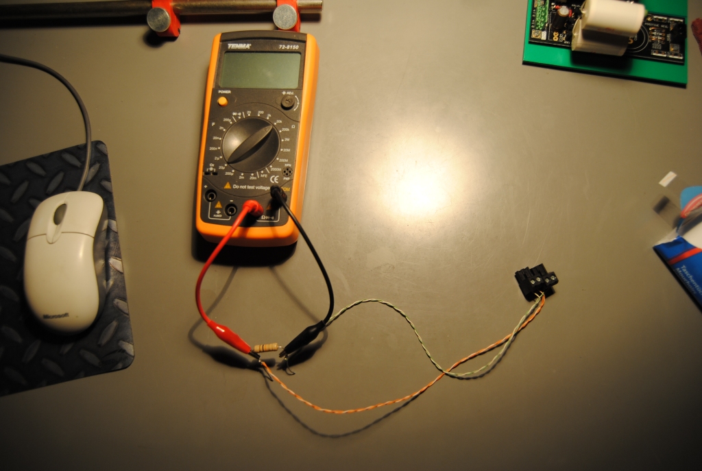

There is a Y split of different extra cable for dividing the PSU feed in middle pic. Is their ground distance symmetric, is it twisted inside? I will keep the double monos smack on in the pcb version. The proto needs details still but I think the layout is mostly OK by now.
Looks very good Salas!
Maybe you already seen that, but I would put one more hole for the trimmers, a la BIB, in order to accommodate the various pinouts. I like the switchable
input resistors and the tight layout.
Also nice that inputs and outputs are on the back of the board, so to be close on the connectors on the back of the chassis.
