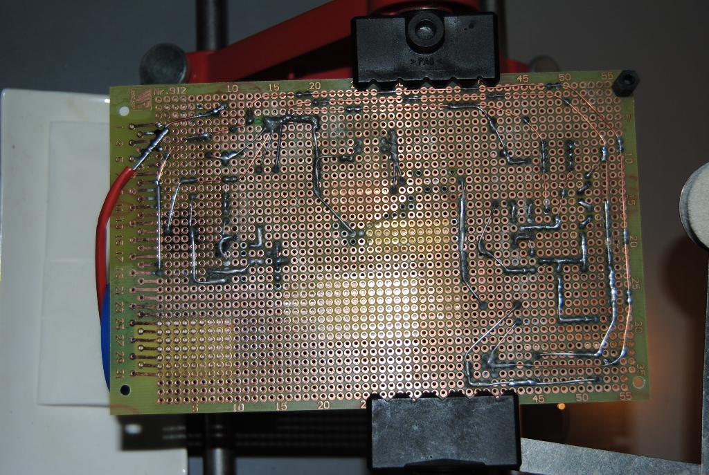

Speaking of relcaps.... It took me a while but I finally got things right in the "Wallis experiment".

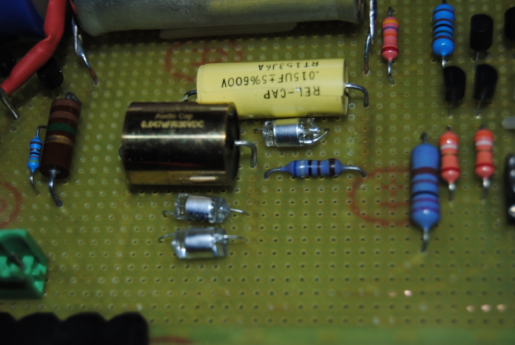

Folded cascode input and jfet CCS in the output buffer makes the simplistic sound much more "snapy" and detailed so extreme care is needed to get the riaa filter right.
15.18nF was too spiky... 15.19nF was dull... 15.183nF is quite good.... incredible... here am I again stating I can hear pico farad differences.... but I do :)

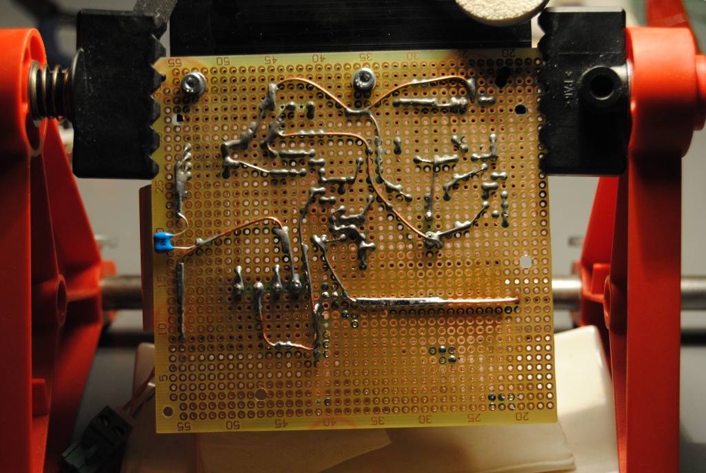

...Not to forget the proverbial spaghetti proto-test photo of course.:D

Ok, as promised here it is my subjective listening impressions report:
The "normal" simplistic provides a wide soundstage with liquid mids and highs beeing very good for complex instrumental pieces. It can produce a credible image from very complex and heavy piano pieces and excells in big orchestral moves with loads of simultaneous violins or human choruses. It is able to produce a coherent fluid picture that I consider very pleasing.
The Wallis experiment (better known as the folded cascode simplistic) has the familiar simplistic presentation but has more attack and detail in the bass. Single acoustic guitar becomes more agile and spiky. As a result, there seems to be a more analytical presentation... some hidden notes and sounds are more easily detected.
My folded cascode build is lower noise than the "normal" one but maybe that is due to the use of paralleled jfets in the input.
As I said before, the inherent higher attack and detail of the wallis makes it more sensible to the choice of the 15n cap.... (Hi can hear picos again :))

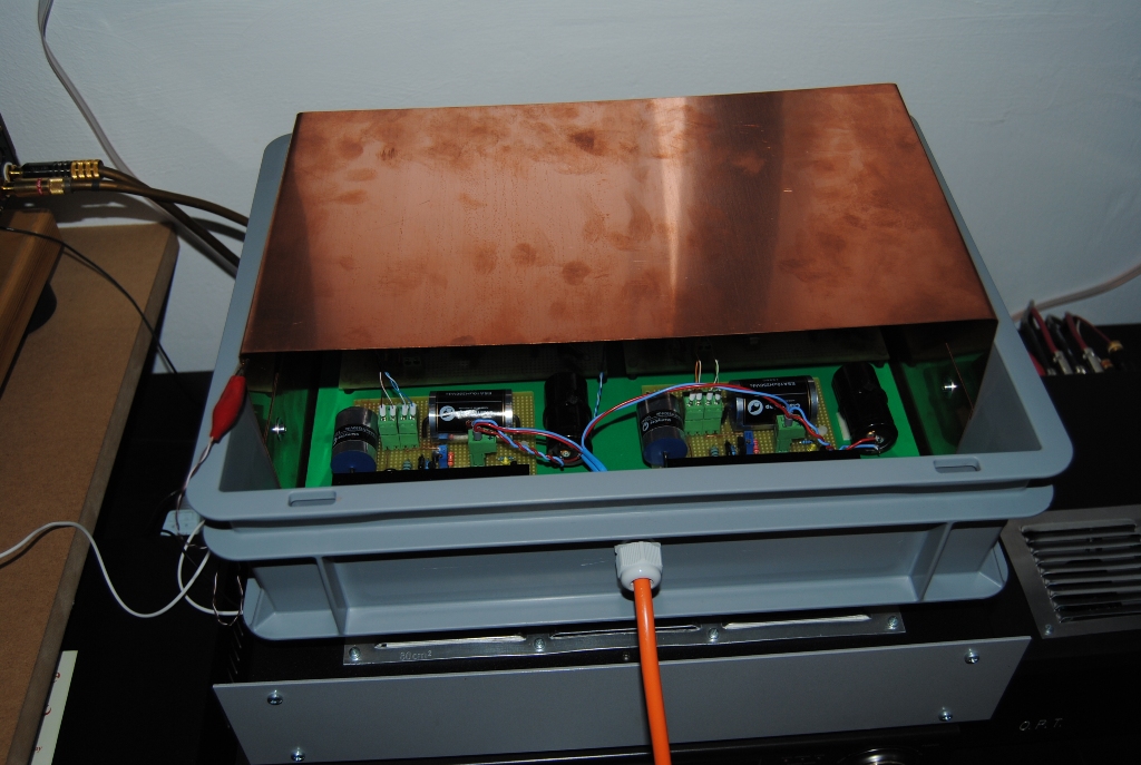

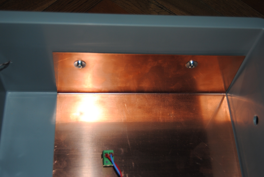

As gain is quite high I neede to build a copper screen that worked wonders (after all I live in switzerland where everybody uses copper in their roofs :) )

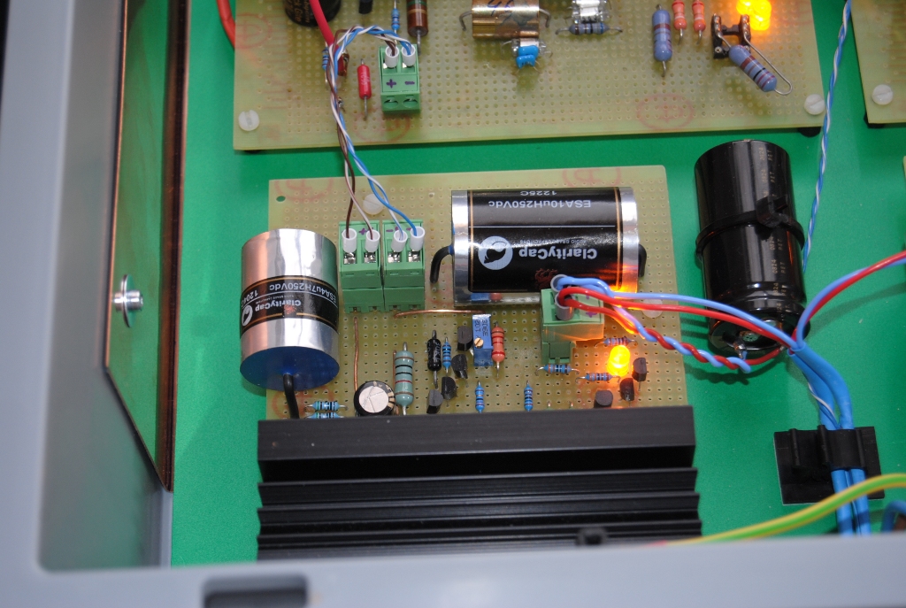

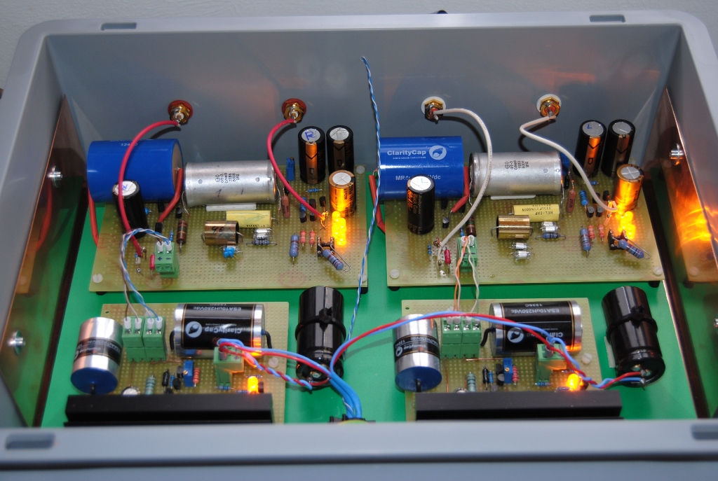

Some pictures of the spaghetti:

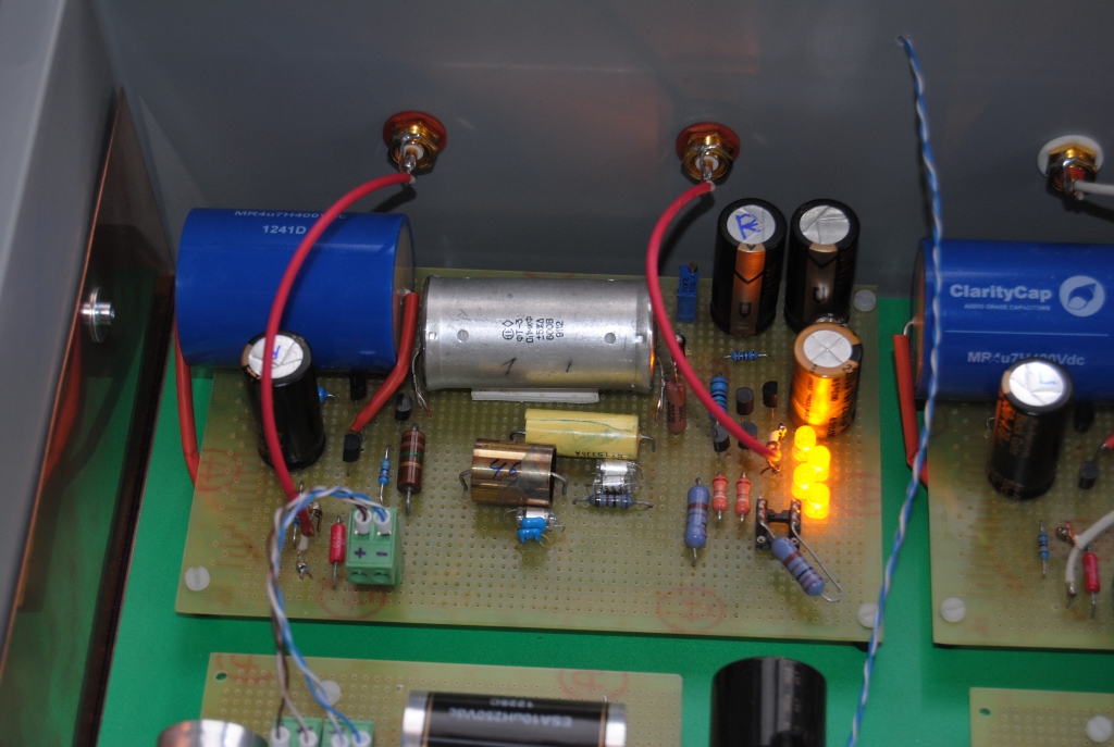

As can be seen here I upgraded output caps to some new low voltage MR´s... (shortage of t$me).... The big MR´s I used for the "normal" simplistic are much much better.
The ESA caps on the shunts are slightly better the the usual MKP´s... maybe in the future I will save some t$me for obbligato gold (principaly the 10u... these really make a difference)
Now time for some more spaghetti:

Nice shots. Having less noise than in a 48dB build normal, with a near 60dB one, no mean feat. Paralleling is just 3dB better SNR at same gain, the rest is design & execution. Copper shielding and reference to ground for 1st stage folded should have helped towards that goal. Also your total build execution is expert in those photos. Using K369s than K170s and same class caps as in the other maybe could reveal a bit more performance, but as it is its more than enough to prove that the concept works indeed. There will be proponents of the normal or folded regarding system synergy nonetheless. The normal is more configuration flexible OTOH. Like changing sensitivity easily or for combining pre pre stage. More focus and detail across the audio band can make the folded more finicky for parts, values, synergy I guess. I would consider the folded as the ''expert'' fixed build path. Is that a valid approach in your opinion RC?

Yes... definitely more finicky for parts, specially the riaa filter, it took me a while to get it working properly (but as always, hard work pays).
I also forgot to mention, it takes a while to reach propper working voltages after turn on, due to the special folded cascode biasing.
