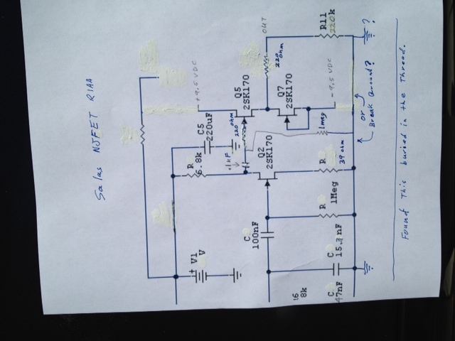

If a small valve cap (.022 to .1 uF) could be at the output of second stage and a DCB1 as the output from the available Hypnotize supply, I would be dollars ahead. I am looking for a cheaper solution that sounds the best.
Rush
Try the trick I suggested then. If you can make the output cap a small cap between 2nd stage and buffer with an adjustable minus supply and DCB1 like buffer then you will be able to spend much much less. Try it conceptually with a regular cap first. And you can optimize the uF value too, before spending.
Or stopping to second stage and coupling to a dedicated 1meg hypno audio part with a small cap as you say.
I found a drawing buried in this thread that showed a B1 cap coupled out, so I modified it.
See if this would work.
Question is where to break the ground as the supply for the B1 will also be used for my crossover or it could be from my Mesmerize which ever you think best. Now that I am thinking about it the Mesmerize is closer to the phono and may provide less chance of grounding issue.
Thanks Salas, maybe others will appreciate this exercise as well.
Rush
Yes, that picture shows a riaa completed single supply system handing over to symmetric PSU buffer through AC coupling. It should work. You got many things in one box and me to predict best grounding is impossible, you should just try it and see if it will do best to locally break and star away or not.
