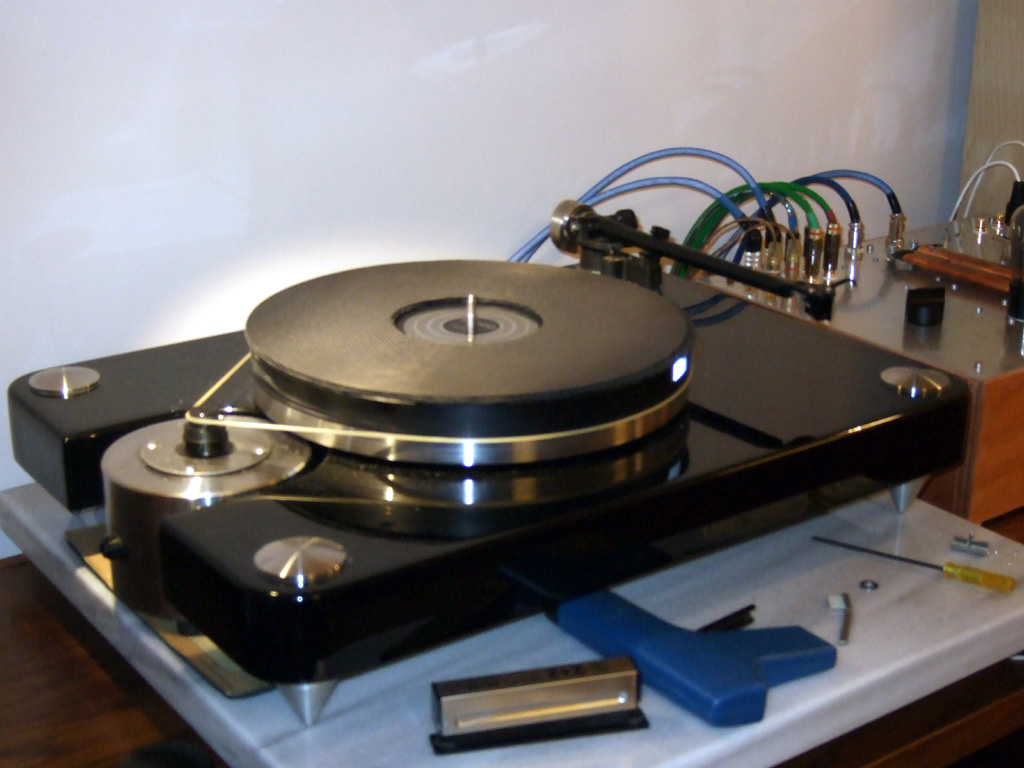

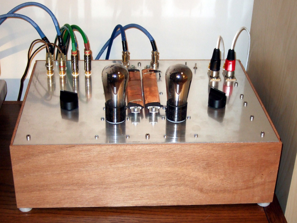

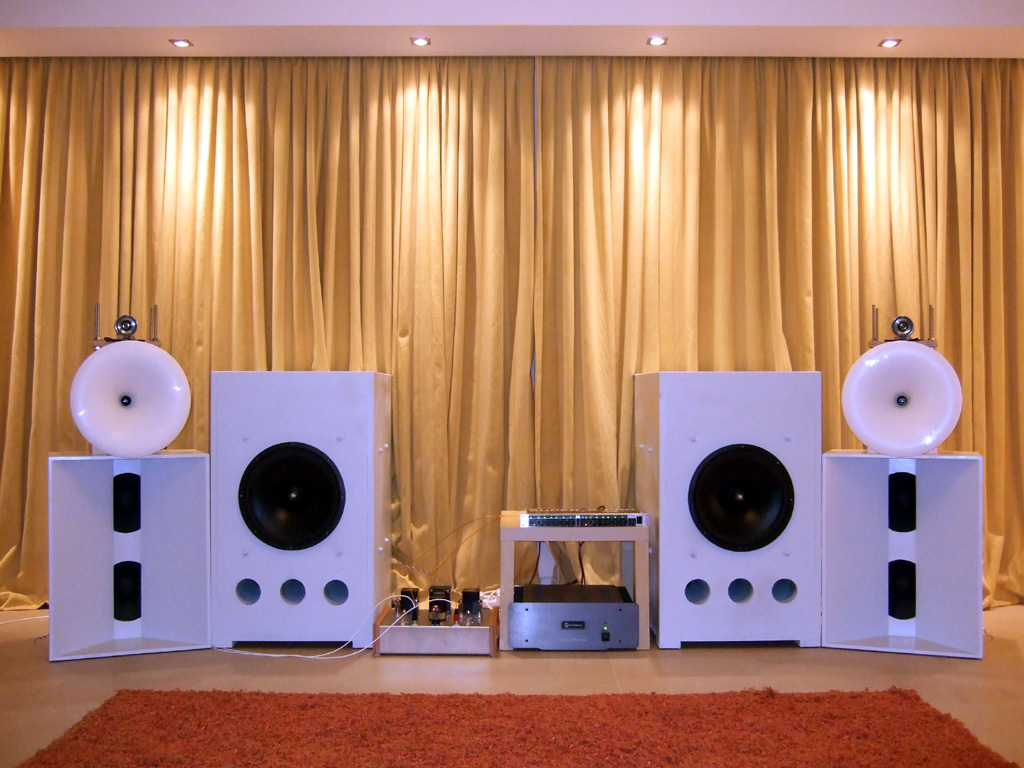

I visited Vgeorge's house on Poros island given an opportunity he was in Athens and returning, so to listen to his DIY system and to contribute a bit of opinion and tune up. He uses the Simplistic Riaa fed from a Shelter 901 on a VPI, then a #26 with double SSHV2, autoformer pot, transformer XLR outputs, or DCB1 alternatively, to a 4 way dual amplified 100dB sens speaker system. A Baby Huey EL84 push pull drives 2 in series 12'' midbasses, Altec (Great Plains) driver on Le Cleac'h wide band horn (Azurahorn) and a Fostex bullet TW, all those with passive cross and no low cut, when an active analogue crossover handles the 280lt Lambda 15'' subs powered by a McCormack DNA amp.
I had designed the passive crossover originally with measurements he had sent, and I had promised I would witness the system and help fine tune some day. It became a late day, but better late than never they say.
We fixed his mic and mic pre for better SNR and re-calibrated the wave launch centres between horn and bullet, tuned the sub cut off also.
Listening to vinyl and the phono in such a system was tour de force I tell ya. Grand scale golden tone with presence and power to die for. Well done George. Kean, we used Tijuana Brass also from Casino Royal. Herb Alpert's blasts and female vocals later (Dusty Springfield) on a serious horn system are greatly benefited when the dynamics press. Not losing steam, never harsh. Just there in the room persuasive.

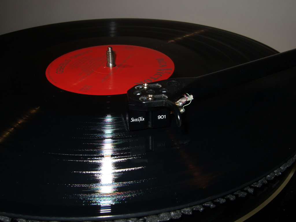

Would the static be electric or groove wear? Probably both and dust but can static cause pops on a record?
Static is charge. Old records bought from bargain bins could have been ''plowed'' with distorted diamond tips on VTF in the excess of 5g even, and/or accumulating any form of dust and organic particles for 40 years+.
Here some tortured or dirty grooves examined.

Another question regarding flicker noise. Any problems here? I had my problems with this issue using some WE 205D (Shugang clones) as preamplifier tubes...
No, I do not have any problems. Salas also listened to my system, and did not hear anything unusual.
Keep in mind I use a LL1660 4.5:1 at the output, which I think is essential to keep output impedance low enough.
I had some noisy tubes, but that is to be expected as most of them are used.

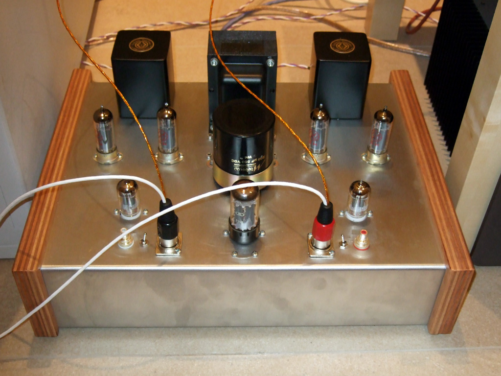

Here a recent picture of the internals of the riaa.
PS is on a separate box with double R-core transformers and C L filter.
George congrats nice system, if you want send me a pm with your address so I will send you a couple of FT-3 0,1uF for your interestage coupling capacitors, I see you have mixed Kiwame with Shinkoh & Takman is for the sound in the position used? what mains filter cap are you using? in the separate psu box are you using also 10.000uF, wich value are you using for L?
Thank you for your offer Felipe, I already have some FT-3 capacitors.
Here I use K72P-6 0.047uF for interstage, which replaced the FT-3 I had before. They are covered with a grounded cooper foil.
Regarding resistros, I use kiwame in the power supply and shinkoh in the signal route. Takman 1M resistors.
Last filter caps are 2 x 22000uf mundorf.
In the PS box I use 2 x 4700uf and 2 x 10h choke.
Coupling cap is 3,3uf silver foil mundorf.
