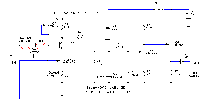

I have gone through mouser to find some suitable components. I basically chose from Vishay Metal Foils and Kamaya carbon composition (both where available), vishay polypropylene for RIAA and Cornell Dubilier polypropylene for output.
It is not meant as a fancy all-out build, but rather a decent one to give me an insight on how the circuit sounds and behaves.
Could you please have a look at my list in case you have any suggestions? thanks

I have those
CMF5547K000FHEK
For the CMF55,
There are now more .1% and 25ppm ones available in the states, and I would recommend them for the cost, about .47usd, if you can get them in those values. A good price for a resistor with a tight tolerance and low tempco.

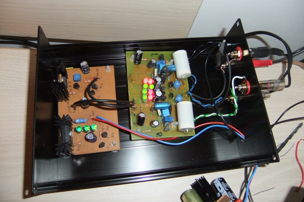

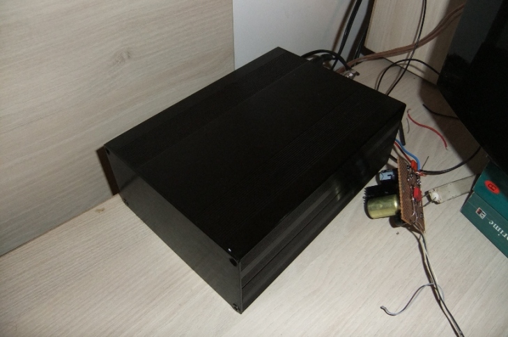

My preamp is in getting some new aluminium cloths
I'm waiting for a toroidal transformer also a very nice power switch/button to be installed in the front of the case.
Despite buying some Mundorf Mcap 0,1 for interstage coupling i didnt liked so i used some NOS ERO Mkp1845 0.047uf wich sounded more balanced. Also i changed the 15nf capacitors in RIAA to NOS Ero kp1830 (MKP1837).
I will change also the resistors in RIAA network with some more precisee ones as i'm preparing a bigger order to Farnell next week.
By the way wich resistors to order to Farnell, carbon film, metal film ?
