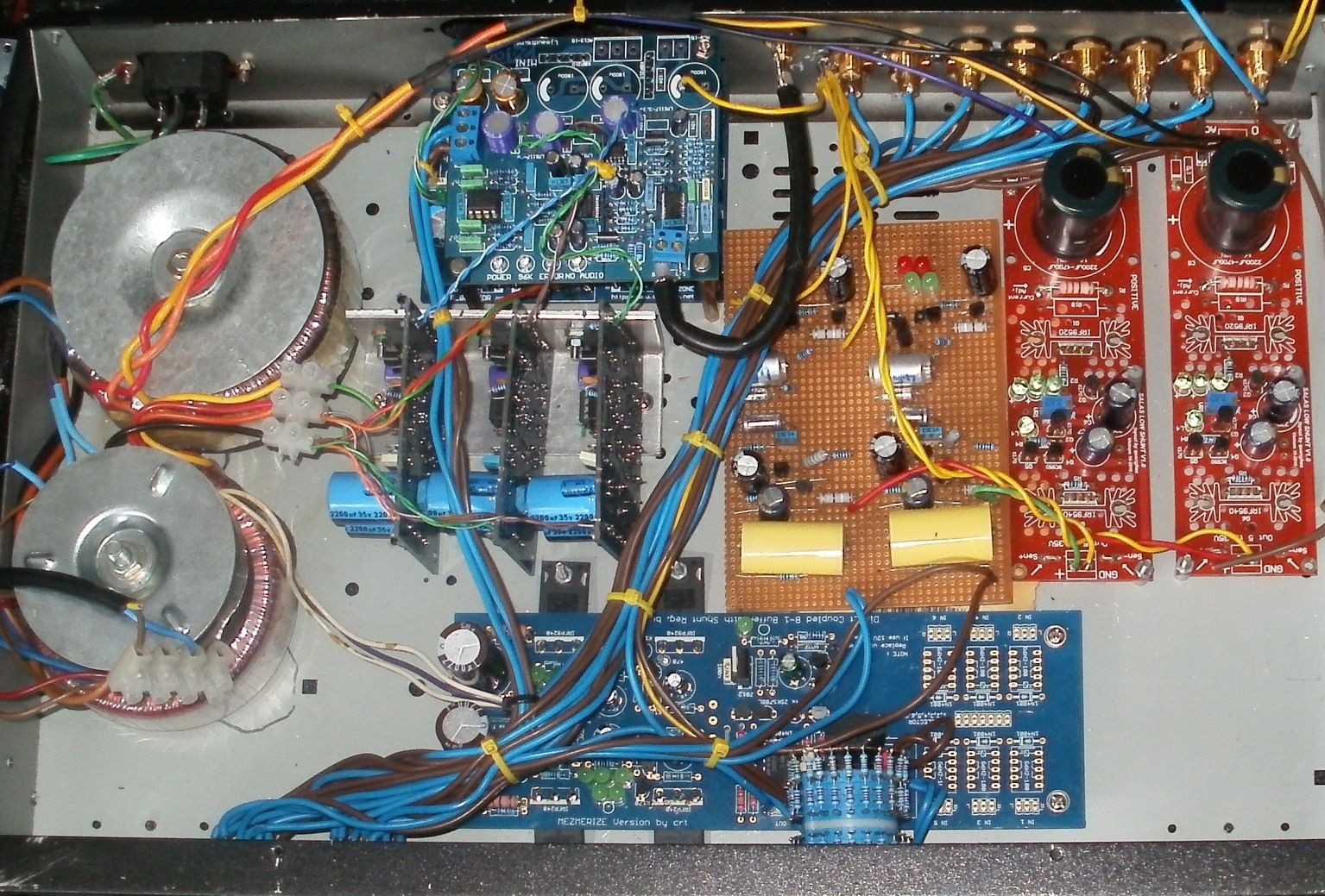

I've built the second (Left) channel. Measurements are:
Left Right
LEDs 7.11 7.07
Gate on Inputs 6.47 6.44
Gate on Q2 9.25 9.80
Gate on Q5 20.1 20.6
Perhaps I need to change one of my input Jfets on the left channel for slightly lower/higher idss?
Hum is reasonbly bad on the left channel and very bad on the right, with no input wires even connected.
I haven't mesured the gain yet, I will do that when I have sorted my hum problems. The shunt regs have been adjusted to give excatly 45V after 10 minutes. I'm only running the shunts with 33R R1 at the minute so they maybe aren't as quiet as they can be, but should still be quiet enough.
The phono stage is next to the shunts, I've tried moving the board around when powered to listen if the hum changes, it doesn't, so it doesn't appear to be interference.
Here is a picture, all of the high-level signal and power supply ground wires go back to a star point on the back panel. When I connect the signal wires the grounds will come straight to the phono board.
PS there is insulation under the phono board to insulate it from the case :)

Please tell me drain to ground voltages, not gate, and I will reply if OK.
You did a lot of work, but unfortunately a 60dB gain unshielded phono can not afford two toroidal transformers in the same box for hum. The solution will be its own box, just phono. DC only will come in, and all signal cabling will be shielded. Trafo and raw dc rectification, main capacitors, in a psu box, away, connecting with a umbilical.
Sorry Salas, they are definitely drain voltages, not gate.
There are actually three in the case, a 30VA, a 60Va and a ~100VA (this is for the phono)
I was fearing you'd say that, I would like to keep it in one box if at all possible (and left the possibility of adding shielding in the case if it were needed). I have a few things I will try (I think the 30VA toroid for the DC-B1 is the noisiest, I could have everything but the phono regs powered from the 60VA toroid)
What tweaks do I need to make to optimise the voltages please?
diyAudio Chief Moderator
Joined 2002

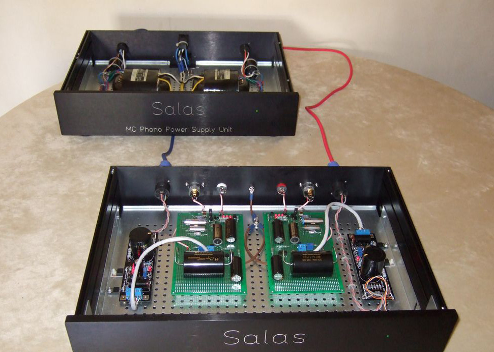

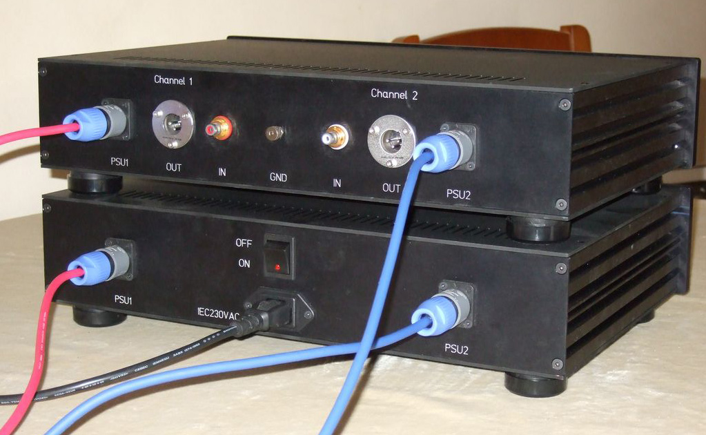

Your drain voltages are very good. You will only need to change something if your levels between channel outputs will have gross differences. By using a trimmer instead of R6 you can match q2 drains dc or tweak gain and thd since its changing local degeneration. As for having no hum and keeping the thing in there, I am sorry, many tried before but no cigar. It would only live well with Rcore and every AC cable tacked away to the other corner in a fairly wide box. Still not as good as a two box build as in the pics attached, for no AC wiring entering. Many examples here before even with with FFT showing harmonic noise with different box and arrangement steps etc. In your shoes, I would get a small extra box, put the phono boards inside it ONLY, and run the 4 wire reg outputs to it from your now box. Thankfully the regs can save a lot of loss with 4 wire config when away from their client boards. Looks like the cheapest and lowest box count solution. The box must be connected to 0 PSU, and audio signal cabling be shielded coax. Nice up to now non the less, congrats.
