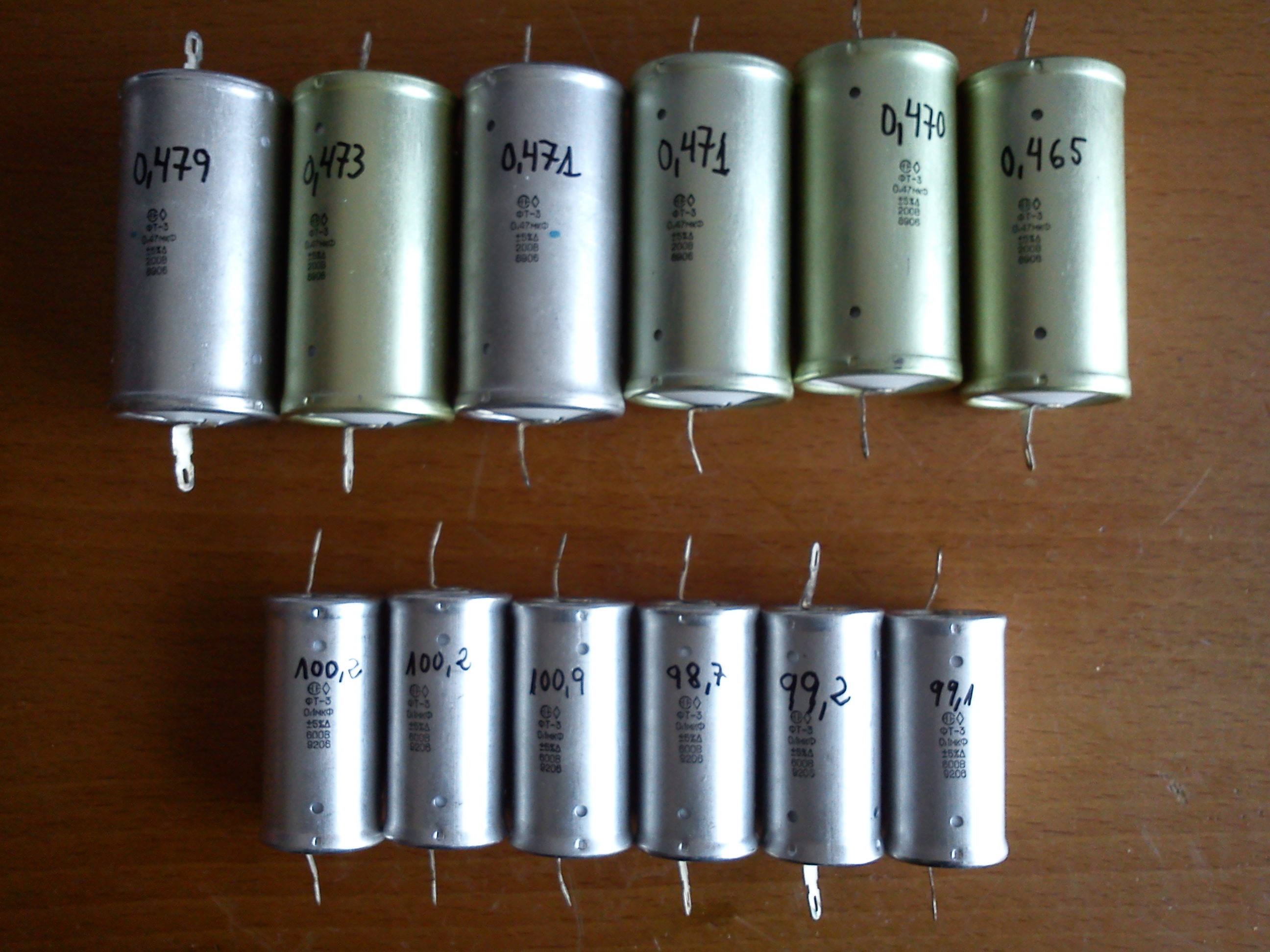

I also found that bypassing the output caps can make a big difference.
I would not bypass expensive caps like the good Mundorfs or Duellunds but all other MKP deserve this attention.
After long experiments with small valued Auricaps, FT-3, polystirenes and SM I found that the obligatos like small obligatos.
In this case 4u7 // .047u did the magic.
In the shunts, the low cost Audyn is bypassed by a small 10pF SM. This opens up the sound producing much more explicit highs and tighter well defined lows.
These Audyns are very close to the Mundorfs MKP and respond as well to the bypassing act.
Joined 2006
Now I'm testing with 15.33nF RIAA cap, first impressions is the sound is more equilibrated over all audible bandwith.
What cap are you using ?
I found that a full SM combination brings more detail and snap but needs adjustments to get the high bass up a notch.
Using Tin Foil polystyrenes produces a bigger fuller, nicer presence but somehow lacks the high freq bite.

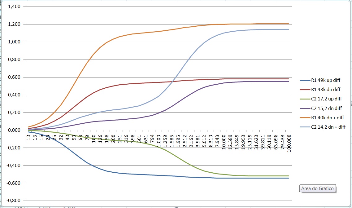

As I wanted to understand the effect of reducing the 15.72nF to 15.33nF and also the effect of fiddling with the 47kr resistor. I made the following simulations.
It looks like such a simulation cannot be fully accurate, since, at least, it doesn't take into account stray capacitance in the circuit. Which is one more reason for listening tests being indispensable.
Joined 2006
This is not intended to be accurate.
It represents the possible deviations (errors) from perfect riaa setup.
I compared the results against proven Salas setup.
In this case (48dB) C2 is 15.33nF and R1 is 47kr.
I just wanted to show what error each component might introduce and how.
I am not suggesting anyone should deviate from Salas schematic but I agree that sometimes it is important to tune these components by ear and this graph gives a visual idea of what to expect.
Lowering the 15n cap introduces a rise in responce from 1000Hz onwards.
(A very small change "10pF" can be clearly heard)
Lowering the 47kr produces much dramatic effects in the power band.
