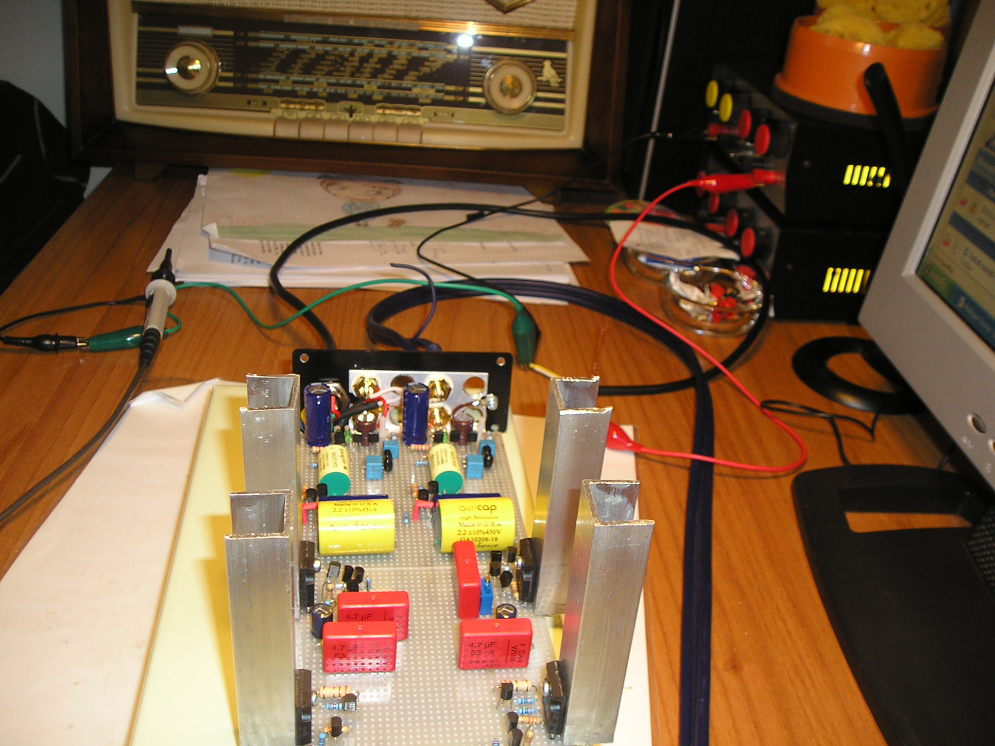

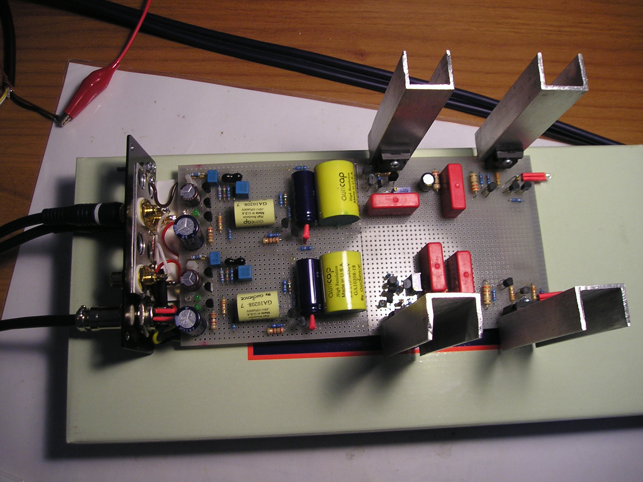

One step before the end. Maybe I have a problem with temperature of second IRFP9240.
Now there is 185 mA for each channel. Can I decrease to 160mA if only change the R1 of PSU from 3.3Ω to 4.7Ω?

What are the dissipations of the two mosFETs during normal operation?
What are the expected Tc & Tj of these mosFETs during normal operation?
What are the dissipations of the mosFETs during worst case fault conditions?
Will the mosFETs survive during fault conditions?
The fact that the second mosFET runs a bit hotter is of virtually no consequence, if you don't know what is happening.
Each phono channel draws around 30mA. If you run at 45V B+ I guess its normal there is considerable dissipation from the shunt Mosfets for those heatsinks in the picture burning the excess. IRFP TO-247s are dogs to say the truth, very reliable, but it will be prudent to lower the CCS a bit to ensure no failures in the long run especially when it will be boxed up.

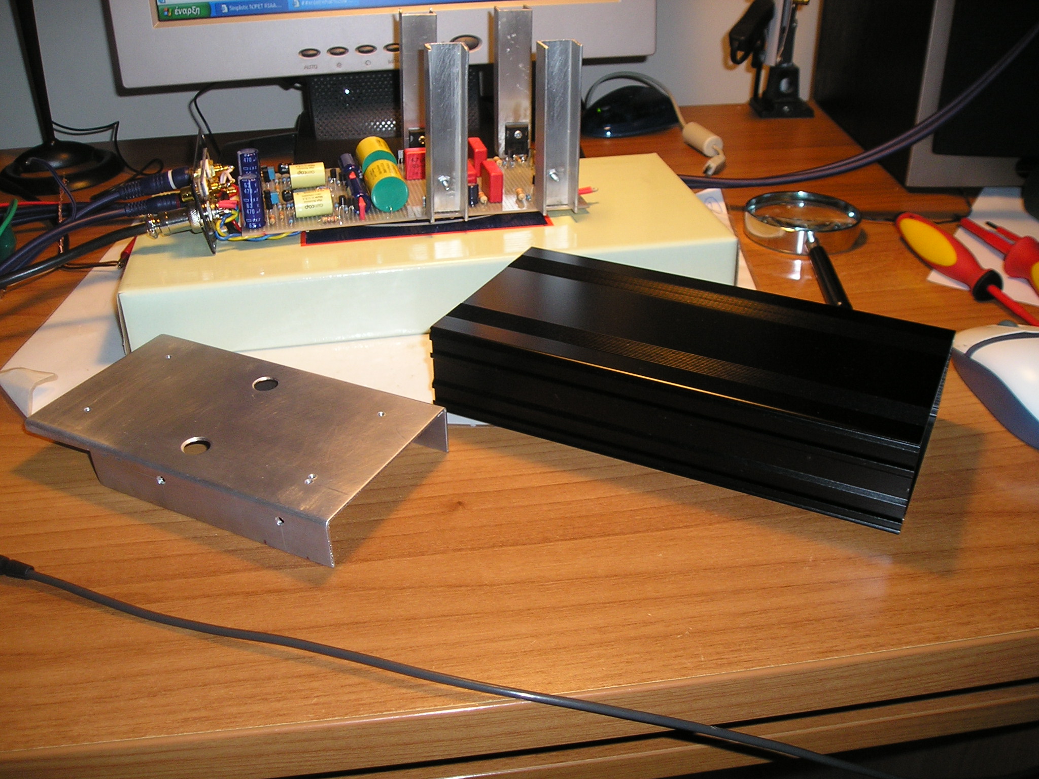

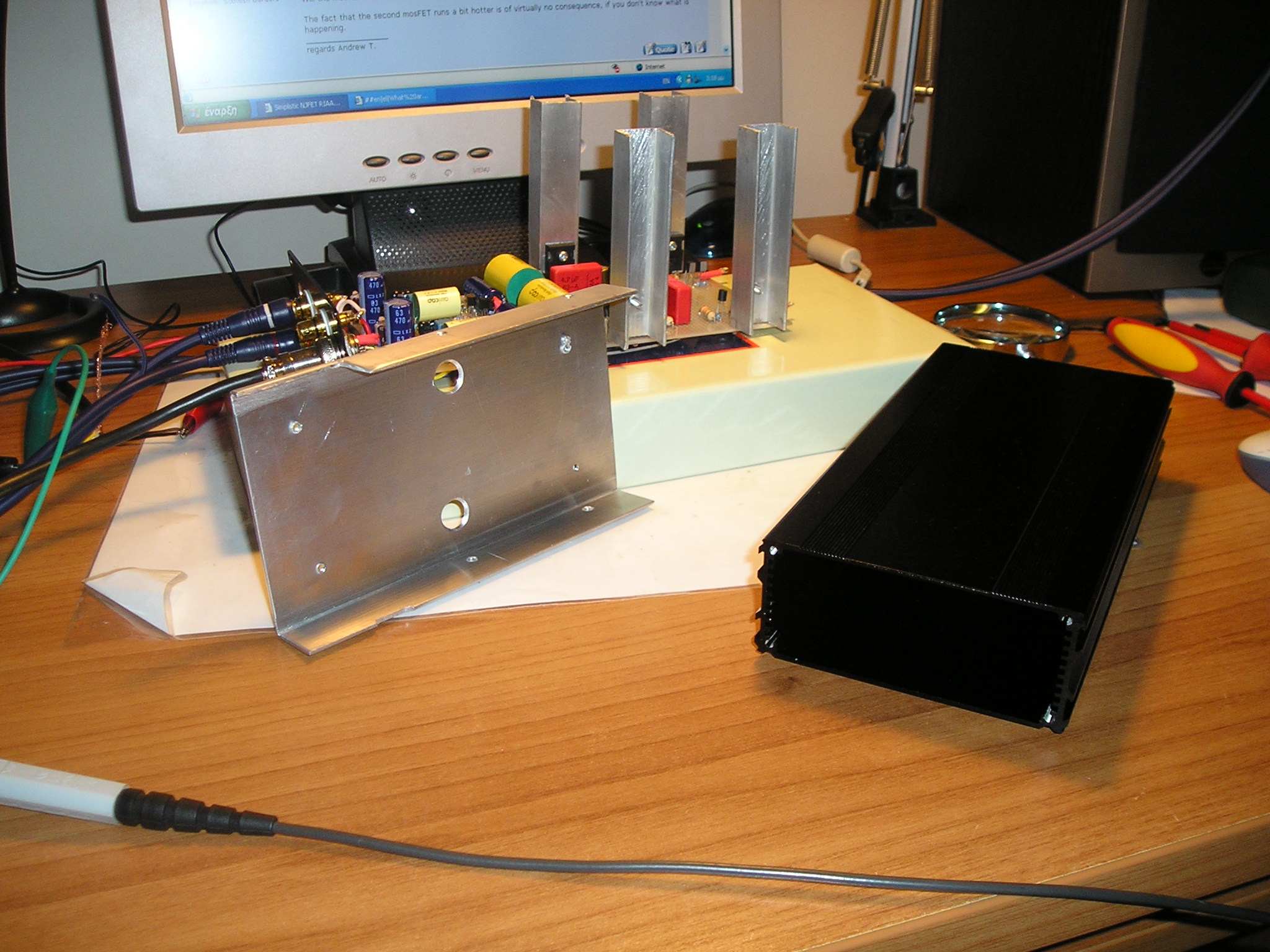

Hi AndrewT.
All are working perfect but I am going to use the heatsink and the case you can see on photos. If there is no insufficient cooling may reduce a little the total current per channel.

Hi AndrewT.
Don't forget to insulate the Mosfets when you will use the case for sinking.
P.S. Auricaps without flying leads? New issue, or suspect?
