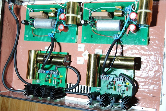

I have been experimenting with decoupling caps in my 48dB riaa and I am amazed by the results.... these caps influence tone (I knew that) but they also influence noise...
After replacing the 330u decoupling caps by 680u BG N, the noise went down to the point where I can no longer hear it..... Is it possible or is there any other reason ?

Look at the red ones on the riaa boards.
The difference is UGE in noise floor.
Can we have an alternative to those decouplers ? Maybe another type of decoupling or RC filter that does not need special caps....:D
Ricardo you you have two possibilities depending what are you looking for:
1-Less noise can reached paralleling two BG N "L-Cancelling Pairs" so + one cap to - other cap, look for at the Michael Percy pdf. web
2-N series are very very low noise so very very transparents, if you like more body I will try BG standard 470uF 160V you will be near near heaven:)
Let me know?
