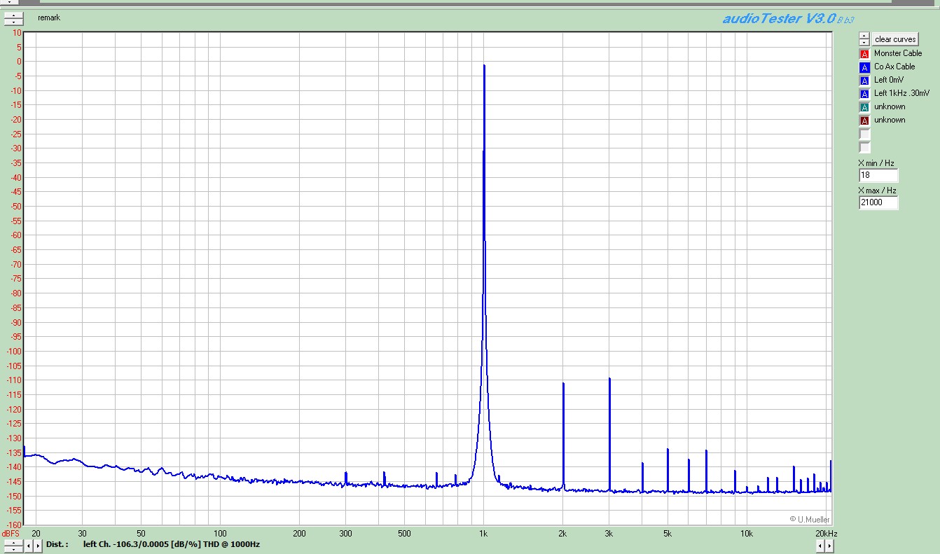

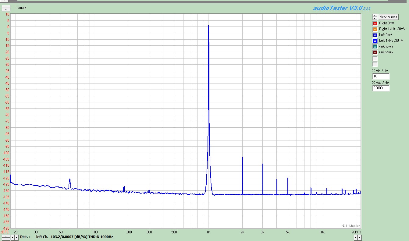

I am getting ready to measure the simplistic finally. Finally sorta figured out the 1616m interface and have been able to obtain some decent direct connect noise spectra. Attached are the before (MAudio) and the present measurement system (EMU1616m). Night and day!!!! Will be interesting tosee what the riaa will look like with all of the issues I have had in the past with ground loops.
Both are calibrated for 1Vrms = 0dB

Looks like a very good price for something with 16 inputs, real bus, not sluggish USB, chunky external box and a RIAA input! No Protools though, but its not the issue here. Nice one. I am sure you will put it in good use. Good tools are the best investment in any hobby.

Wow are more or less between 15-20dBs better noise floor, good tools are expensive like good components, congrats for the new toy, I aml sure you enjoy it & I can learn with your posts.:)
