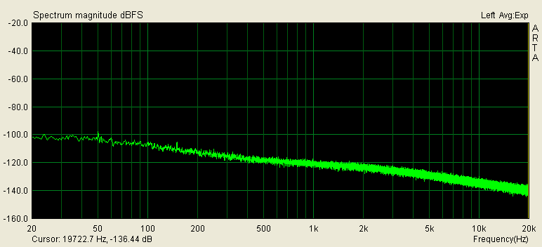

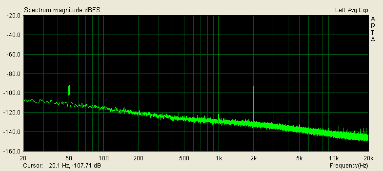

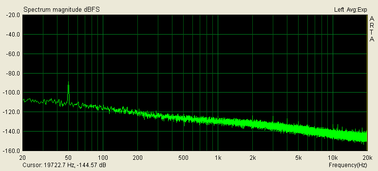

Now lets see how that equivalent circuit to SGregory I built as an upgrade to a friend recently (only with lower IDSS since the PSU was there already and fixed at lower B+ by Tx) goes along on the FFT, so he can compare his graphs.
First graph is open input, nothing attached except than output. Half the output's cable 2m length was twisted crock clips. It has 410R input resistor on board (820//820). Second graph is just the 15R Zo 1 to 200 attenuator cable attached on input. Its other end not attached to the generator's output. The noise floor is lower now. Ooops, 50Hz hum at -90dB and some very little HF hair also. Not possibly an introduced low level gnd loop, the thing isn't closing with something. Its picking it like an antenna. Could catch 6dB more hum if I touched the cable. Third graph is on the gen with 0.5mV input via the attenuator cable. Not bad THD at all for a non loop NFB SE circuit. I have even seen it losing the 50Hz band completely if playing with the cable and the usb card's placing, but I think its standard it will pick up something when connected to a TT cable so I left it there as charactristic hum. Can go worse when on a TT its the norm. So we see that with closed like low Z MC, nearly grounded input its the real low end noise floor, but we will pick up something little inevitably when exposing to the outside of the grounded box. We can close input to ground inside if we want to see it isolated. But a box in box like SG's can possibly also do better.

In my experience no. Its a matter of transmitting sub mV in a real environment over SE connections. They skip that with balanced line measurements in instrumentation. Having just a consumer computer card, and hooking up here and there in the house with cables running around isn't remotely lab grade either, but I am very happy we got that in this modern age. It can basically show what we need to know.
Now stop a little and think of your vinyl dynamic range. Well covered.
