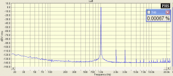

Think we are on to something here. New set-up on dummy load. I can talk, sceam, wave my hand, dance and in general anything I want except start up my tesla coil and I get a stable measurement. No more crazy ground loops either.

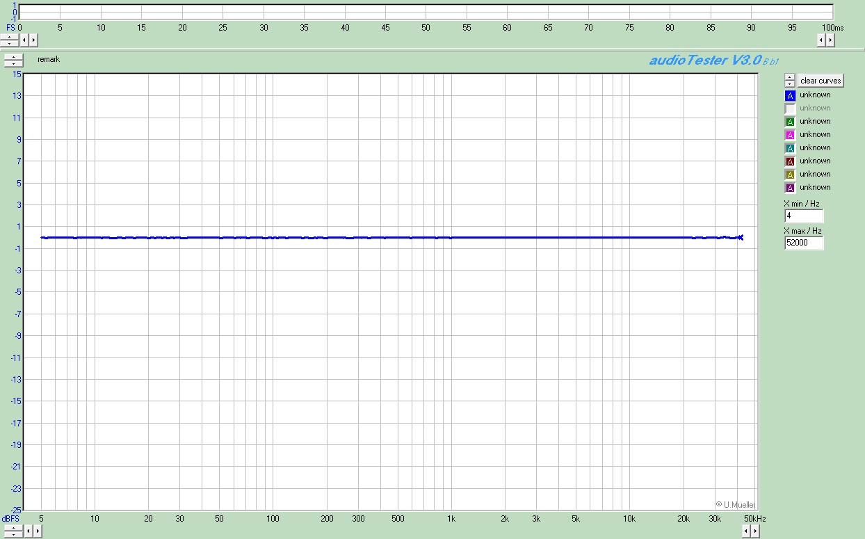

Attached is the corrected response from 5 to 45kHz, and a 1kHz FFT 0dB = 1Vrms input. I have the output of the mAudio card throttled back quite a bit to get 1Vrms so I will build a simple attenuator to regain some digital resolution of the wave.

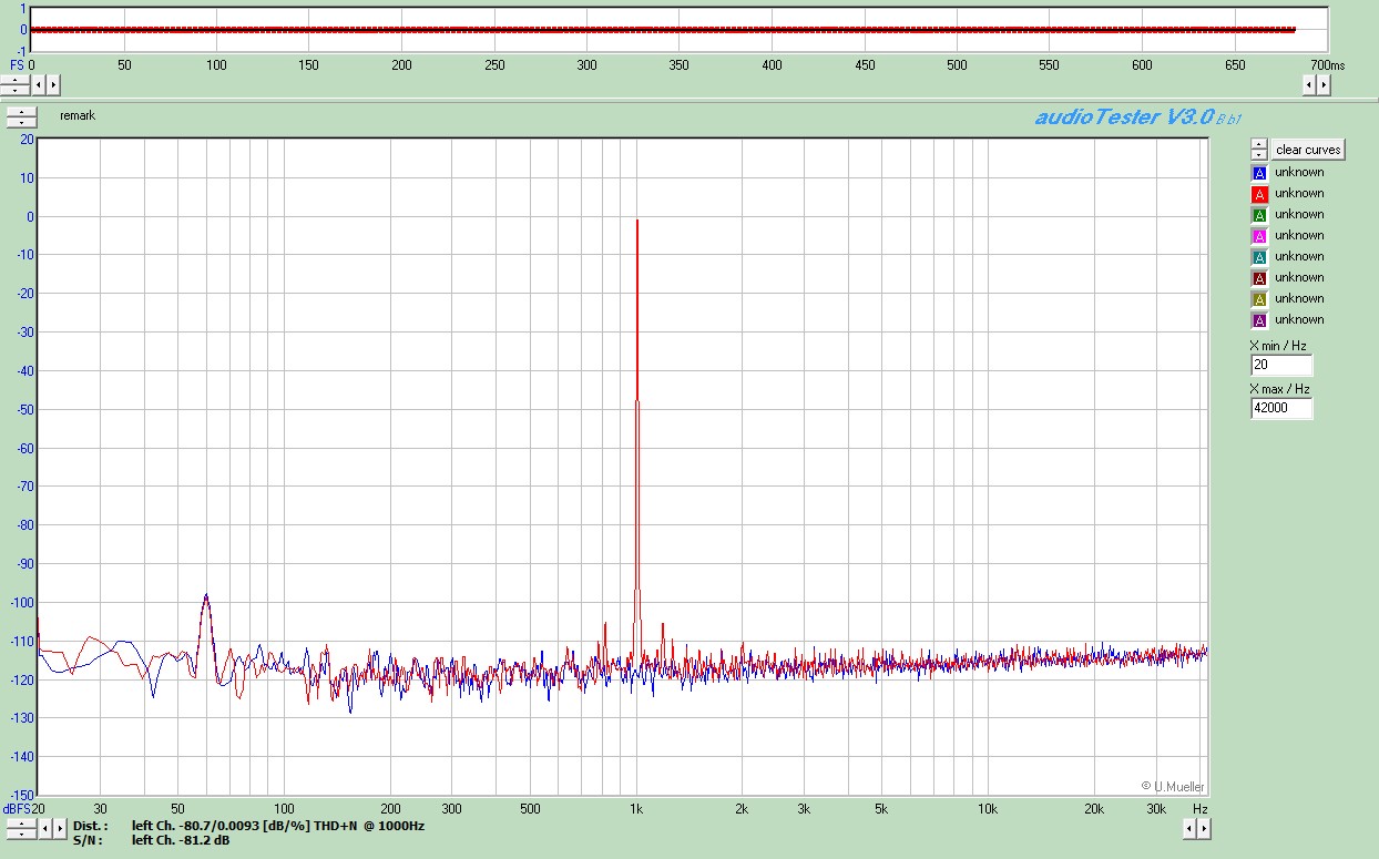

The FFT shows with and without signal applied.

Improvement indeed. I think that you better use it at 48k 24bit. Still not low enough in the highs.

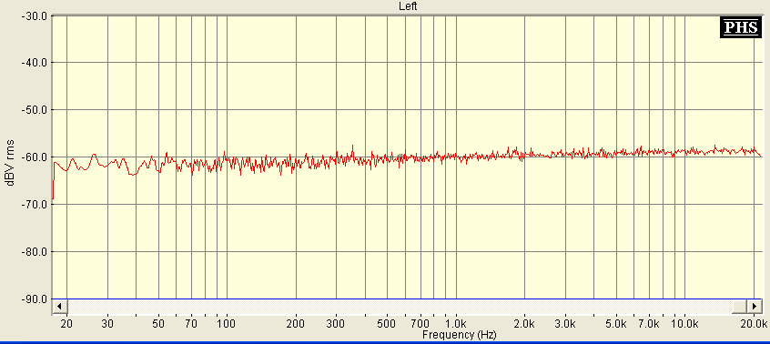

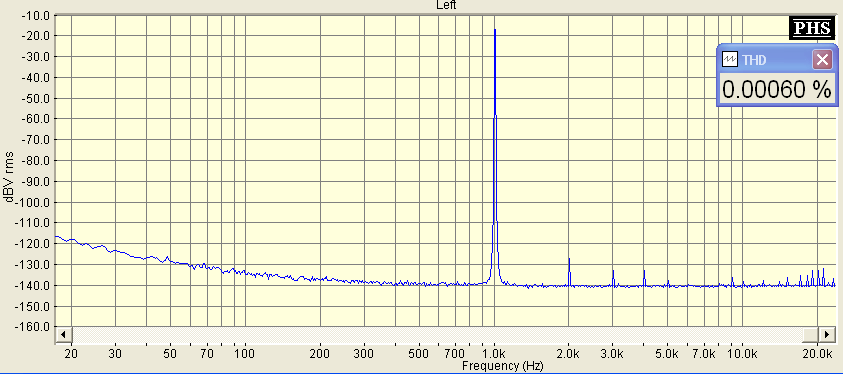

P.S. Just took two loop screens for 1V and 0.1V (ref0dB 1VRMS) for EMU Tracker on USB power from battery laptop. 48k 24bit FFT65536 Blackman both axis Log.
Also here's the guy doing white noise. You can see the lift towards 20kHz, in case you wondered why I don't press it -40dB sharp when I take the Riaa curve. Would be wrong, coming across dull if I tweaked the RIAA for hitting textbook HF visuals through this measuring loop.

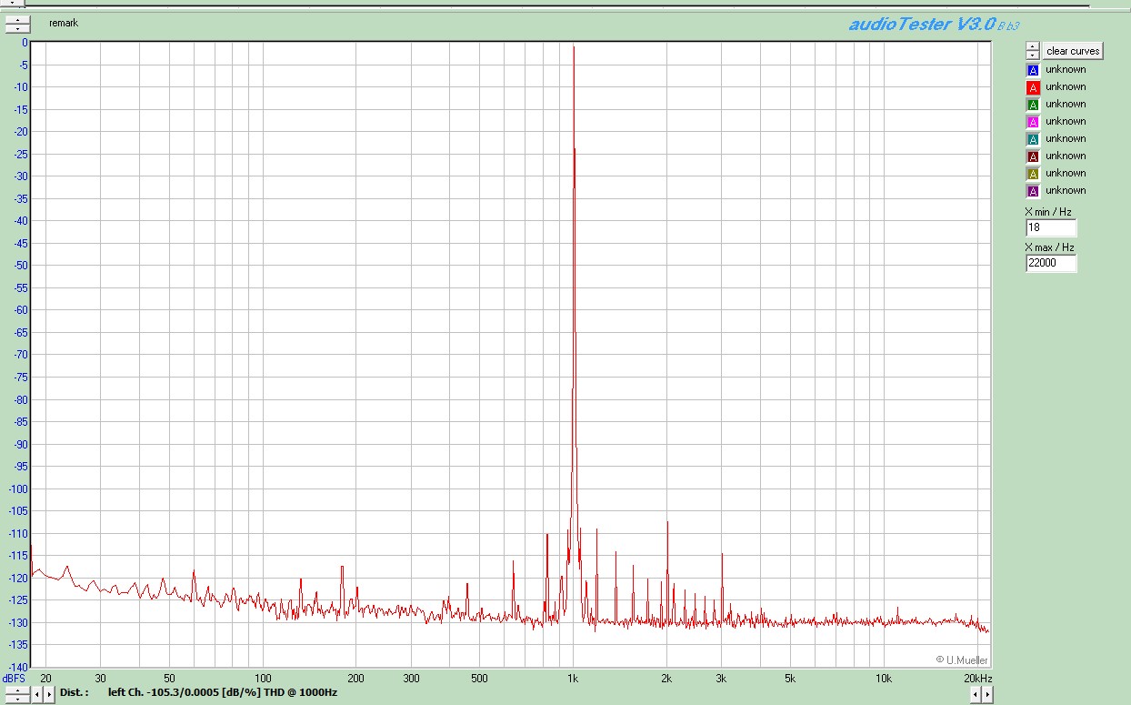

Your curves are not as easy to hit as you make it sound. This is the best I have been able to do sound card in to sound card out. 48k sample rate 1Vrms 0dB Blackman. 65536 pts.

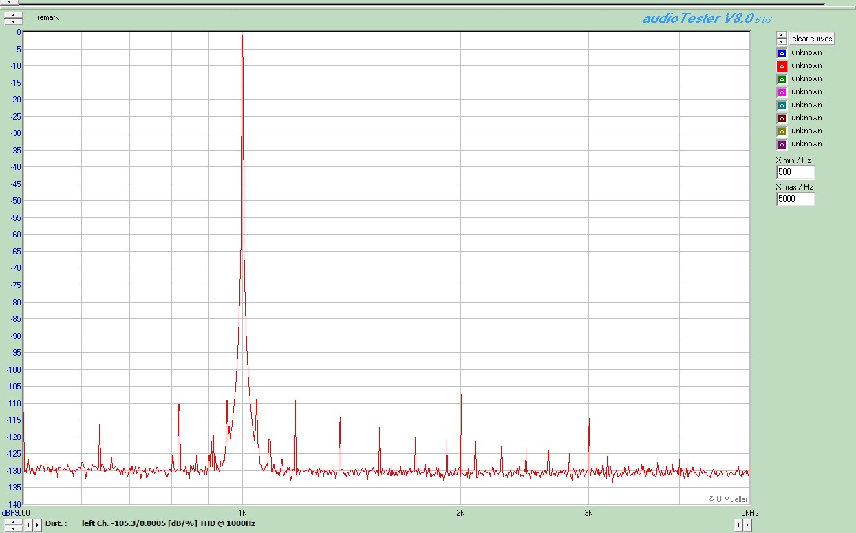

Now I have sidebands on the fundamental however. Also attached is zoomed in freq range around fundamental. Any Idea?
