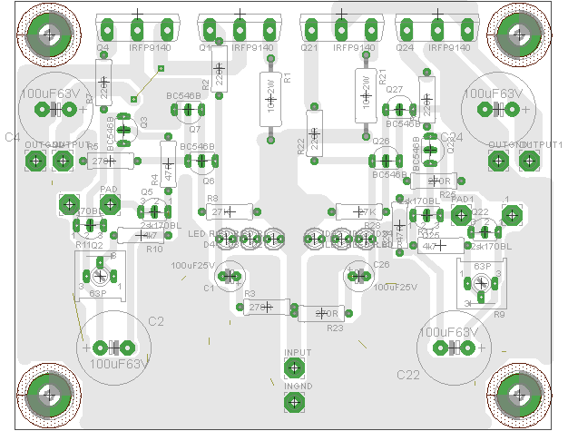

See any major design flaws in this layout. This is the Shunt regulator. I put both regs on the same board. It will be fed by a very stiff comon power supply.
The power supply will produce 51V using a RCLC filter. PSUDII calculates ripple at under 200uV.
The RIAA circut will be 1 board per channel. Still working on that layout
R22 too far. In general gate stoppers better be very near to gates. I would prefer defined ground lines to a ground area also. This reg is very difficult not to work in any layout though. Better make 2 exactly same ones on the common board, but having own grounds, with ability to wire two different rectified DC inputs for when you may have a second transformer for full double mono. You can use a couple of jumpers for common feed as for now.
