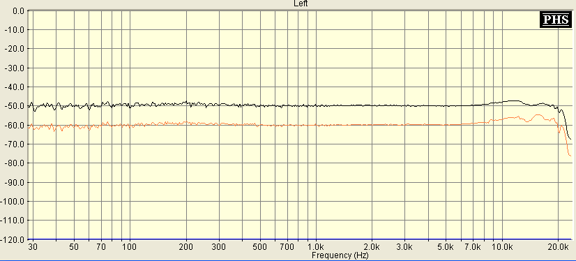

Hey Merlin, this is DL103R on HFNRR side 1 band 3 & 4 through my Simplistic LMC.
Black is left channel playing band 4 *left mono pink
Orange is left channel playing band 3 *stereo pink.
Resolution 1/48 octave.
Hi Salas, compared vs measures gived with the cart I not see any change, very flat & a little bit upper highs increased, congratulations because sounds like measured
More DL103R info
