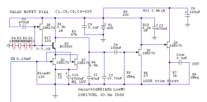

Yes please Merlin's Low MC for 10.5mA Idss
Thread is a bit long to plough thru
Thanx
Switching C10 with on board dip makes it normal MC.

I am very, very infuriated:mad:, I have paid to Parts Connexion extra money for matched pairs & I have received:
Channel Left:
R3 47K
R4 6K8
R5 1Meg13
Channel Right
R3 46K8
R4 6K9
R5 998K
Thks in advance Ricardo let me know how can do with these mix.
Are these the real values on your build ? I wish you had made pairs before soldering.
I also need to know the real 3k3 value.
Admiting 3k3 = 3k3 sharp, in the Left channel you can // 1M5 to 47k and 300p // 47n......you will be very close to heaven. :)
Now the other channel is bad.... the main problem is 6k9 that should go down to 6k77 .... You will gain lots of presence that way in this channel. Also I would go for 1M7 // 46k8 and 300p // 47n.
All this with 15.6n // 330p as initially.
Now it would really be good to have both channels with the same values... do you have more resistors so you can make equivalent pairs ?
