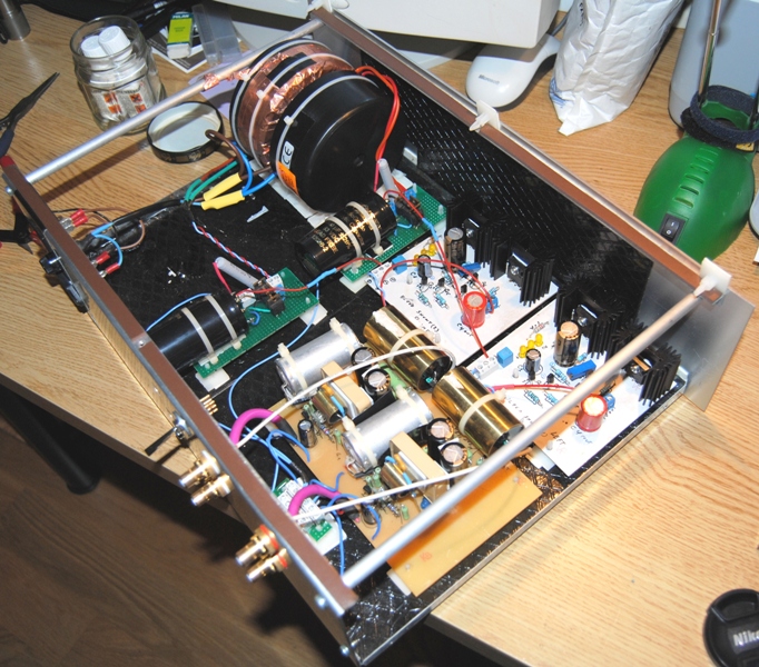

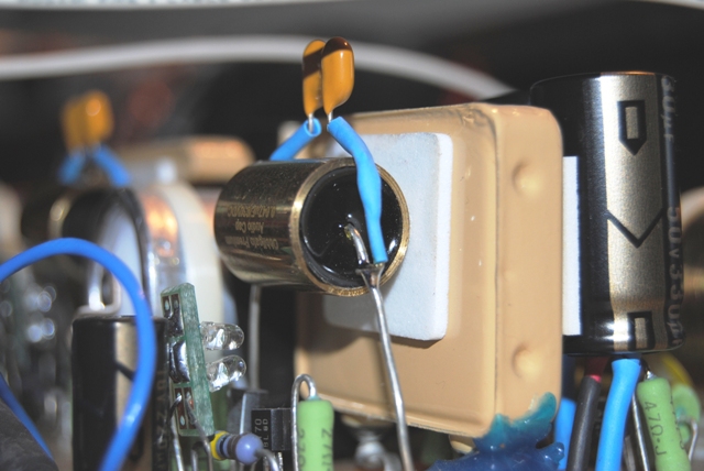

At shunt do you refer to C4 220uF/63V? If yes I chose Panasonic FC because I can not get Silmic II at this voltage range.
The rest of caps for shunt are:
C1 100uF/25V Silmic II
C2 1.000uF/63V Panasonic FC
I have several BG in other diy projects that now I am not using, if the Simplistic sounds good I will try to change (for example I am sure that I have 2 BG 10.000uF/63V for PS instead the Sikorels)
In this case, C2 determines the Tone so you will hear his cap above all. (Muse produces big bass but needs a film bypass - Silmic are quite good )
IMO C1 removes harsness and I noticed big improvements in low level detail by upgrading to 220u 35v Ruby ZA (Inexpensive and VERY efective at high freq).
C4 must be transparent so I am using dedicated nonpolars here... unfortunately these are only 35V so I guess you could use ZA also.
Thks for advice, the big problem here is the high voltage needed for C2 & C4, I have 4 caps 220uF/100V Nichicon Muse, do you mind will be better for C1 & C4 instead the Silmic II? I believe wil lbe better the Silmic II except for C1 is only 25V & the Nichicon is 100V here the difference is big but for C4 the Silmic II is 63V & the Nichicon is 100V there is not a lot of difference & don't believe better sound changing to Nichicon, what do you mind?
