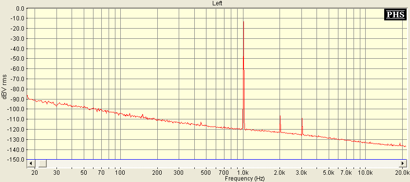

8.5mA Idss is the reference for Q1,2,5. You must know that by having a distortion meter or FFT, it is better if you can tune with trimmers instead of directly using steady Rs. Jfets differ in some things and there is always a sweeter spot for best THD in each build, and its clearly audible, but it takes some calibrated clean card or lab stuff. Another approach (practical but tedious) is to listen for +/- 0.5V Vd steps around ballpark Rs schematic value and decide. It changes Ibias, varies second harmonic and its proportion to 3rd. For the cascode stage you measure Vc on the bjt's top. Doing it by ear its a juggling act so to ''tune'' for two stages, but it is rewarding. Don't choke the stages for too low voltage across the elements or too little current.

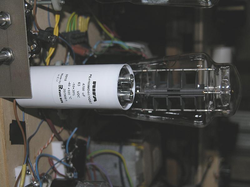

36Vac X 1,4 == 50,4Vdc minus 2V drop in bridge should deliver 48Vdc on your reservoir capacitor. Each phono stage consumes about 50mA, so two will draw 0,1A. According to Ohm's law delta V (48-32)= 16Vdc which equals the current (0.1A) times the value of the drop resistor. So you need a 160 ohm resistor which dissipates 1,6 watt continiously. A 5W wirewound will be practical, followed by a capacitor as big or bigger than the reservoir cap. 2200uF 63V is a practical value.

In my working riaa, I am using a 2x15v TX (80VA) and I read 42v after the smoothing caps.... The shunts produce 28v from those 42v.... maybe that is why they heat so much ??
ricardo
Yes mate, too much power is heating things up.
To get 32 to 33Vdc you better look for a 24V + 24V tranny in the 100 to 150W range. Nice, old skool EI-core is fine. Use a toroid if you must.

Wise choice both on trafo and resistors. I have them resistors chosen such in a 56dB build. Don't forget the trimmer thing I posted about fine tuning, since you are our official tweaker. 100R trimmer parallel to 100R resistor for Rsource. After tuning I get 0.0025% THD and 0.005% IMD with 0.5mV RMS input. Nice for a non loop feedback simplistic circuit. Check out FFT.
