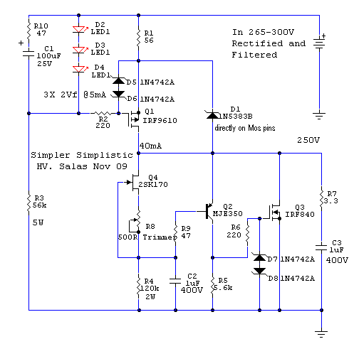

I'm collecting parts for a 300v SSHV as shown in post #967. The test suggests replacing Q2 MJE350 with a higher voltage part, namely the 400V MPSA94. This part is not available to me from my normal suppliers. Are there other suitable components for Q2 that I could try to source?
Thanks.
Thanks.
my SSHV is working at 315vdc and mje350 at 295vdc for 6 months or so with no issues so far. i say give it a try.

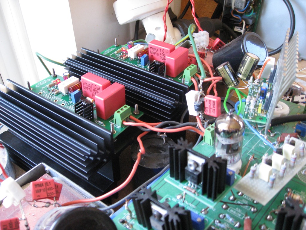

I just powered the new regs and I see smoke coming from the current adj resistors. The resistors can handle 3 W. Any ideas what's wrong?
Found the problem. The voltage adj trimmer was set for too low Vout.
