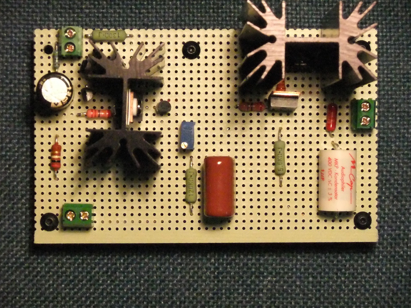

A few days ago I changed Q2 to MJE5731A . Sounds better. I'd like to understand why but looking at the data sheets I don't get it. Anyway, I think it's worth a try if you have them on hand.
It shows flatter extended hFE curves but beyond our bias range here. Did you measure its hFE? Can have more, or can have more Vbe for the Jfet. Please measure Vbe at its circuit bias and tell us. Looks like having more Cob' normally since its more powerful although you never know where Cob' is judging by stated Ft. That could change the phase enough. Sure thing is it is TO-220 and I prefer that in a hot environment, plus has more voltage. So its nice it fits. In what way you found subjective changes, and is there a photo to see where it lies on the board? Also what is the output voltage you work with, again?
Well that's good timing. I just pulled the boards out so good time for a photo. Just switched in another board - same circuit but with a cascode DN2540N5 / IXTP01N100D for the CCS.
Subjective? Hmmm, there's a sort of grey bright hardness in the sound that I hear with the MJE350. This to my ears is improved with the 5731A. I guess a little less harsh or a bit sweeter? The tone somehow just feels a little more realistic and I relax when I hear it after listening to the 350.
Output V is about 360VDC.
I'm hearing a few things with the DMOS that I don't like but that could just be implementation. I'll play with it and listen for a few days and then put these ones back in. Will measure circuit voltages and post them as soon as I do.

Hmm it is very near the main sink indeed. TO-220 has a benefit there for perceived heat. You had been using the MJE350 beyond max Vceo? Can have both better linearity, hFE, and more Vbe the new one. Datasheet does not show in such low current. Measure Vbe when back in service, its interesting. The DMOS (single) I have written sometimes back in this thread that I have not opted for too... Cascode, lets see for your final evaluation.

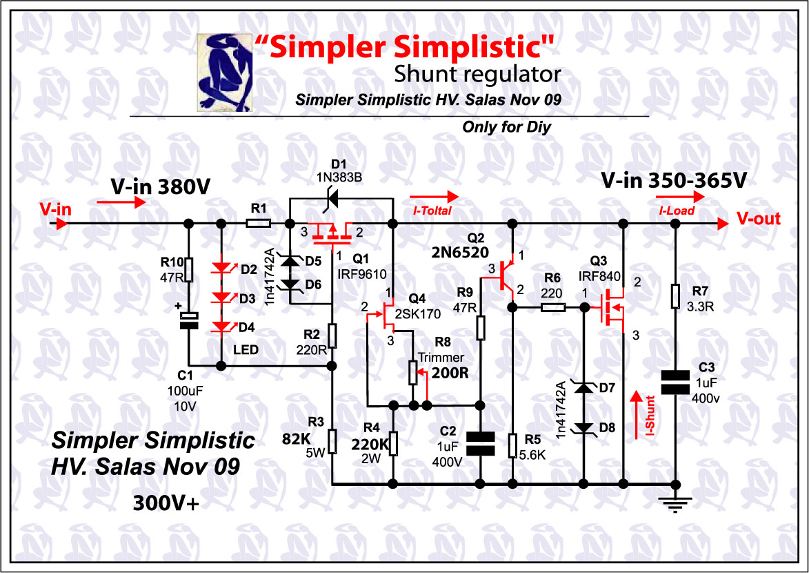

I just powered up my SSHV but was having problem achieving the 300vdc target I was expecting from the 315Vdc Vin as measured at the 47R input resistor. What I got was only 90Vdc even adjusting the VR to the max. The 3 LEDs did not lit up. Output load is 10kohms. What have I did wrong? Thanks in advance for any advise you can give.
I use 20H 55ma choke (DCR 390R) in place of the 470R/5W resistor.
R1 = 47R
R3 = 68 K/5W
R4 = 180 K/2W
R5 = 5.6k
R6 = 220R
Trimmer = 500R

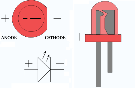

LED does not light, then the CCS is your problem!
Check to see if connection led the wrong vacuum?
ie the opposite direction!

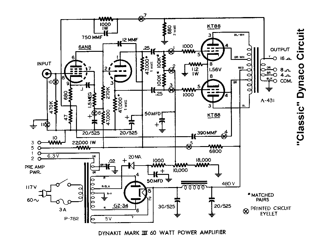

Does anyone know if there is a schematic here that would work with a Dynaco MarkIII clone?
Only for the driver part not for the power output. Tell us what are your voltages at points RED and 5 on this schematic so we can suggest a reg.

RED (DC) I see on that schematic as midpoint of output transformer's primary. That will show your real B+ in a build, and eyelet 5 will show the real HT voltage for driver circuitry. Their difference divided by 6800R will give the front end's current draw. Then we can set target parameters for the operating point of a suitable reg. SSHV can operate even over just 10V In-Out difference.
