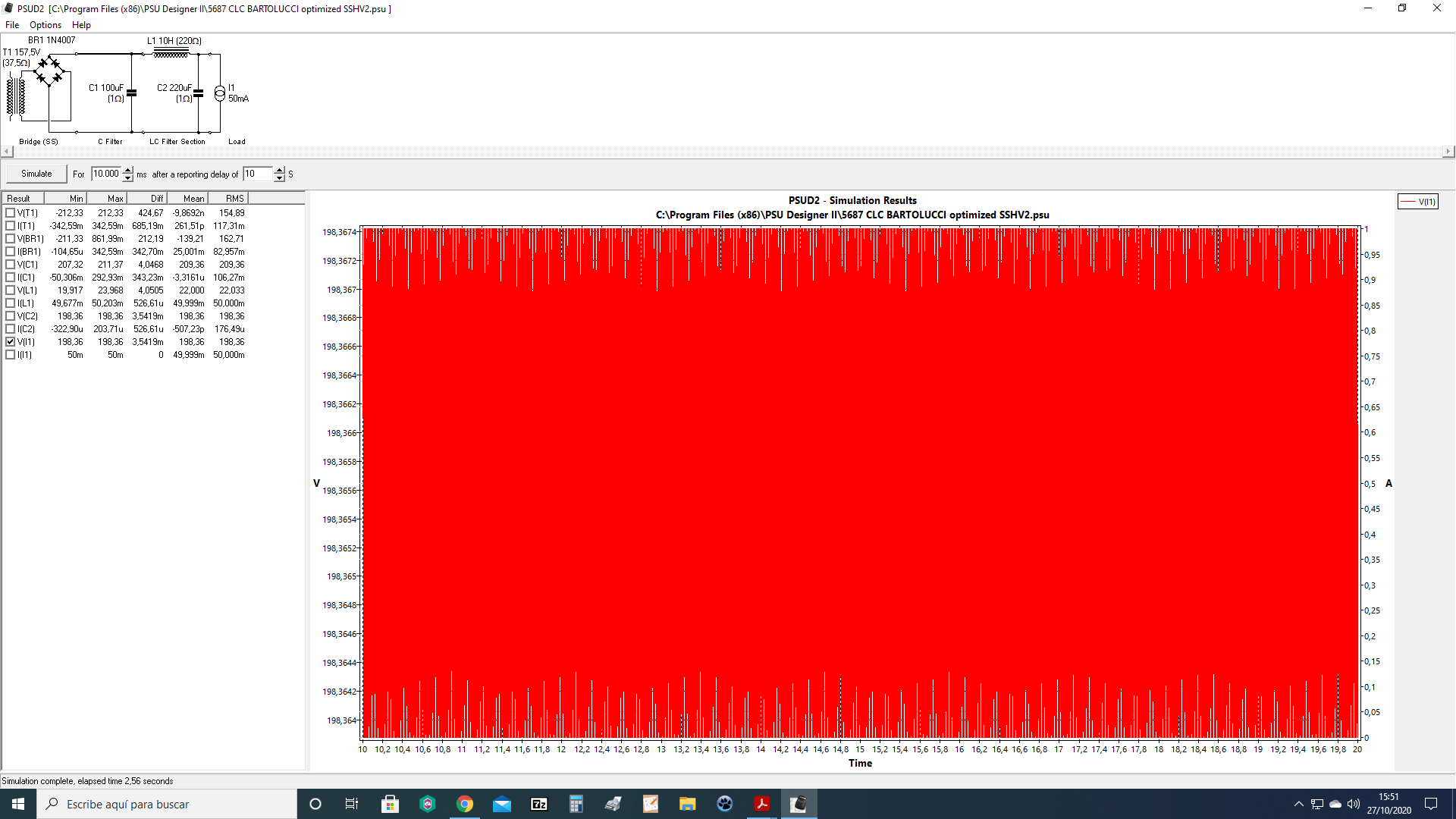

Salas I only get max. 30mA CCS with 150VAC tx, what's the possible issue? I use CCS 30mA as load, also I use 100R 100uF to split B+ for both channels. R9 & R10 both are 56K in place of both 68K. The SSHV2 CCS works well to max. 30mA, I tried to lower the CCS load to 20mA but the same problem SSHV2 max. CCS 30mA.

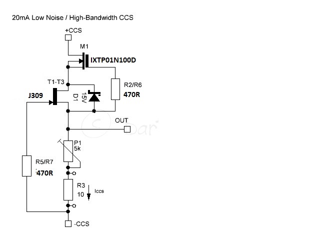

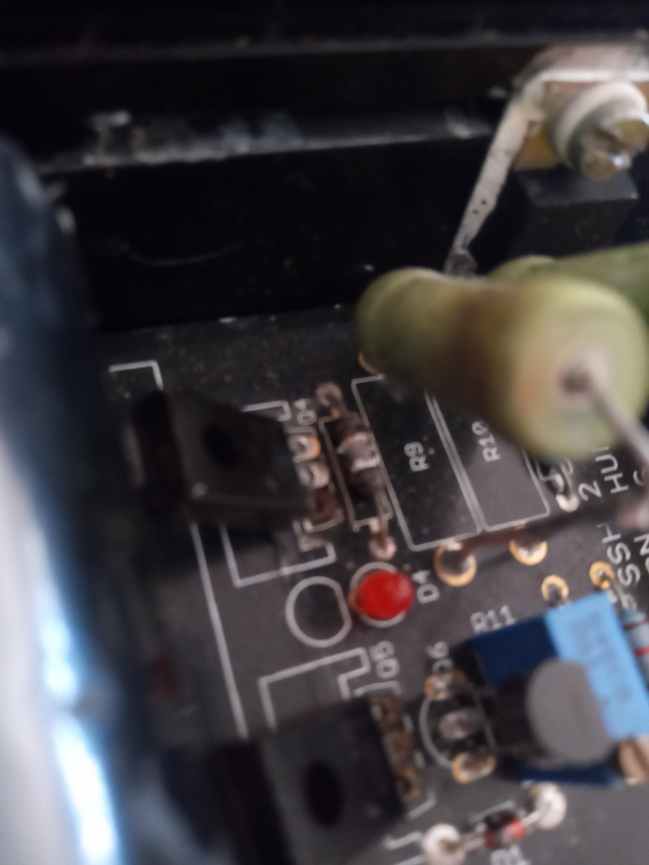

Was Q5. Now can set the SSHV2 CCS to 50mA & adjust Vout but I have a problem CCS load can reach 15mA each channel, only one channel 13.5mA max. and the other 11.1mA. CCS load tested without SSHV2 & reach both channels 15mA each, attached CCS schematic used.

Given that you find proper sized HV cap and high PIV bridge that fit well I am afraid of narrow space between adjacent copper lanes at places. Although the bottom side pictures are blown out and I can't say for sure. HV needs safe distances not to arc over.
