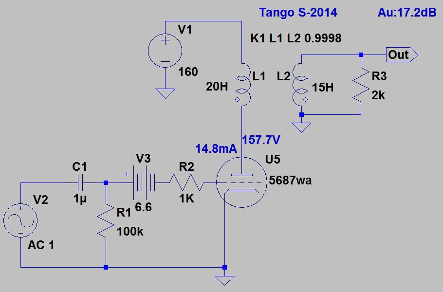

Salas what do you think about the schematic?
Joined 2009
It's inoperable.
There are no resistor from battery + to Gnd.
500K, 1Meg, other value?
circuit cannot work. check the circuit in the thread u linked, there is a 6.2v return marked by yellow arrow. Euro21 has pointed out.
Could you post or link the schematic please?
@euro21 & commstech if it's too much OT please send me P.M. thank you.
I'm sorry Salas.
