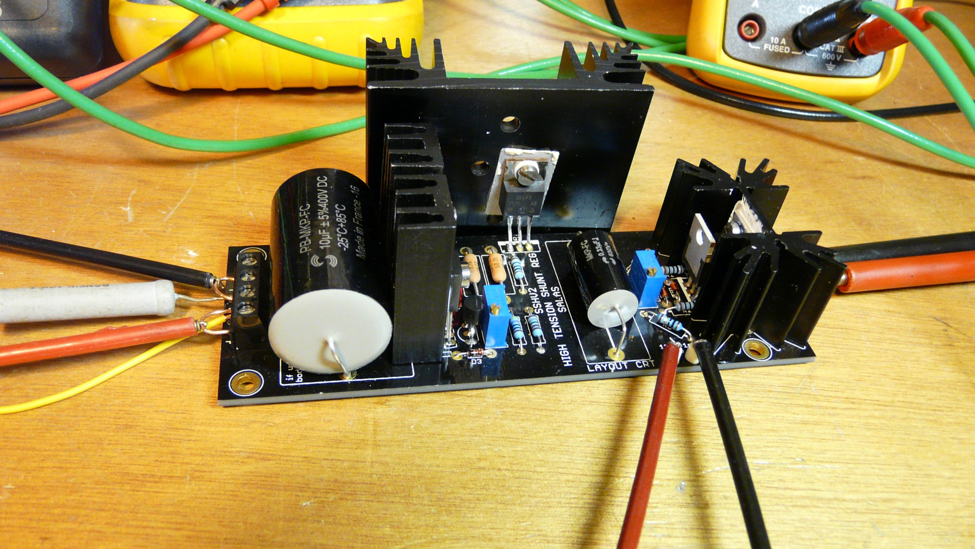

I have put in an IXTP01N100D and larger heatsinks for the 2SA1381’s with better results, though they still produce a lot of heat at 40mA. The rest stays pretty cool, no excessive heat until so far. Still have to swap the 10uF for a 630V version. Probably better.

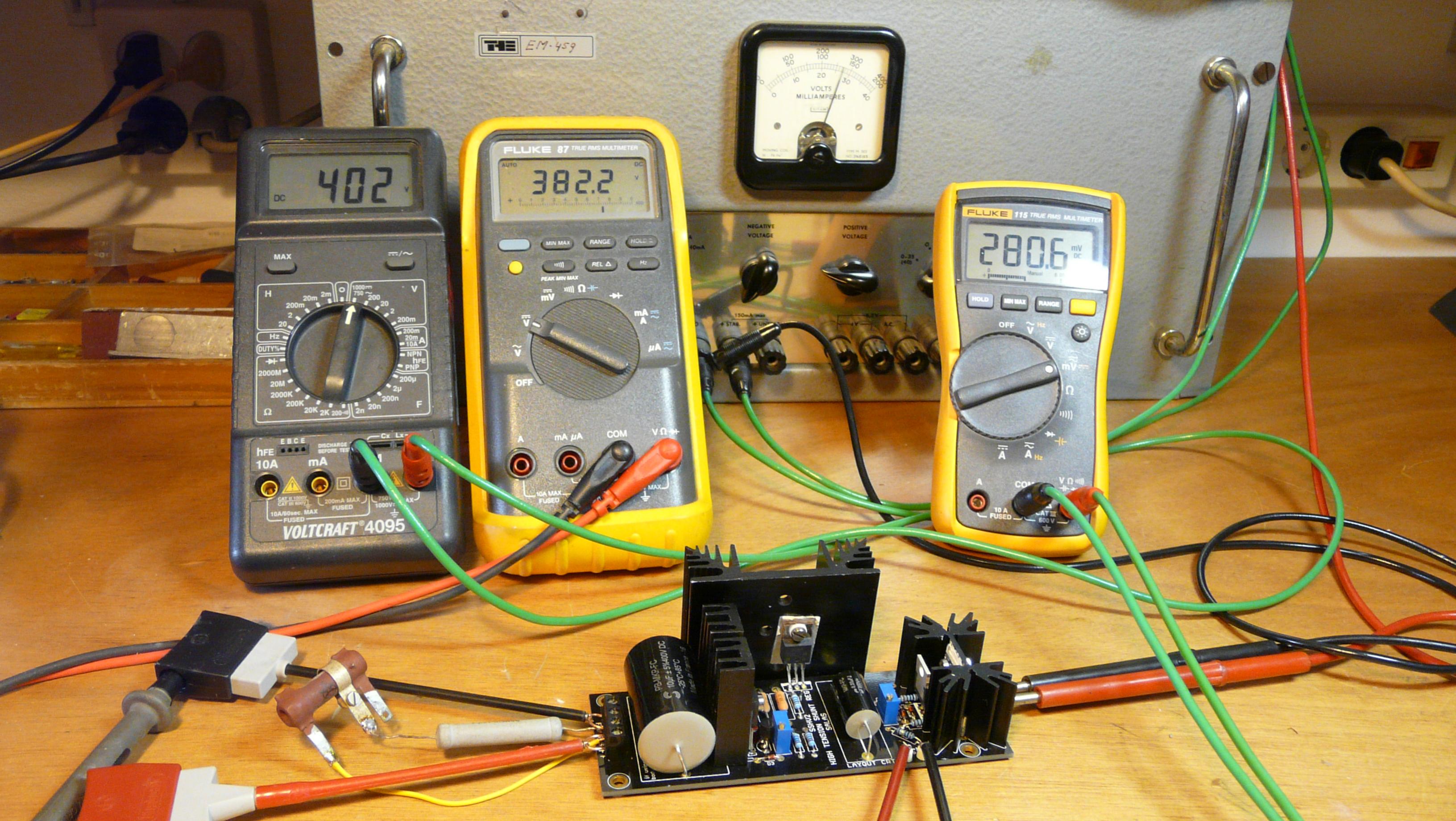

What do you think of this? Could these settings be applied for my setup, the Alan Wright PP-2C? (Look at my schematics posted earlier)
If so, it would be most convenient, for it results in much lower heat dissipation in the 2SA1381’s and it is supposed to increase the sound quality.
I took these settings for a test run and the regulator seems quite stable, see photos.
Meters from left to right:
Voltage IN (V)
Voltage Out (V)
Voltage TP (mV)
The load resistor(s) value is approx. 19k.
How about another Spice simulation, euro 21?
Tia,
Rovano

My Voltage drop will be lower than K&K’s example. I am aiming for 400 – 380V. If you take a margin of -+6% that would be 424V max. and 376V min. Dissipation max. > (424-380)*0,026 = 1,14W
In case I would set the regulator for a normal value of 40mA, dissipation max. would be (424-380)*0,04 = 1,76W right?
If the load would be disconnected, will the regulator try to ‘eat up’ all the power? If so, the max. dissipation would be 424*0,04 = 16,94W. Can we then not conclude that when the load is disconnected there will always be damage? The damage in this case is even worse than when the regulator is set for 26mA > 424*0,026 = 10,4W or do I make a mistake here?

I have not been building yet, but my raw DC should be around 450V DC. I have to bring it down by applying an extra power resistor to the required voltage of the regulator. (see my schematics posted earlier). Anything between 450 and 400V is possible. Mains in my country is 230V AC +- 10% according to the standards of the power company.
As I understood, there should be a difference between in and out of at least 20V?

380Vdc as your required output gives the minimum input to the shunt regulator as 380+20 >= 400Vdc (including any ripple).
When your mains is at 230-10% = 207Vac (that is very low, the harmonised voltage in the EU is 216Vac to 253Vac).
You need a transformer that gets your 400Vdc after the rectifier/s when the mains voltage is at 207Vac. A solid state rectifier will drop about 0.7Vf thus your transformer will need to be 230:315Vac
315*sqrt(2)*207/230 = 400.9Vpk and subtract the rectifier and you have achieved your 400V required as your input to the regulator.
Now look at max mains voltage: output DC will be 315*1.1*sqrt(2)-0.7 = ~ 489.3v
The Shunt regulator now has to drop 489.3-380V = ~109Vdrop.
At 26mAdc this amounts to 2.8Watts
You will need to account for transformer regulation which I have ignored in the example above. You can probably do that by adjusting the dropping resistor you mentioned earlier.
Hi Andrew,
The 10% +- margins are extremes, but still within the conditions of the mains connection of the power company. Practically they never occur. In my case mains is always around 230V. On sunny days it might even go up to 234V as I have my own PV installation. I have never measured anything below 225V. In the Netherlands we probably have the best power grid of Europe.
As you mentioned, I will be able to adjust the incoming voltage to 400V by applying the right dropping resistor.
Now, back to my initial question: Will a quiescent current of about 6mA for the regulator alone suffice to make it work properly? Will this setting, as K&K claims, increase the sound quality in a differential amp stage? I have been testing this setting and it seems to work just fine but Salas says that the output impedance of the regulator will go up as a consequence of a lower than 20mA quiescent current. The advantage of a lower current is less dissipation, obviously.
Maybe I just have to try different settings when the amp is completed…..
What I still can do now is measure the temperature of the heatsinks of the two KSA1381’s with a setting of 40mA. What is your opinion?
Rovano
