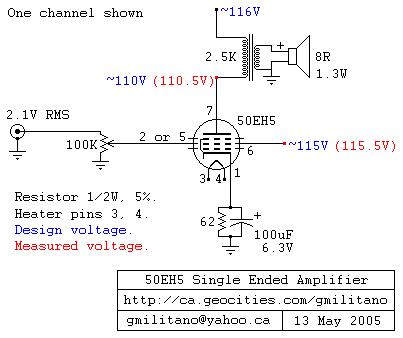

I realize this is a little late, but here is the schematic for a little spud amp around the 50EH5. More details about this project are on my website.
Gio.

Re: 50EH5 Spud
Strapped in triode probably about a 1/2 W, i did one of these too...
<http://www.t-linespeakers.org/tubes/SEP_50EH5.html> I've got a much beefier one planned.

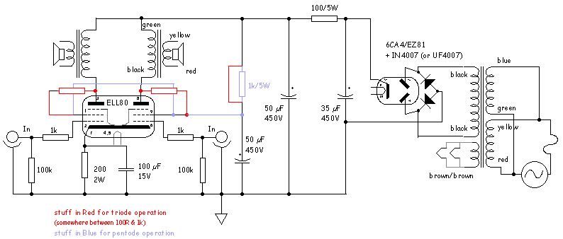

The ELL80 amp we built is also quite sweet, but really needs a driver tube if used with just a CD player.
dave

Re: Re: 50EH5 Spud
I should have mentioned that my 50EH5 was based largely on Dave's 5 buck amp in the link above.
A CDP drives the 50EH5 in Pentode mode to less than a watt. So in triode mode, power will be very limited without a preamp.
Keep us posted on your beefier 50EH5.
dave

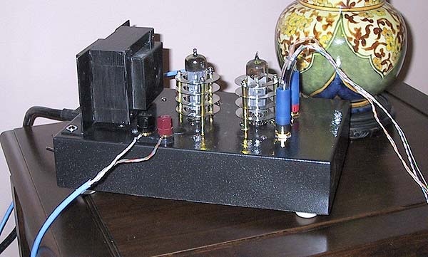

Are there any advantages or disadvantages with using only one tube for both channels?
Where did you get those cages to go around the tubes? They look nice.
Gio.
frugal-phile™
Joined 2001
Re: Re: Re: 50EH5 Spud
I'm sure there are... but it is cool to build a stereo amp with 2 tubes when one of them is a rectifier...
Gifted to us by Eddie Vaughn... i can check on sourcing. He'll be using them on his Carina i believe.
