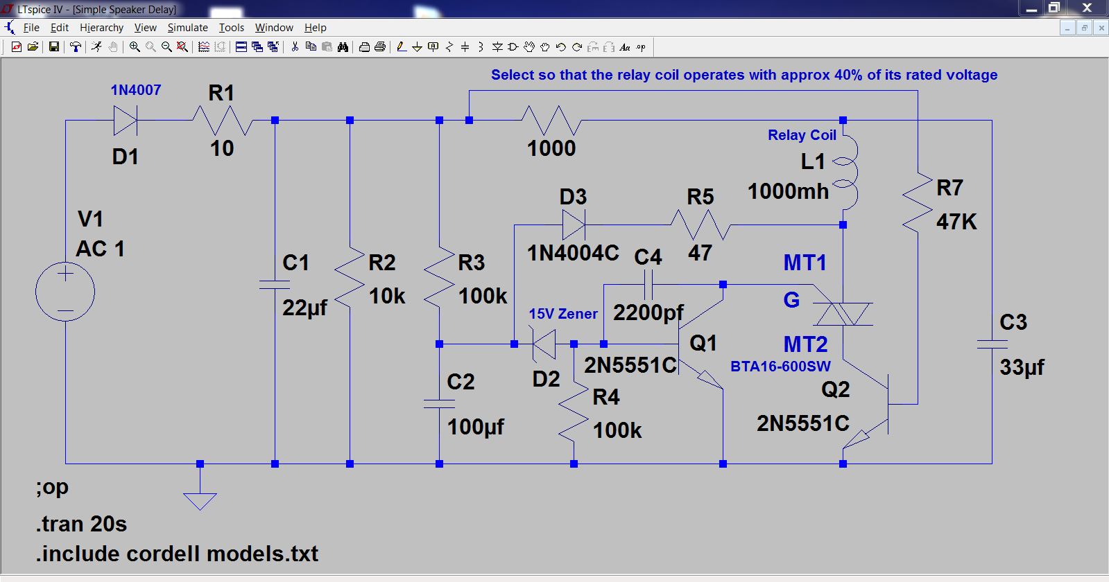

Why are you not considering the conventional back emf solution: the diode across the coil?
I prefer the diode + zener after D.Self and others told us that it allows faster opening.
Good question... my thinking was this,
To save on parts, was suppression needed in the first place as the triac doesn't even come close to any danger area.
The actual transient spike on the triac did exceed the 1N914 P.I.V. rating with some values of relay coil inductance hence the suggestion of the 1N4007. Add the small cap mentioned and even this problem disappears.
I haven't measured it using Dougs Selfs method but suspect it wouldn't achieve much here because the actual switch off time depends on the collapse of the rail and then the triac dropping out of conduction.

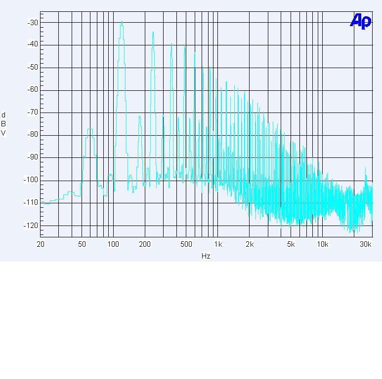

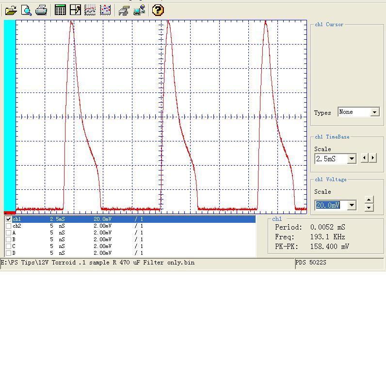

It is not the glitch. When you load a transformer with a single diode, this causes an unbalance in the current draw. This causes a slow magnetic shift in the operating point and slowly reduces the efficiency of the transformer. It is not large but can amount to a few percent if the system were to be left on for a month or so. When you switch the gear on the ac waveform is at some random voltage and this wipes away much of the residual magnetism. (But not all, it is a random process and averages out a bit.)
As to rectifier noise attached are a picture of the current draw and the spectrum analysis of a center tapped bridge.
All rectification causes noise. With a single diode you start at the line frequency and draw twice the current for 6 db more noise. The full wave bridge will start at twice the line frequency and with 6 db less amplitude.

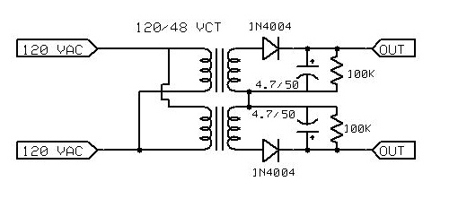

I showed this in Audioxpress. This is the tabular data showing loss with time. Note the change after a power failure.
Also attached is the DC offset measurement circuit.
AC Line Out Ratio Loss % Loss
125.2 60.0 0.4792 0.0000 0.00
125.5 60.0 0.4781 0.0011 0.24
126.6 60.5 0.4779 0.0014 0.28
125.6 60.0 0.4777 0.0015 0.32
123.9 59.1 0.4770 0.0022 0.47
125.2 59.6 0.4760 0.0032 0.67
125.1 59.7 0.4772 0.0020 0.42
125.4 60.0 0.4785 0.0008 0.16
.88 VDC offset

smart design! I like it.
As the circuit was meant for switching a speaker I'd also like to see the relay doubles a protection functionality on top of its initial intended muting@power-on purpose. Perhaps an NPN transistor or a low Rdson MOSFET can be paralleled onto the triac across A and K, when a faulty condition occurs (DC at output, over-current, etc), this transistor/MOSFET turns hard on for a very short moment bypassing the current in the triac and therefore turing it off. would this idea work?
Administrator
Joined 2007
Thanks...
I think this would work as one option. Having a normally on device such as the NPN shown here. Pulling the base down to ground even for an instant would turn the relay off. (if the trip input trigger were a transient fault then the circuit would reset, if not then the circuit would stay tripped)
(remember that as originally intended the whole circuit doesn't need a "ground" that is referenced to the amplifiers "ground". This eneables it to be powered in a variety of ways such as "across" the transformer with no reference to the amplifiers circuits. Adding a trip input like this means that the triac circuit needs its ground line connecting to the amplifiers ground line or you could add an opto-isolator to pull the base of the NPN transistor low)
