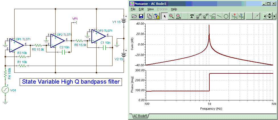

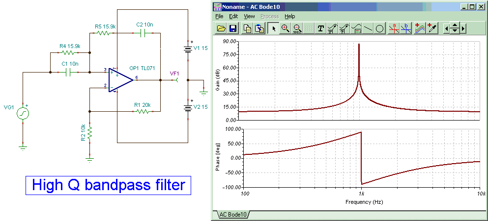

These two figures show two kinds of High-Q bandpass filters.
Wien Bridge and State variable filter are the most common circuits of low distortion Sine-Wave oscillators.

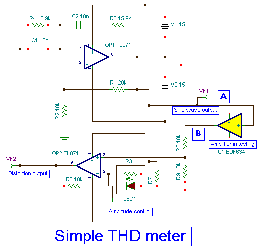

I choose Wien Bridge as the first trial.
Because Wien Bridge is simpler.
Here is the simplified circuit of the simple THD meter.
This cricuit can work but its distortion character not good enough.
The voltage gain between point A and point B in this schematic have to be equal to 1 (0 dB).
In practical testing procedure,
It still need an Attenuator and an amplifier to adjust the voltage gain.

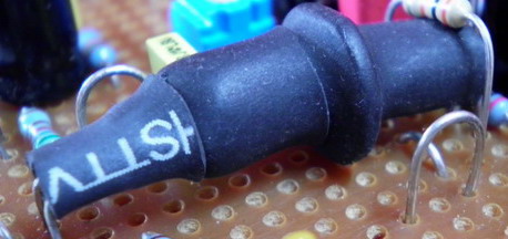

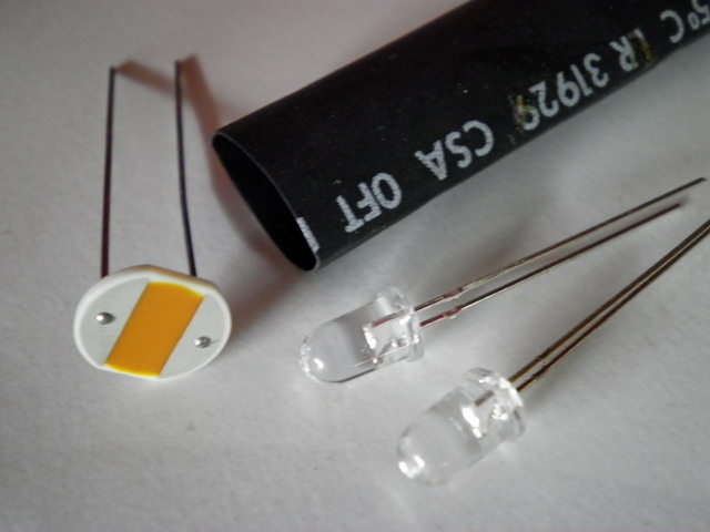

The key component of this circuit is the photo-coupler.
I use 5mm Red LED and CDS (Cadmium-Sulfide) photo resistor covered by Heat-shrink tube to make a photo-coupler.

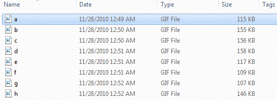

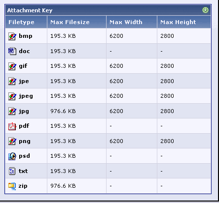

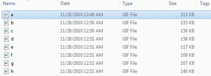

Sorry!
I have problem to upload pictures.
I don't know why?
write type and size of file you tried to upload , so we can see what's culprit

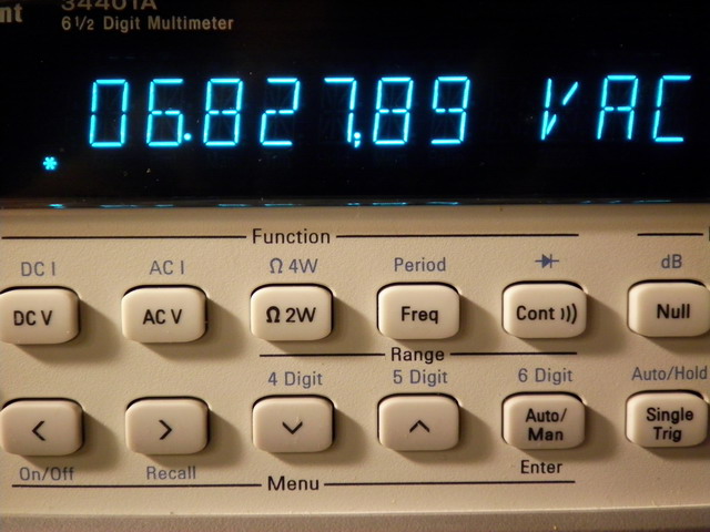

It seems I cannot upload a file bigger than 30KB.
At first,

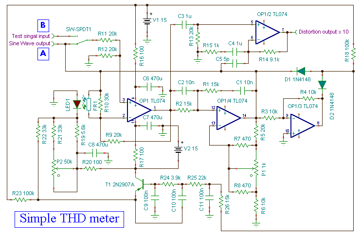

The distortion character of my simple THD meter could only reach about -50 dB to -60 dB.
So I spent a long time to tune this circuit, reduce its distortion to about -93 dB.
Although the Sine-Wave amplitude and the distortion signal keep drifting a little bit.
But the distortion character still way beyond -80 dB anyway.

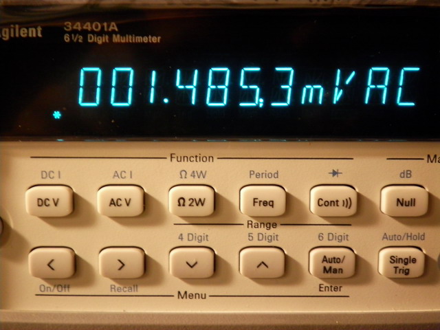

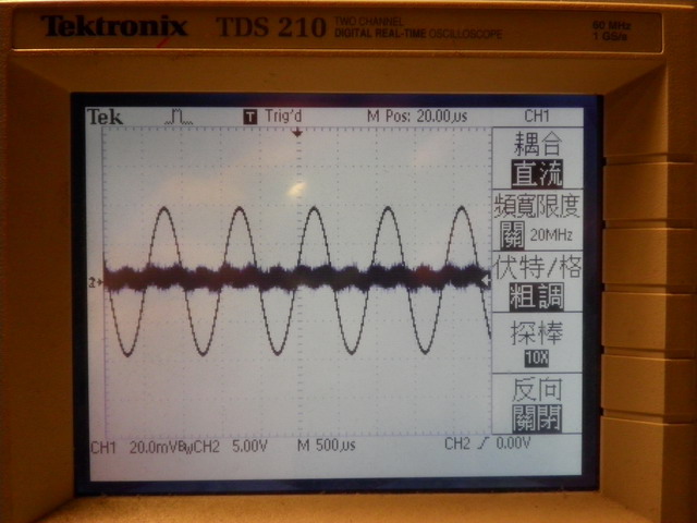

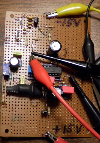

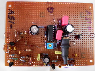

Here are schematic and pictures of the simple THD meter prototype, Sine-Wave and distortion waveforms, Sine-Wave and distortion output voltages.
Because of the variety of LED and CDS,
Just follow my schematic to build it may not succeed.
It needs some tuning to get a steady oscillation.
And it still has much room for improvement.
I will keep improving it when I have idle time.

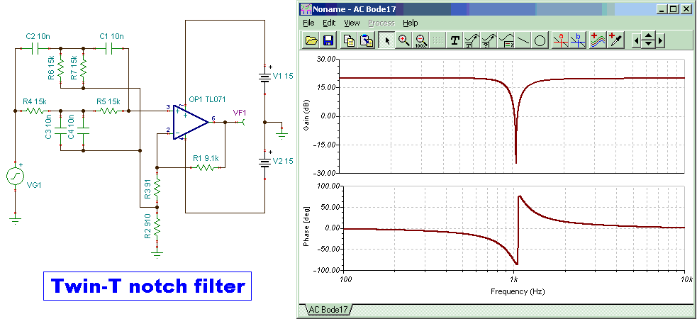

Next step,

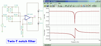

I will try to change the x10 amplifier of the distortion output into a Twin-T notch filter.

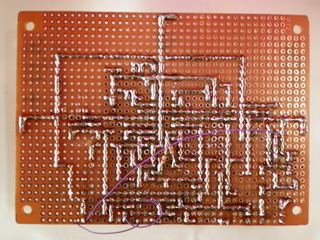

PS. Sorry! I cannot upload my prototype's pictures.
Next step,
wensan - send me those pics at >choky@neobee.net< and I'll upload them
Thanks!
I come to my father's house and upload those pictures successfully.
Nicely done PCBs.
Patrick
Thanks!
You see its's very simple and cheap.
That is the most important thing of this project.
