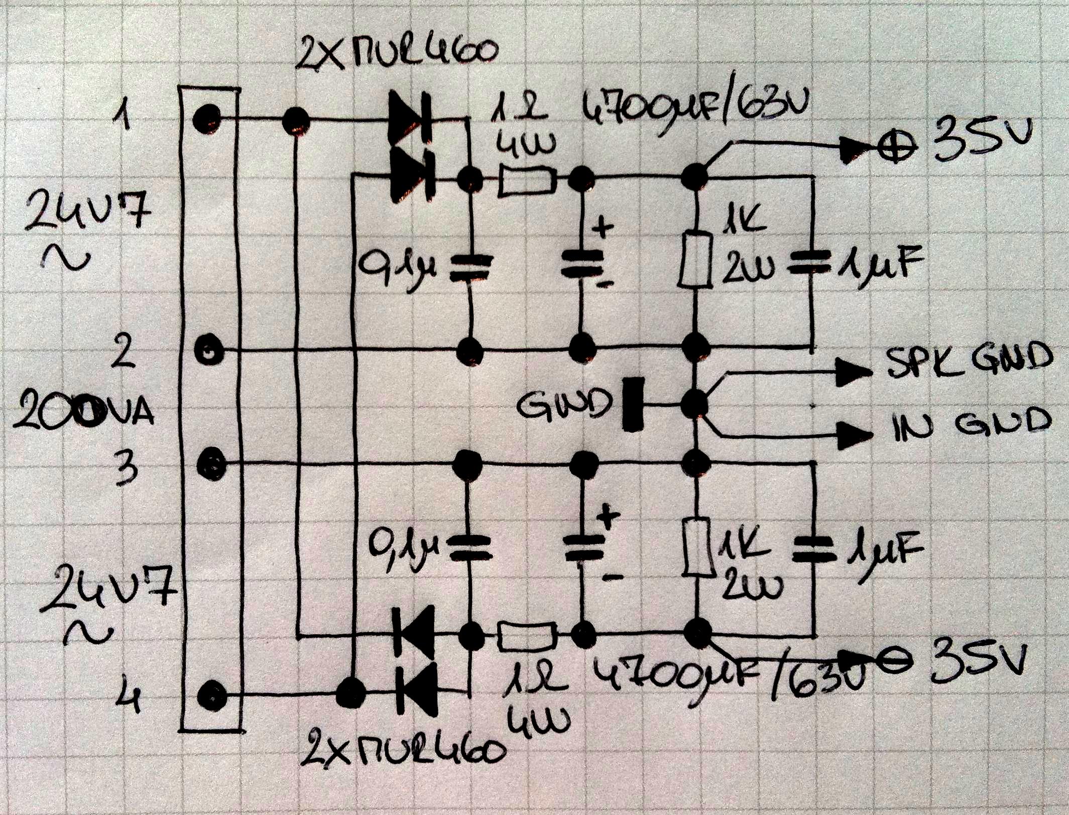

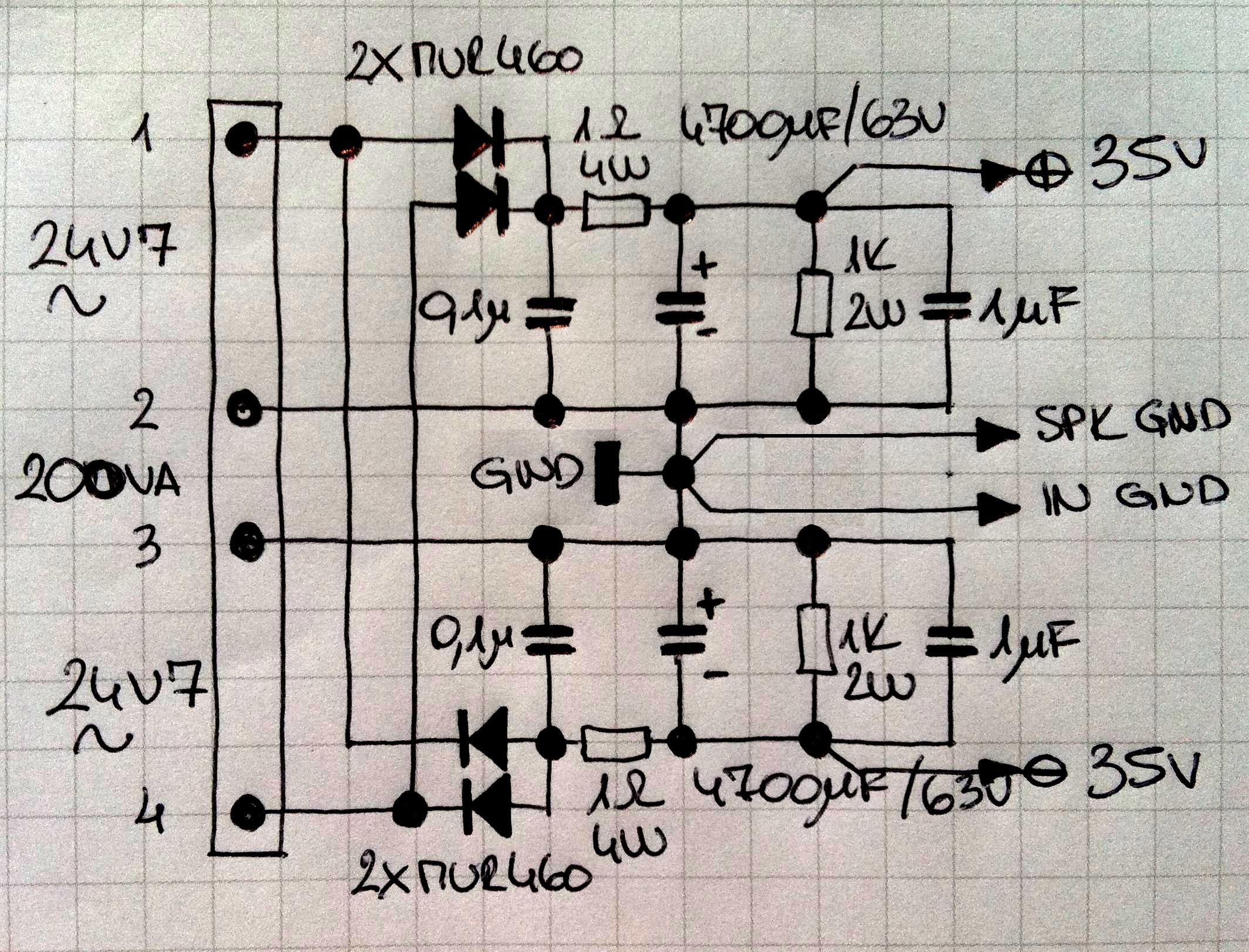

So I prepared quite standard power supply sch to be located together with amp on the same PCB. Connector for the transformer secondary AC in should be Phoenix type with screw wire fixation. Diodes could be other type, but certainly ultra fast recovery type to minimize on/off transition high frequency polution to the rails. Filtration is calculated to approximate power consumption of this specific amp, but can be altered or change accordingly to the best functionality.

Per popular wisdom, your grounding is wrong. The main filter cap gnd should not be connected through the star point. They should have their own connection straight across, preferably with solid copper or aluminum bar, and then the center point of that goes to the star. Minor difference in your drawing, but it can be make a big difference to how a PS is wired or laid out on a PCB.
OK thanks AJ, corrected.
