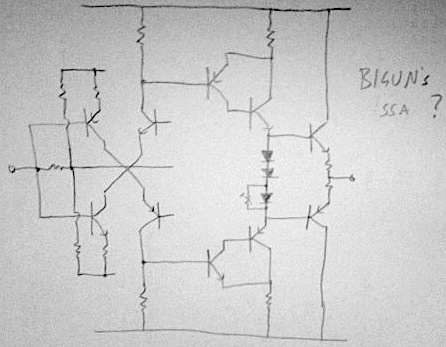

Actually, I realized that it's not post 183, 196 or 336 I'm looking for but a CFP driver and single EF output. Not sure if this will work but attached is what I have in mind. Yet another variation :D

It will work. ;)
The second stage BJT is actually formed of a high current gain compound Darlington (Sziklai pair), which is in correlation of the max total gain we want to get in a simple SSA version like this. :)
Bigun I don't see anything stoppin' you at testing this version. :D

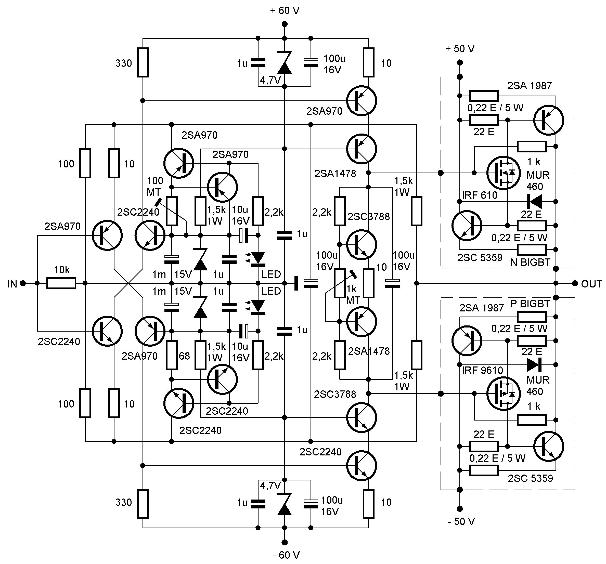

I tested BIGBT version extensively, high temp, many hours, signal generator, music, different loads, no compensation caps, no oscillations, clear clipping, ultra fast slew rate, no DC-offset variations ... :D
Please make a short circuit on any of your's amp without overcurrent protection ... I can imagine that too. :bomb:
I like your approach, Bigun. Very elegant, and the emitter driver output will have low impedance and drive the output stage very well.
Let's see, base to rail resistor for predriver would be 1K, we could run the driver quiescent at around 30mA, and this means, assuming cascode current is 2mA, the predriver emitter to rail resistor would be 47R. With a Zout at each driver emitter of around 1R, you'd have enough drive to propel the USS Nimitz, and of course nice local feedback around the driver circuit. One change, however; I'd put a 1K resistor from emitter to base on each driver to ensure residual current at all times through the predriver.

I think the concept is very strong.. It scales easily.. can be fitted with a number of different output-stages....I am currently contemplating a version with a sort of current dumping configuration with laterals driving a number of BJT's
oh by the way the OLG...its about 70dB ant the OLB is app 50 KHz (-3 dB)
One thing i have trouble seeing through is how to adjust the current through the input pair/cascodes

Hi am most pleased with the L-MOSFET version and that is why I have not had any further contributions to the thread.
Those who want to run with the simplest of the suggestion would end up with an excellent product that will be very hard to beat.
I have compared to listening to the BJT version as well and cannot hear any difference that would make me prefer the more complex versions. The L-MOSFET version sounds absolutely superb, is unconditionally stable and currently used on 4 ohm speaker and 32VDC supply.

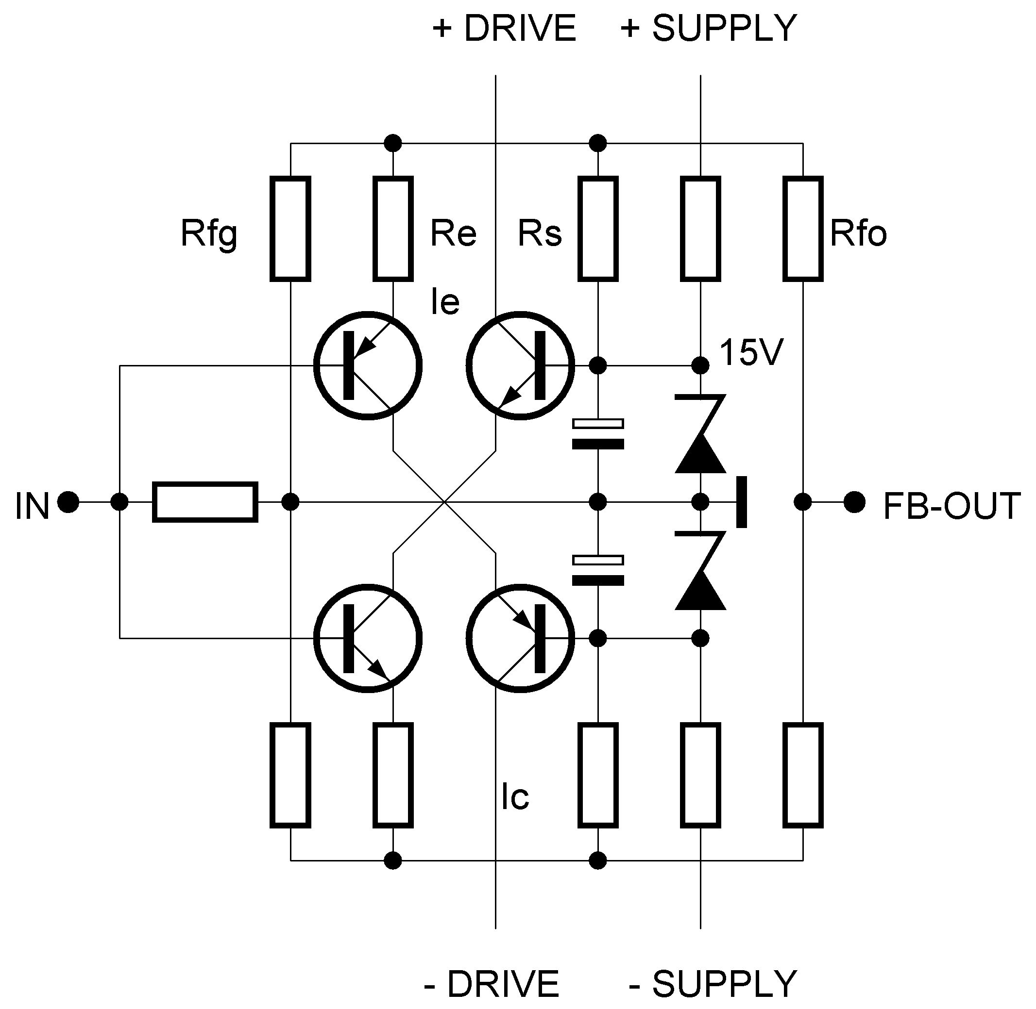

SSA front-end collector current:
Ic=Ie-Ic/β
Ie=((15V-0,6V-Re*Ie)/Rs)-((0,6V+Re*Ie)/(Rfo*Rfg/(Rfo+Rfg)))
Ic - desired cascode collector current
Ie - emitter current through input BJT
β - input BJT current gain
Re - input BJT emitter resistor
Rs - current supply resistor (resistor connected between 15V supply and emitter resistor)
Rfo - feedback resistor from OUT
Rfg - feedback resistor to GND
Simple as that. ;)
