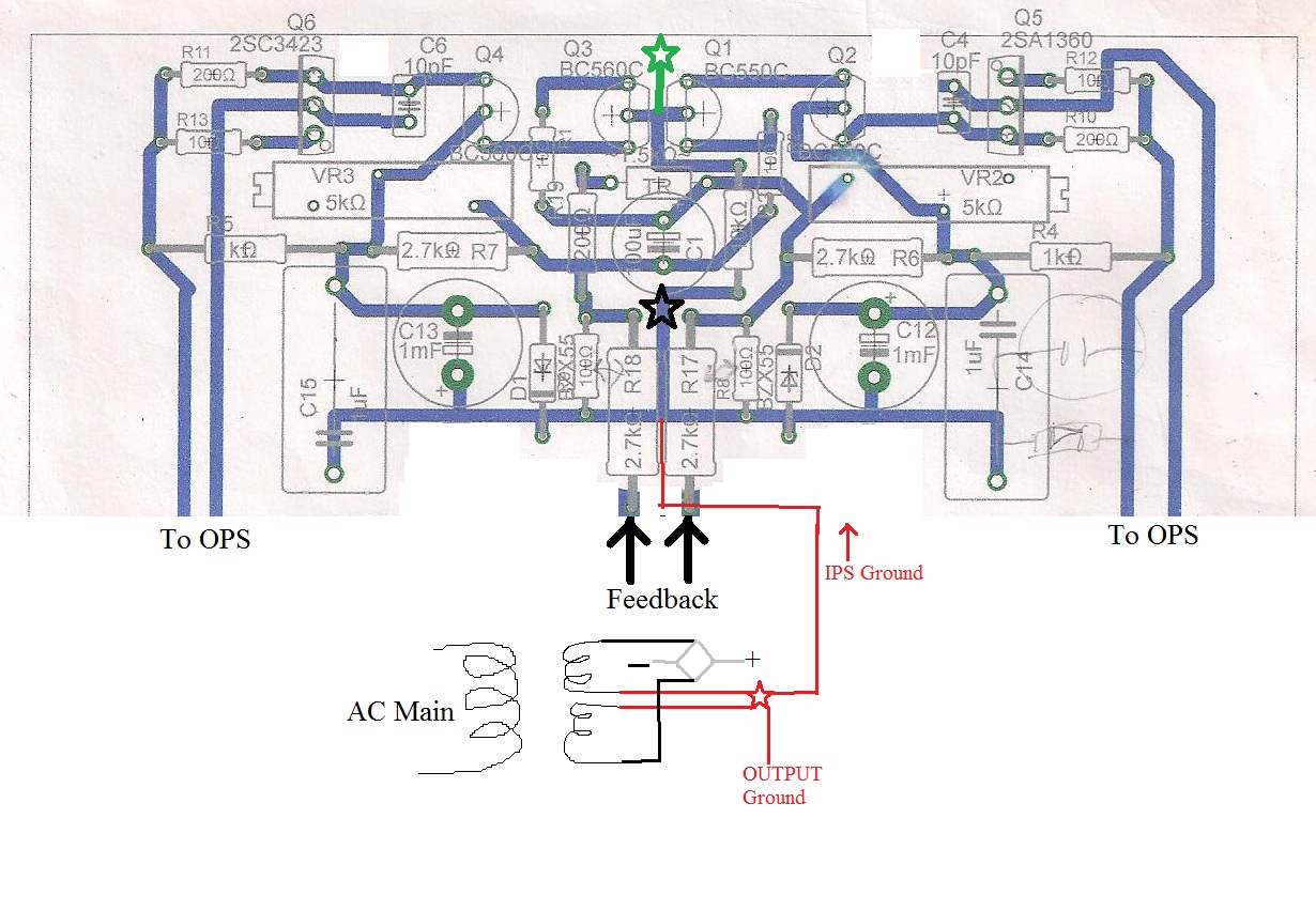

HI, lazy cat, still remember me ? Due to alot of reason, I couldn't construct my SSA until recently, I finished it and tested Still blur about what update/upgrade on SSA since I leave for a while.
Last time was ruin by AC surge so this time I put 25V regulation on supply rail. It went nicely just some noises appear due to outside factor.
The board is not yet encased, everything is anywhere around the area of my work. I also integrated the NTC and it makes it really thermally stable alot But it still suffer from noises from input. I also intergrate a 10pf bypass cap on VAS, could it causing the problem ?
The problem is temporarily solve when I grab the input line with my palm, or if I disconnect the input wire (then I have no sound ) So I hereby come to seek advise from forumers to solve this problem ? (what is this noise/problem called anyway ?)

Is the grounds wiring correct everywhere ? Is the shield of the inputs plug connected to the star ground point of the amp?The problem is temporarily solve when I grab the input line with my palm, or if I disconnect the input wire
Is the shield of your input cable well weld ?
Is your source clean ?
If yes, may-be you have some oscillation problems
my star ground plan is slightly different, the first star point is when 2 trafo secondary ground meet with output, then another star point. Its conplicated to describe in correct way, so I attached my 'semi'-layout. The green star where input signal line attached, black star for input ground line.
Since I modified alot from this original layout I made, I also don't have any nice-look updated layout about my current board. The IPS is remain almost the same, so I modified slightly in the attachment.
As for the input cable, I use very cheap ones during testing (can see from outside 2 wires side by side, thus not shield as all I think) since mine only input wire, not yet put any female mounting/adapter, so I connect by crocodile clip only
Maybe my source is not perfectly clean, but not that noisy at least I know. (achieved better noise level than this before) Does oscillation can be heard ?
Just as the reference, I measured the emitter resistor to get the current consumption. They are stable even with music playing.

Thanks for your reply and help.For the VAS, without noise it was around 10mA. When noise occur, it went up to 13.5mA.
For IPS (first pair), it rises from 3.85mA to 4.2mA when noise introduced.

Hi Leong
Of course I remember you and I wish you'll successfully build something with SSA in its name.
Look when someone starts to play with the design involving some changes like PCB, some parts etc, it is absolutely necessary to have some gear on your desk like scope, PSU with soft start, serial rail resistors for safe work in initial phase of testing and calibrating, digital rms meters, signal generator.
Simply you have to "see" what is happening on the output and other parts of the circuit as well, to take apropriate measures to eliminate anomalies like oscillations etc.
In your case you definitely have a problem with HF oscillation, which raises the bias current level in certain stages and represent as hiss-noise heard from speakers when connected to the output.
So my advice is to go step by step and each step has to be cleared-understood before proceeding to next one.
Regards, Andrej
P.S. I suggest you to go for VSSA

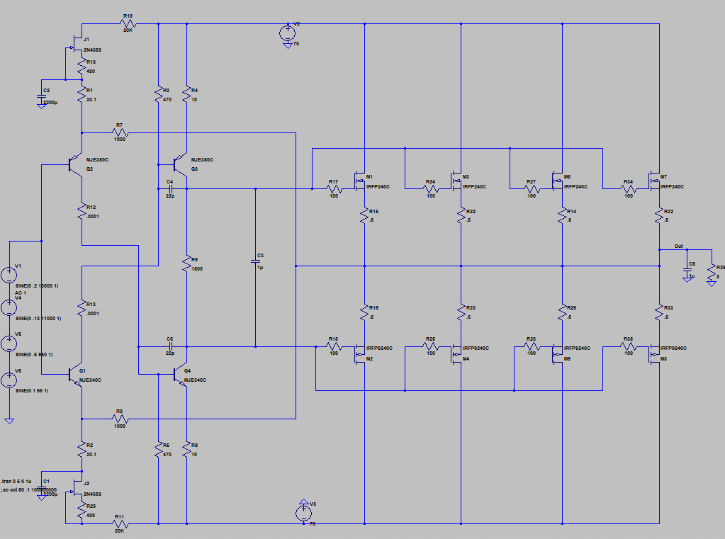

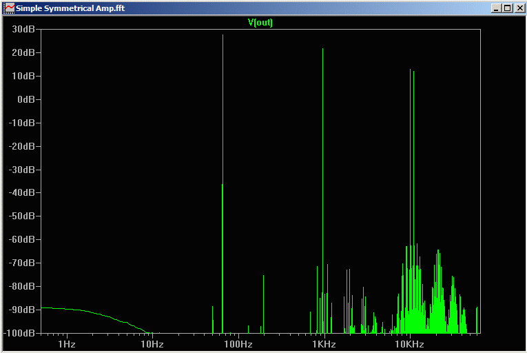

Here's what I got with 480W instantaneous peaks into 8 Ohm. This is a multi-tone IMD test. Excellent results!
Please try to simulate the same circuit but first change R10, R11 with high impedance CCS, lets say formed by j-fet.
Ok, sorry for deleting that last post. I'm tired and wasn't paying attention when I went to edit it.
But here the results using a current source in place of the resistors, same 4 tone IMD test. Still great results simulating what would be more like a music signal.
