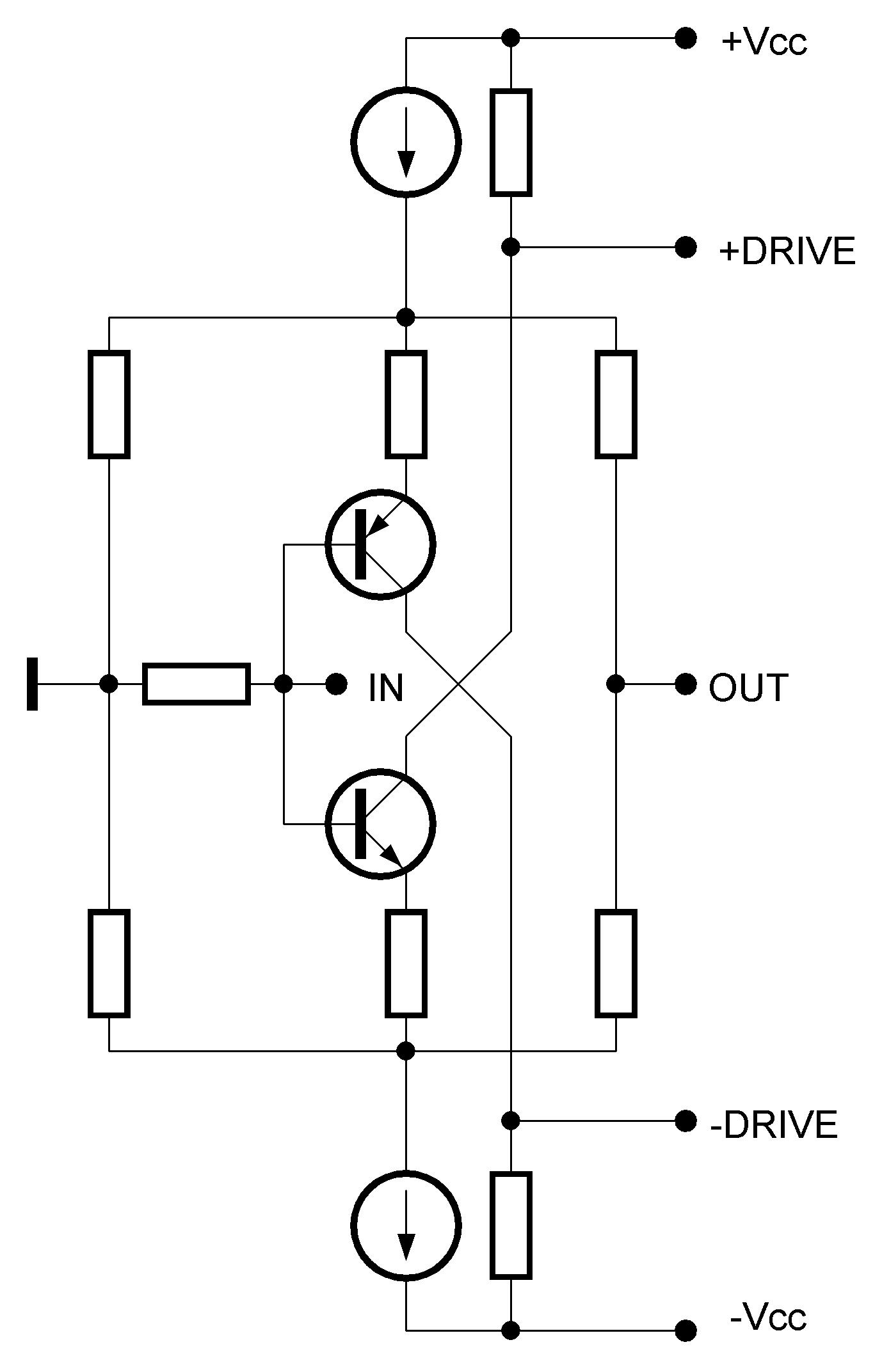

What would be the "ideal" bias? About 17ma current flows across the resistor with the current setup(+/-75v)....Is it too high?

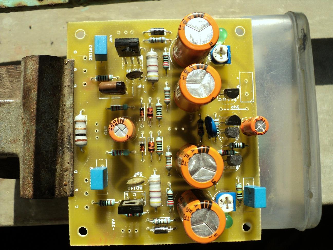

Everything worked to my expectation, except the dc offset, which goes up / down (+ / - 50mv).

Hi, I just noticed your circuit is different than the one used in BIGBT HP. If I'm not mistaken your approach has been used by Shaan. The 17mA you mentioned is flowing to the regulator. The input itself is biased less than that. Around 8mA I guess.
I think there is nothing wrong with "hot" regulator (as long as there is sufficient heatsinking). I don't know about the "optimum" bias for the input. I have used around 10-12mA.
ADD: May be Shaan has a comment regarding this regulator (CCS). I think he didn't use it at the end.
IMO, the amount of current needed to flow through the input pair for a VAS current of 10mA at +-65V in your case would be "ideal". It could be as low as 1mA into the input trannies. Measure the VAS bias and if it's about 10-15mA then all's well.
It should not if the input pair is thermally coupled with a cable tie(zip tie) and a drop of heatsink paste. In the picture it looks like the input pair and the cascodes are well placed(face to face) but the center two transistors(possibly the input pair) aren't tied together. I think this is causing you the offset problem.
Also the schematic shows no 10K from the conjoined bases of the input pair to ground. This could also cause offset problems due to lack of base current at the inputs.

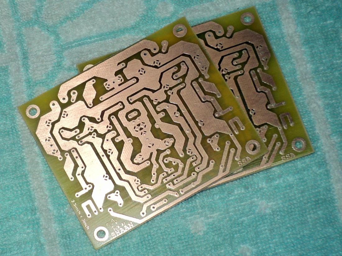

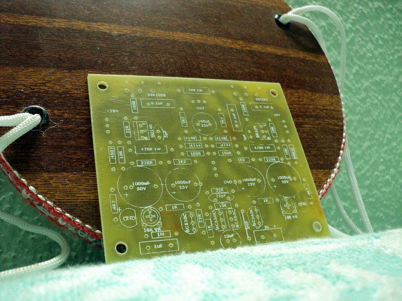

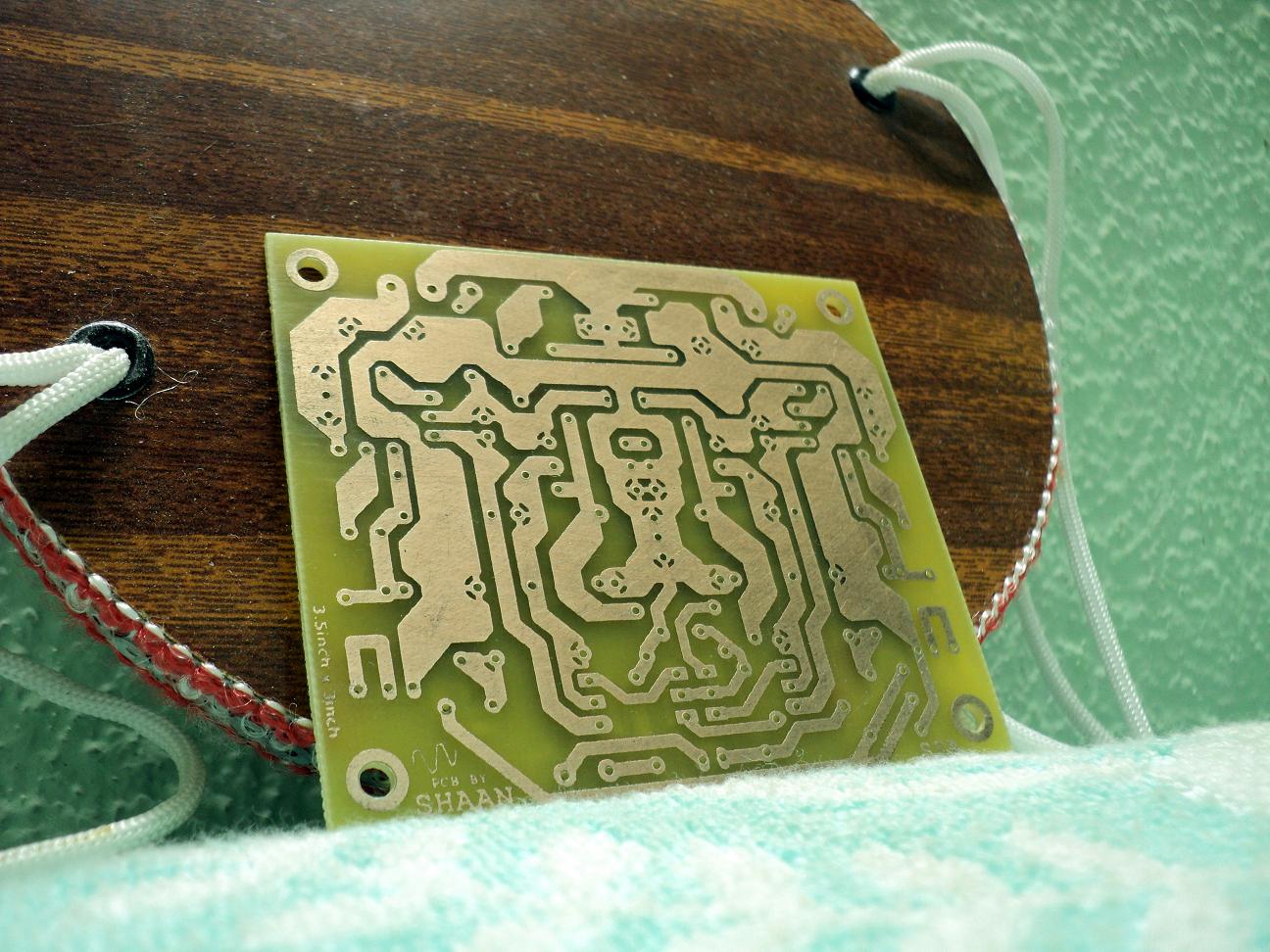

I finally got my first PEECEEBEE and first ever PCB. Can you imagine?
My local DIY friend Bhaskar has printed six SSA boards. Yesterday I was on a visit to his home and had some unique experiences.
First, he's a genuine music-lover; has over 3000 pieces of gramophone records and most of them are pure gem recordings. Many dating to 65's! I had my first experience of listening to analog recording and I was completely blown away. The realistic feeling of the music just froze me and now I know why people say that once you get into analog, there's no coming back.
Second, he is a very kind person. He provided me with two of the six SSA boards made and now I have my own designed peeceebee at hand. :cloud9:
The peceebees look very well etched without any errors.
Now I'm on the way to build a pair of SSAs in the pro way LOL.

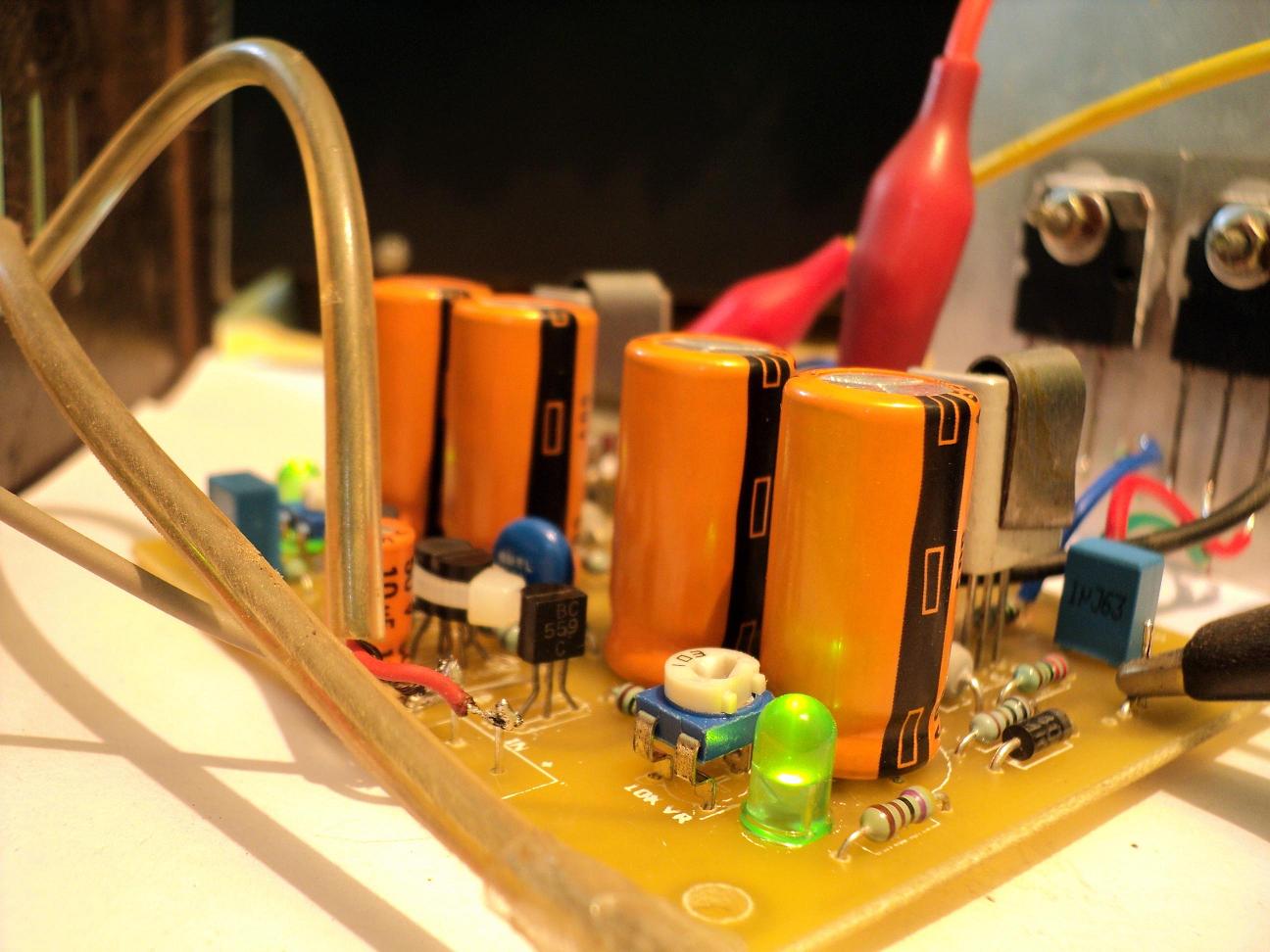

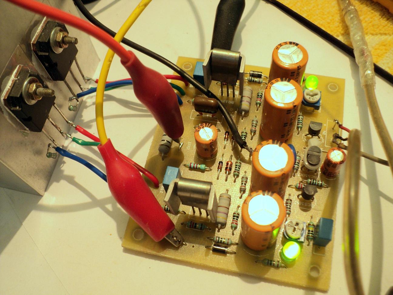

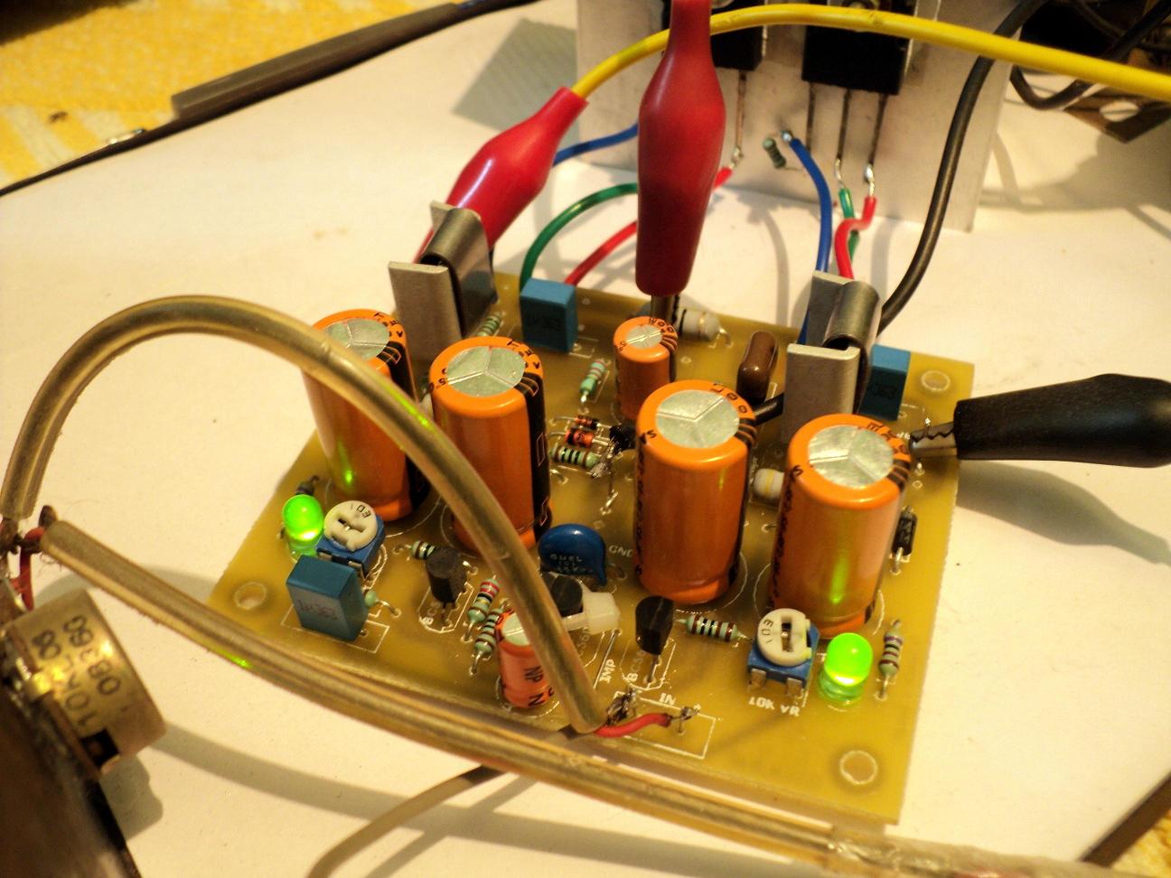

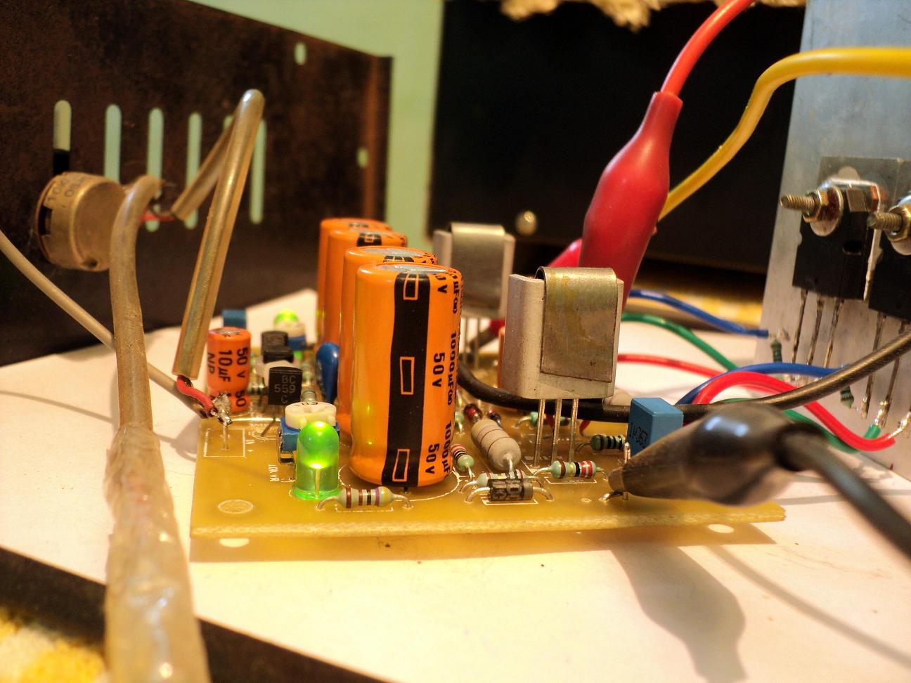

And here it is. Running smoothly.
Offset setting was pretty easy; within +-5mV.
Bias perfect with 3mA, 14mA and 160mA in input, VAS and FET respectively. Without any manual setting. The input BJTs are BC550C and BC559C.
Sounds just like an SSA.

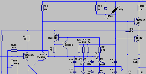

Magna's SSA HP for PA

Hi Magna :wave:
Comments as I promised:
- Q3, Q5 must be firmly thermally coupled, glued or grease + wraps
- input CCS-s should be top quality with thermally independent reference as in #post 3034. Replace Q8, Q11, Q12, Q13 with reference CCS-s
- C7, C62 lower to 100 uF
- C10, C34 remove these 47 pF caps, install trimmer-caps and find optimal sweet spot between lower and higher freq oscillation
- C16, C18 higher to 1000 uF
- optimally and effectively front-end should have 5 V higher rails than output stage
- C1 should be 10 uF, C5 100 pF
- D1, D13 recommend to change to 1N4732 - 4,7 V
You can fill in the whole 5 output pairs on PCB for 2 ohm loads capability.
Looking forward to see your modifications and reports. :yes:
