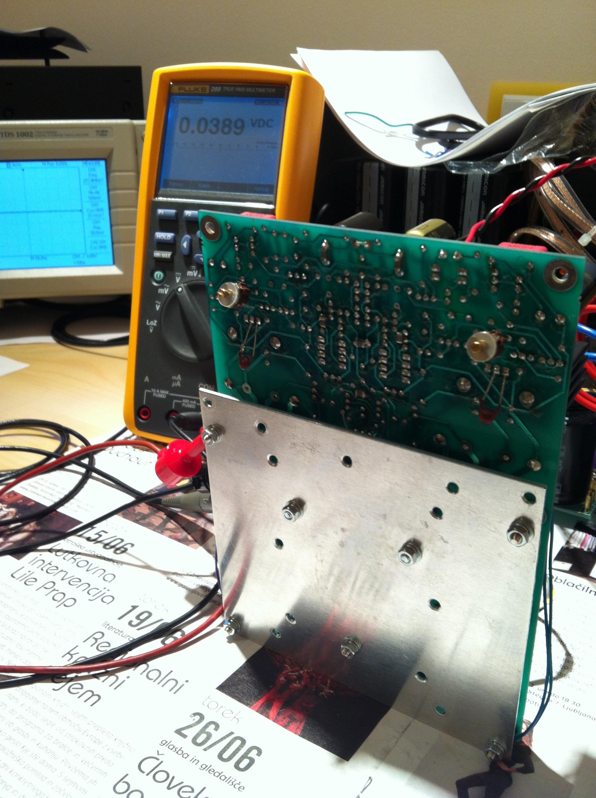

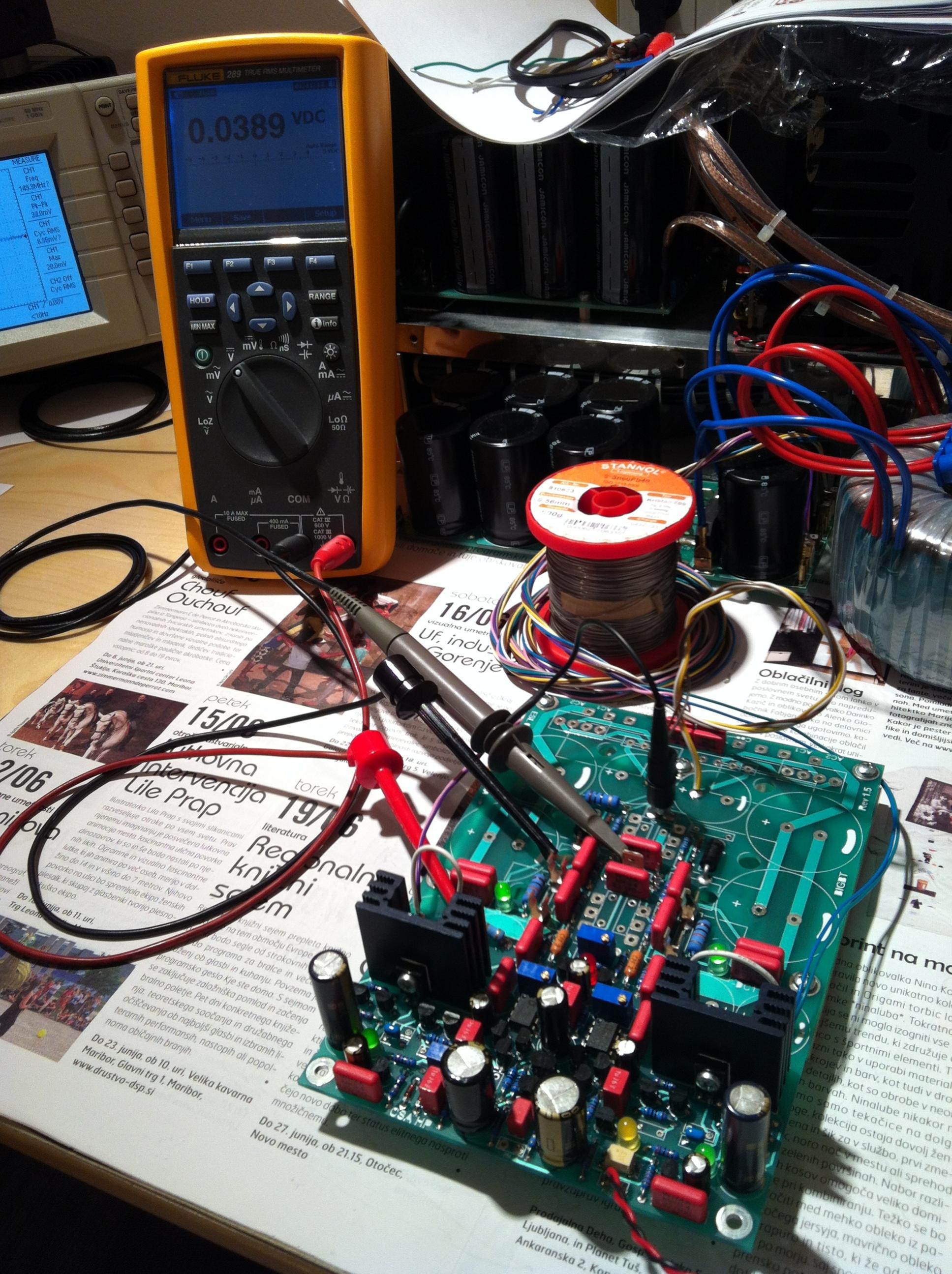

CSA first test
Thanks for a short explanation.

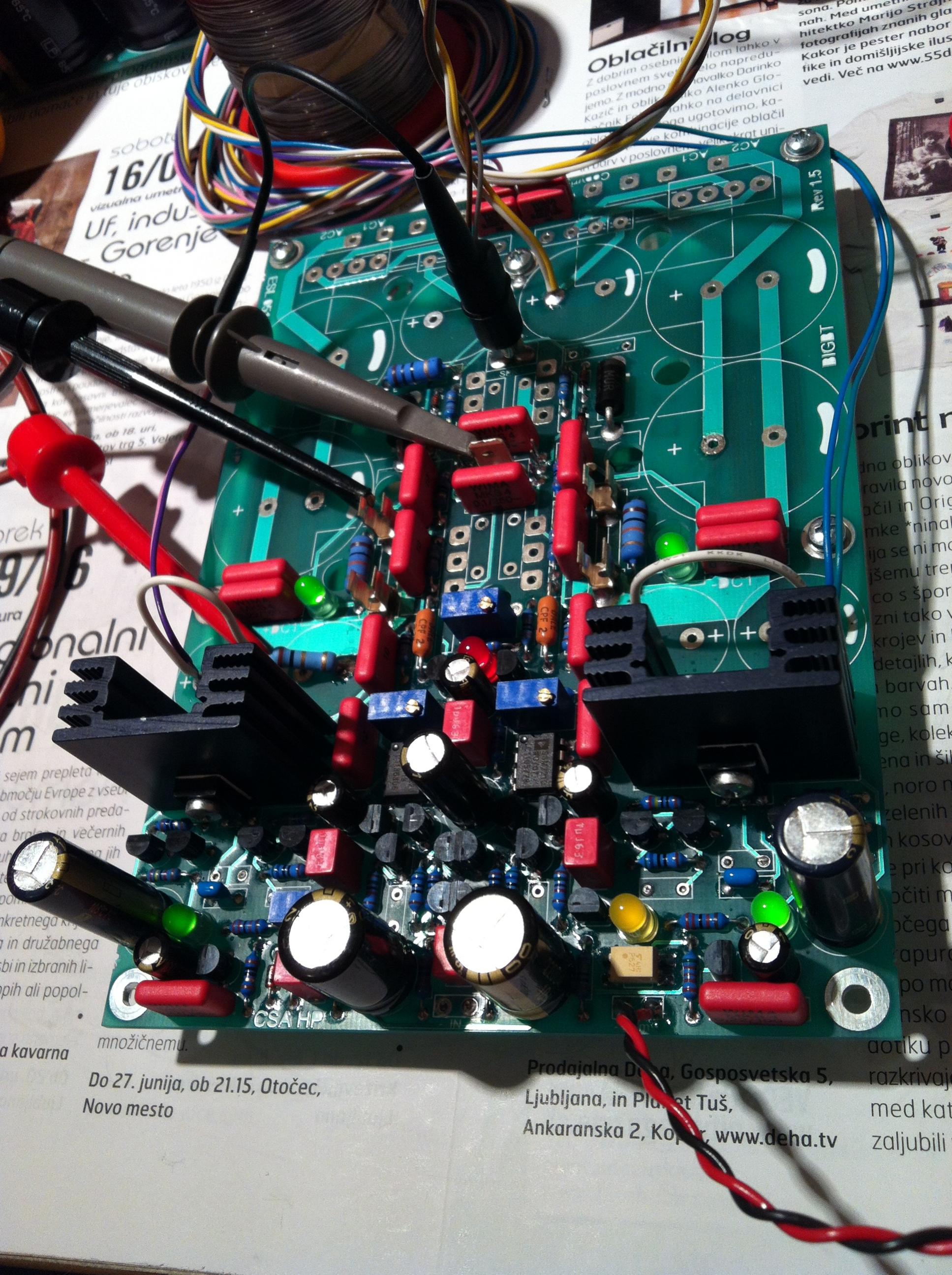

I give you more, CSA prototype on testbench, front-end plus mosfet drivers, compensating scheme done, bias set to 38 mA through IRF drivers, stable with only few pF on four different places. Offset stable, VAS bias stable, drivers bias stable. Next step to add the output bipolars, but as expected probably nothing will change.
Did i see some kind of servos with OPAs ?Offset stable
Or is-it CSS integrated circuits ?

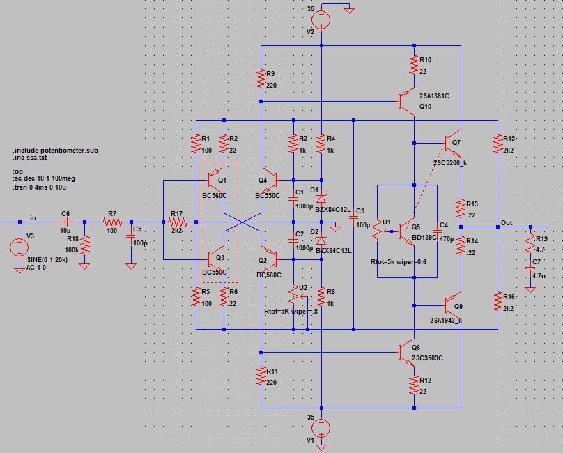

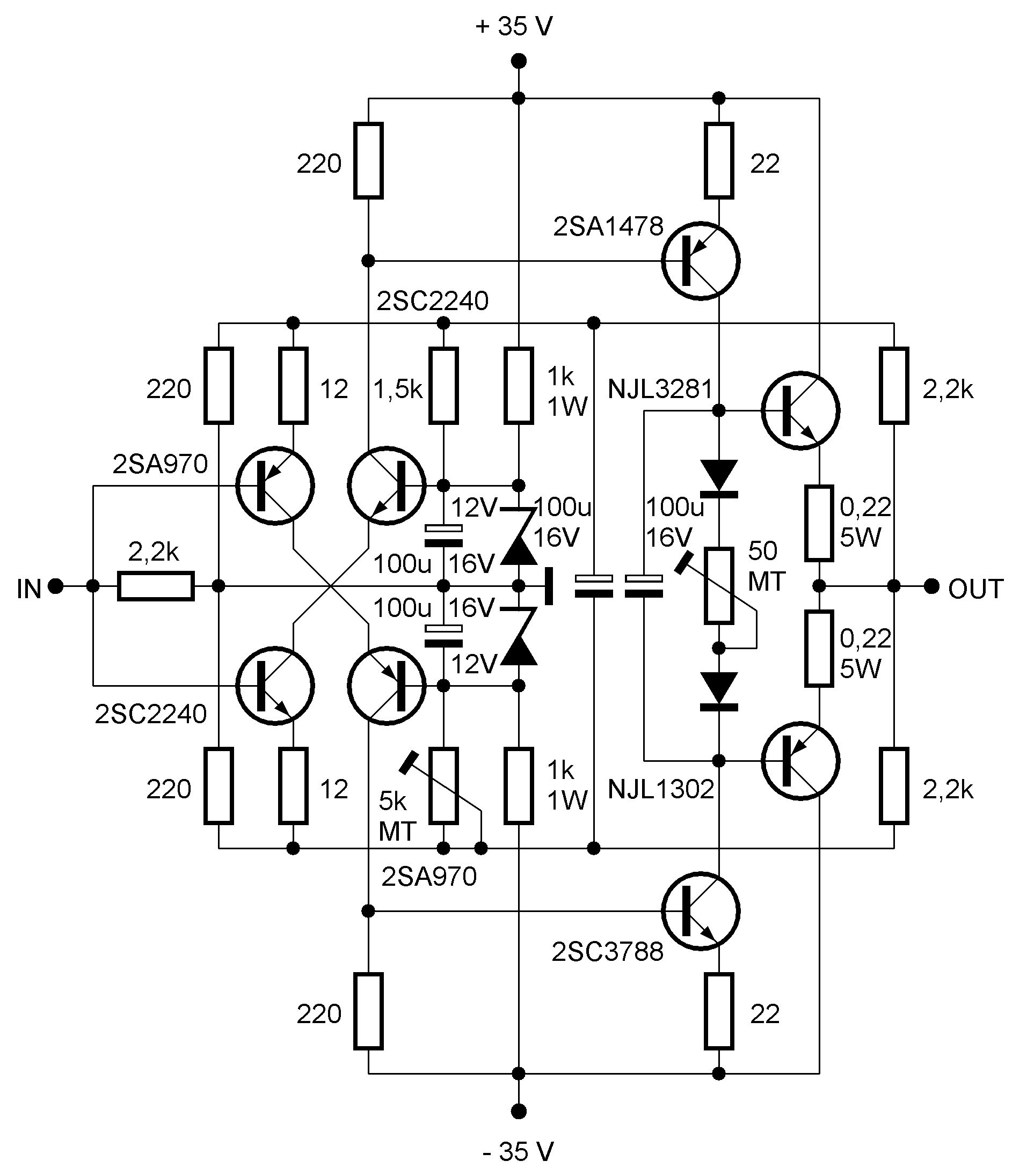

Sir LC..if you have a time, would you please check my schematic value? i would like to build my Allbjt SSA.Dear LC,
based on ssa bjt basic please check my component value.
Thank you.
Dear MiiB, please don't get me wrong.Naf.... I see you have it in your simulator... Why don't you run it and check for currents soa ect. your self... Asking somebody to check your work without the tools is kind of rude... This DIY and NOT We spoonfeed you everything.
I'm new to this electronic world, start to learn 2011.
I learn as hard as i could, even i don't know that paralelling zener diode is big no no (thank to sir Esperado and Shaan).
Try to using ltspice just two month ago.. that why I ask sir LC because i'm not sure with part value in my sim. Left pic is SSA BJT (with blank value, this is my based). I try to fill the value as i could. Why I ask sir LC? he is the inventor of this simply beauty amp. Do my asking "if he have a time to check" is kind of rude?
And if you or anybody think i've asking to much that's fine... no problem. Everybody starting as newbie.

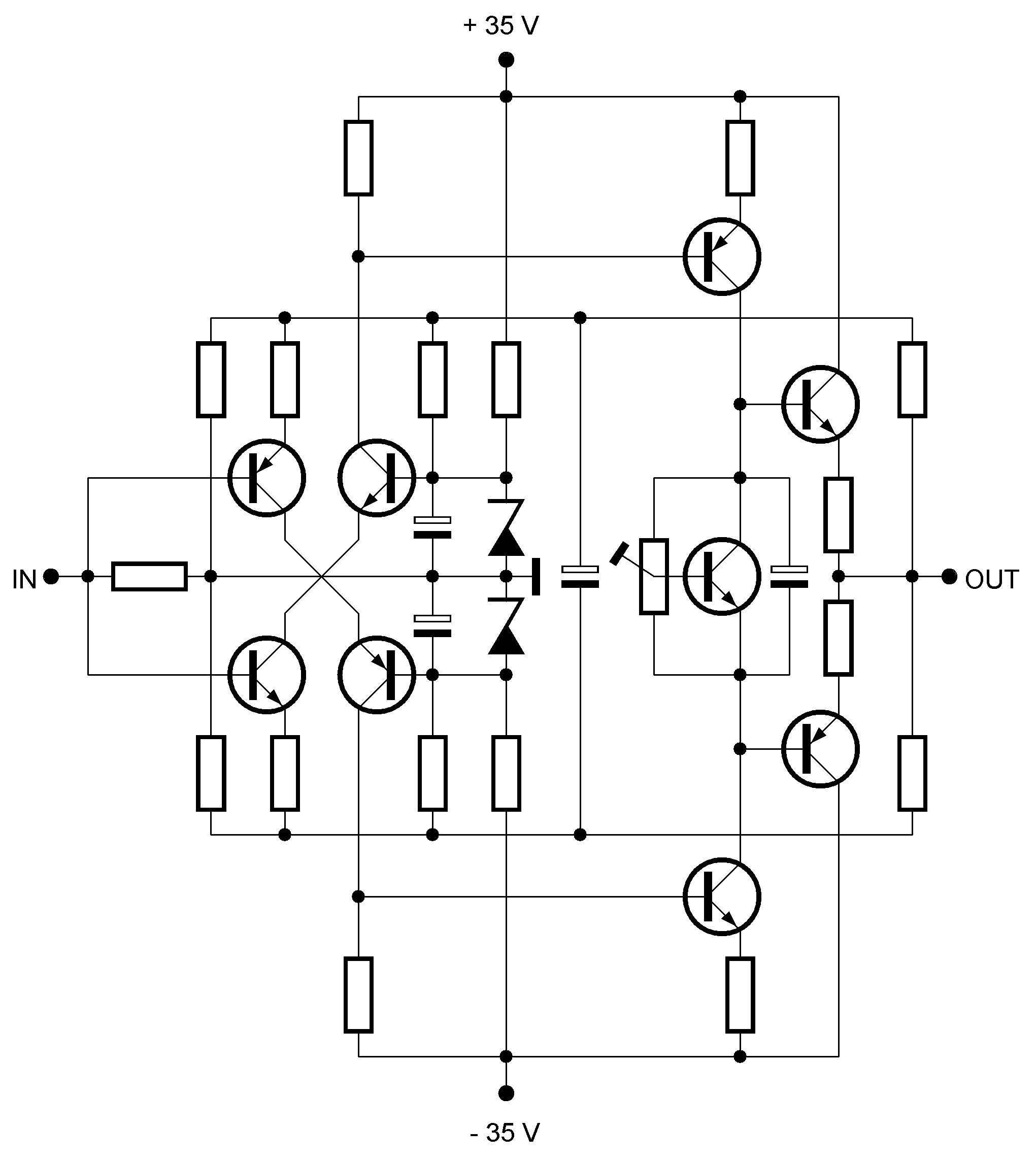

- Simple Symetrical Amplifier
