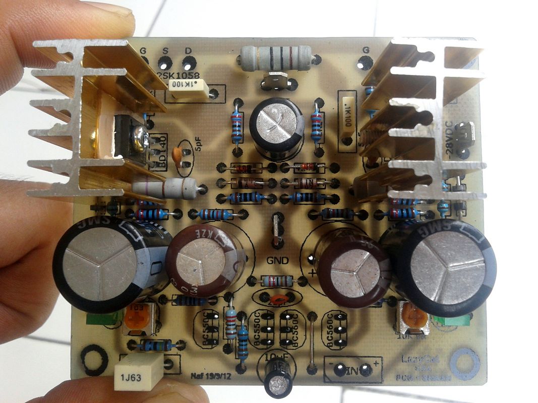

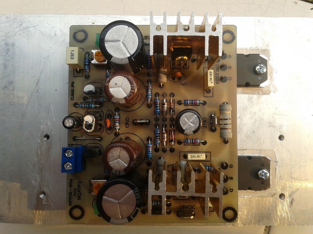

Hi Shaan/LC
I've finished my build today.
Before i powered up this Amp, please guide me how set dc offset, bias and anything i should care.
Thank you.

Hi naf :wave:
First time powering demands some steps:
- short the input with piece of wire
- connect 47 ohm/5-10 W resistors in series with +/- supply wires. That will protect your SSA amp if something is not correct or against oscillation damage. If everything will go OK, you will have cca. 4,7 V voltage drop on these resistors at 100 mA bias current.
- both trimmers should be set to max resistance before powering up
- connect DC V-meter (set to min range) between +OUT and GND
- also use second DC mV-meter to control the voltage drop on 47 ohms resistor at + rails wire
- power up the SSA and than slowly increase the current by turning the trimmers in a way that output voltage is always around zero DC. This is performed by setting-rotating the trimmers separately, first one, than another, than first ... and so on
- if all is OK with raising current up to 100 mA (4,7 V voltage drop) than you can connect SSA directly to power supply and set proper bias current. At this point use 3-5 A fuses on 47 ohm resistors location.
- output DC should be in a range of +/- 50 mV
- if you don't have the scope than 12 V/5W bulb will show you that there is no oscillation at output, simply by not lit at all
- unshort the input and connect the signal
After using SSA for some time, these fuses can be replaced with stronger ones ie. 10 A or removed completely.
That's about all. ;)
Thank you LC,
i've followed your guide and, i got my dc offset unstable, the best i can get is -33 mV but it's hold no longer than 1 minute and keep changing.
i use 10 ohm/10W resistor on + rail and my second DMM read 320mV.
is there any tip to stabilized my offset?
Thank you.
Thank you LC,
Thank you.
With 10 ohm, V drop has to be between 1V and 1.5 V (100 -> 150ma)
once set, and offset roughly minimized, close your rack, and let the amp heat for at least 20mn to let temp stabilize inside. Then carefull tune again your offset (as fast as possible)..
It is normal than your offset rock'nroll, and +-33mv is something you can consider as null.

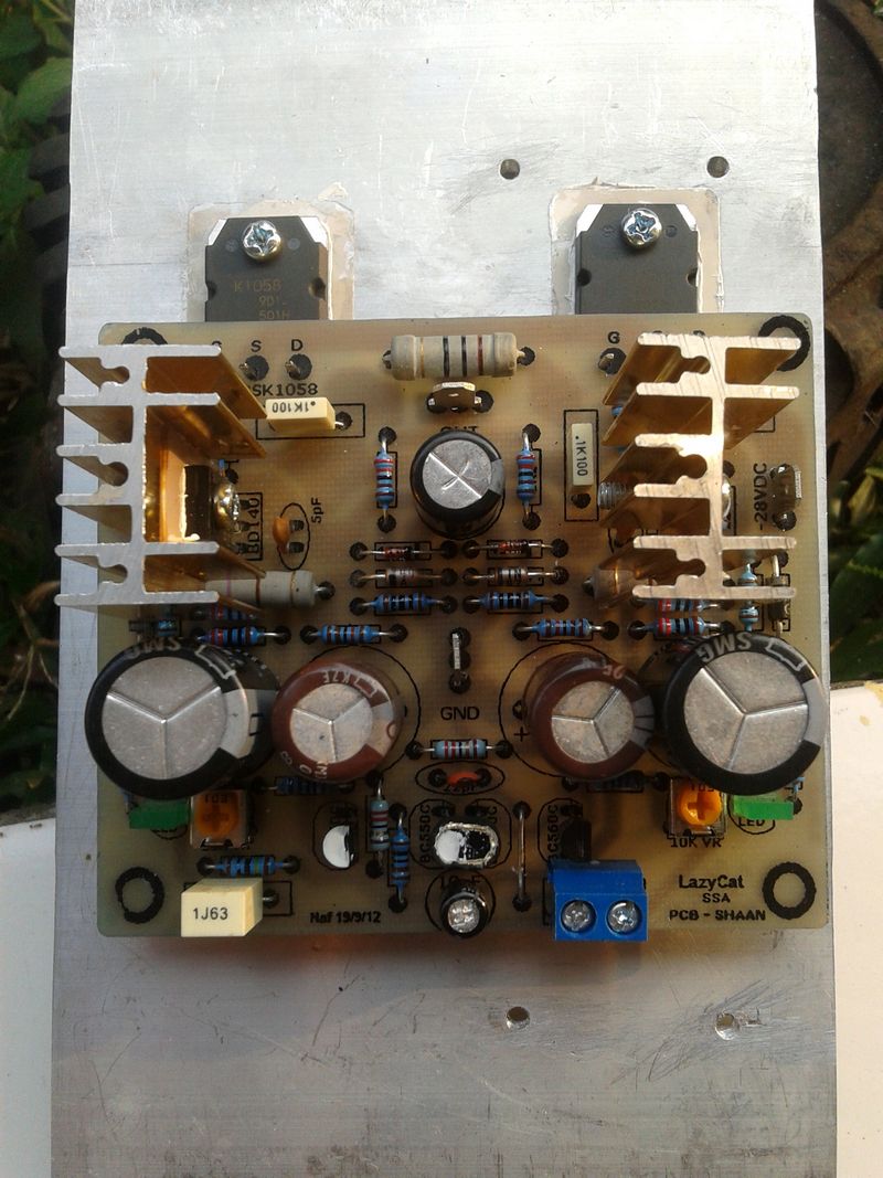

By rotating the trimmers, you actually change input stage bias, so you should get + V or - V at the output, not just mV, you can rotate one trimmer strongly and you will get let say + 10 V on the output.
So if your output DC voltage-potential is only negative - V, that means something is not working.
Please remove 10 ohm resistor and connect two 47 ohm/5 W on both rails, since these resistors are not there for measuring purposes but for protection against failure.
Whan you will have app. 0V at output, 100 mA supply current (4,7 V voltage drop) and no oscillation, than and only than you can remove 47 ohm resistors and connect SSA to power supply directly.
Please check the schematic vs. PCB and parts values. Good luck ;)

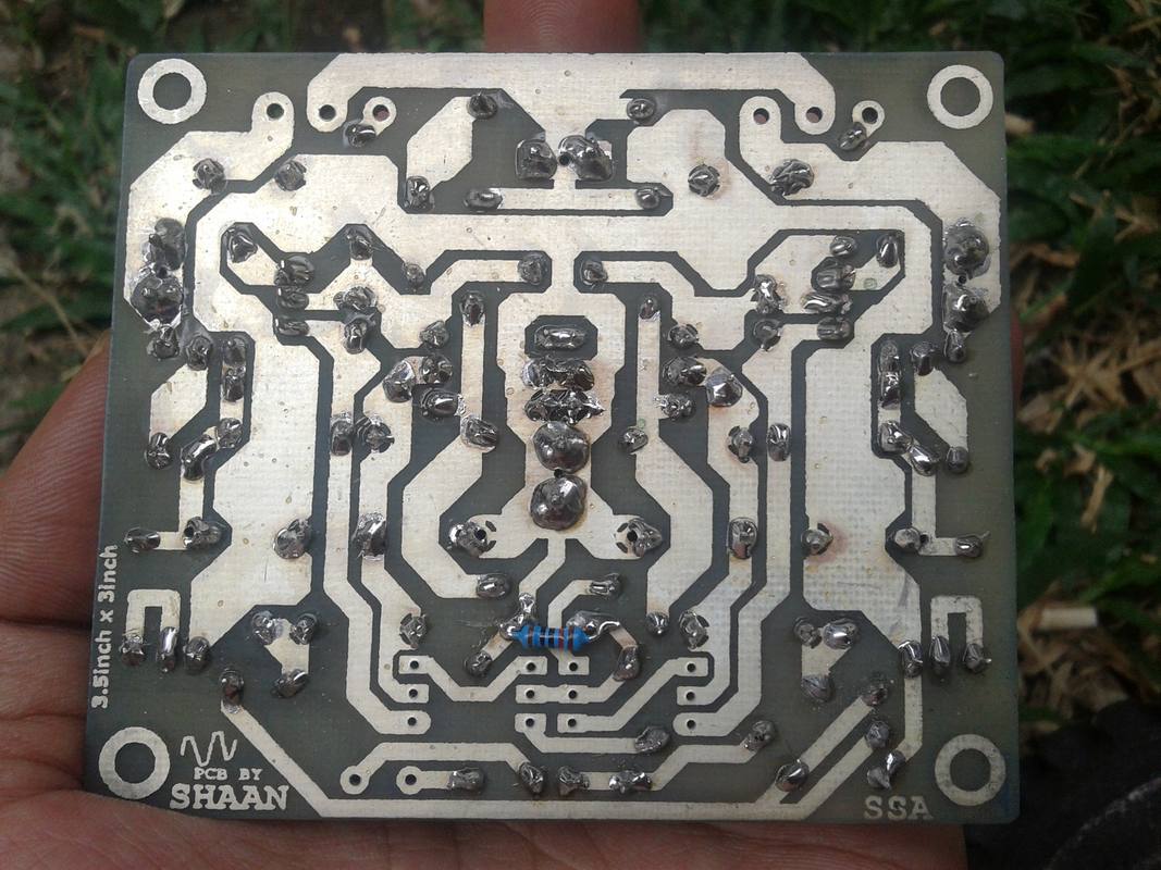

Hi naf.
About the pots, when you see the offset is increasing when turning one of the pots from maximum resistance then turn it back to its maximum resistance again and then turn the other pot, this will ensure a successful zero offset setting.
Also, if the output doesn't drift equally to +ve and -ve as you turn the pots then it means one of the input BJTs is under-biased and is unable to control the VAS at its collector due to lack of enough current through that input BJT. You can check the voltage at the 22ohm at the emitters of each input BJT and have a reading of at least 66mV for an input bias of 3mA; if less than this then the output might be stuck to only one polarity as the NPN and PNP input BJTs have different electrical characteristics.
To increase bias at the inputs you need to decrease the 1K2 resistors, which may need to be decreased to 1K or less for good bias of the inputs. The easiest way to do this is to parallel one 22K resistor with each 1K2 and test the input bias at the 22ohm resistor. If paralleling one doesn't make it more than 66mV at the 22ohm resistors then place another 22K with each 1K2 and check again. This way you will safely reach more than 3mA of input bias and the offset will then be symmetrical and easy to set to zero.
:2c:
WUUUUUU HUUUUUU..:cheers: :hug: :worship: :violin: , i'm pretty sure i'll hear the sonic of SSA tomorrow, it's late night so i can't test the sonic...
here what i've got.
DC offset 0.3 - 3.9 mV
stable bias at 198 mA
vas current 340 mV at 22r
THANK YOU SHAAN, LAZY CAT, ESPERADO for supprot and help, hope more newbie will build this AMP.
