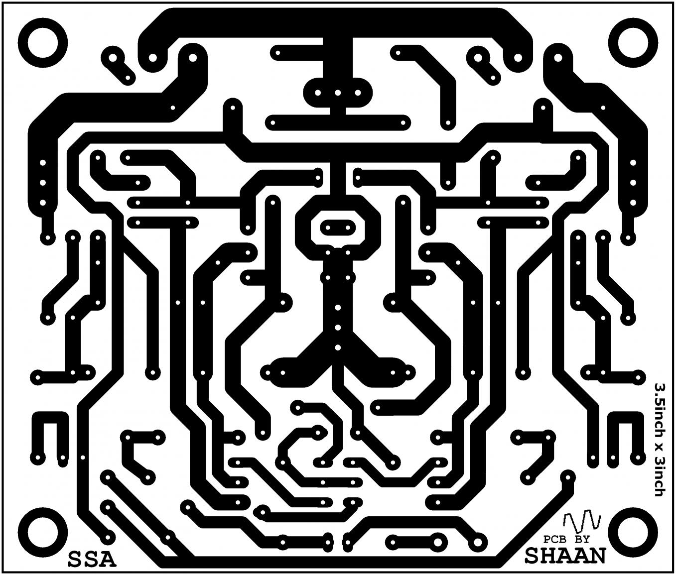

I tried to draw a PCB which will look like the attachment.
Dimensions:- 3.5" X 2.8"
Currently rendering the bottom artwork for toner transfer process. Will upload once done and checked for errors.

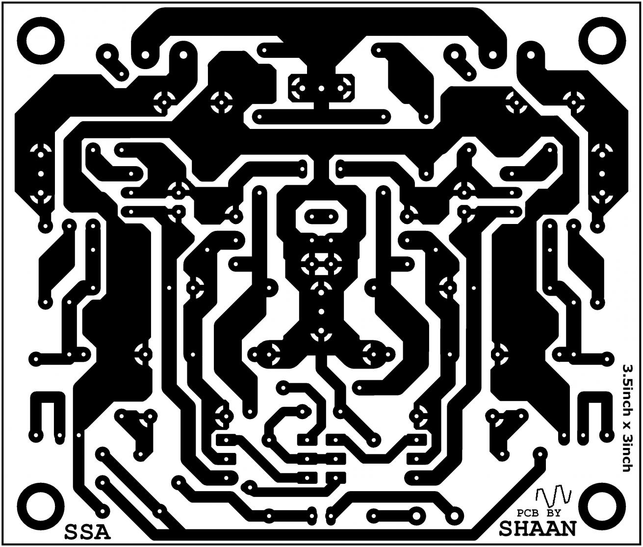

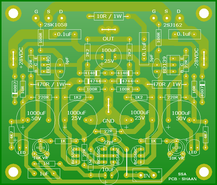

BTW, The layout for my pee-cee-bee (or whatever it may look like) is ready and will be uploaded shortly.
Rookie job, please be gentle...
Some mods:
1. There's an input cap, everybody knows why. It's an electro ; but trust me once the SSA is up and running, it vanishes.
2. Fixed FET bias of ~150mA with two 1N4148(only 1058/162 tested, ECX not).
3. 10ohm after 1N4007; apparently lowers turn-on thump/hum.
4. 1K+22pF input RF filter.
5. Couldn't eliminate the only one jumper. Sowy.
6. Simple potentiometers; no multiturn. As I found it unnecessary for setting the offset.
7. 1K in series with pots to protect them in case accidentally both set to lowest resistance.
8. Zobel added(of course ).
9. 1M before input cap removed. Pretty unnecessary if you ask me.
10. Front end and VAS bias can be varied with changing 1K2 resistor's value, but if the specified BJT's are used then it should not be necessary. Bias with 1K2 measures 4.5mA through inputs and 15mA through VAS.
Both layouts are the same, but the one in the right is a little style-ish having fancy pads and lots of copper.
Comments welcome.
PS. The zip contains higher resolution pics of the layout in PNG format.

dear Shaan, would you update shcematic to reflect mods on your peeceebee artwork?

your artworks is
Thanks for the kind words.
Here is the schema for the peeceebee.
Comments welcome.
