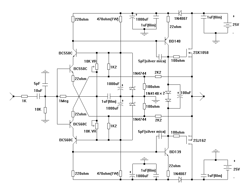

Ah! Thank you, Shaan!
I would like to, if my first attempt is a success, make a modular amp and try different output sections...for example, I wonder how a Sziclai pair would work here, or if it would ruin the performance or if it is just impossible to use it...for that, I will have to study first what the *** is a Sziclai pair, to begin with :D
