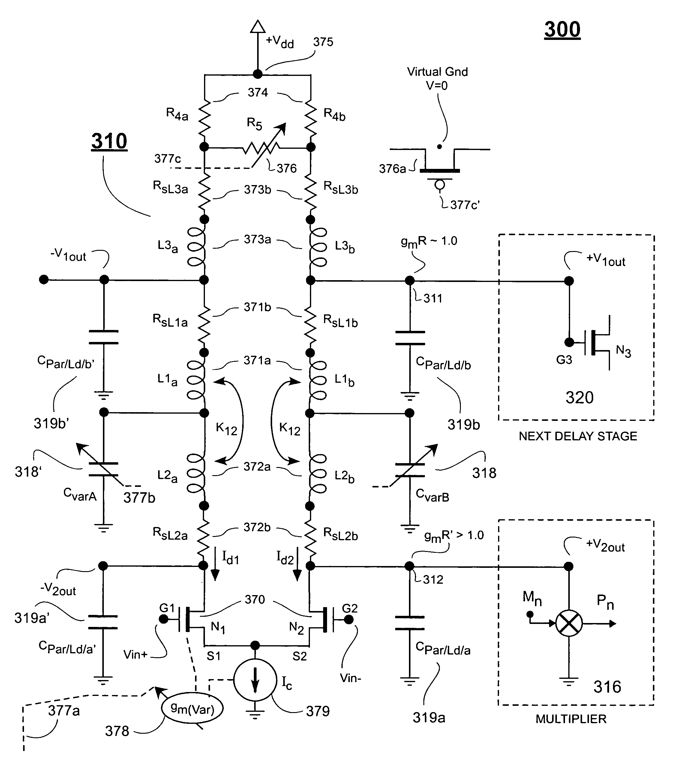

How would you make signal time shift in 100% analogue circuit? Explanation please.
Simple, compare a direct stimulus with the same stimulus that has passed through 10 km roll of cable there will be propagation delay (time delay).How would you make signal time shift in 100% analogue circuit? Explanation please.

There's a delay line in almost all analog scopes. Google is your friend.

... and this analog delay circuit is what, 10 km long transfer link or simple LC circuit?
Fixed frequency signal phase shift with attached circuit is time delayed or what?
A very high order lowpass can look a lot like a time delay. I have often wondered about this. Cables AFAIK at their frequency limits have a very steep rolloff (or is this just an artefact of simulated cable models?). So it does not surprise me to draw a connection between high order behavior and time delay. As far as the feedback loop is concerned, they have similar effects. It is as simple as: at any frequency where a positive input signal causes a greater positive feedback signal, there will be oscillation.
The difference is that, theoretically, phase shift can be restored by compensation, but time delay cannot. However, with very high-order phase shifts, the distinction may become moot, because in the real world only so much compensation is possible.

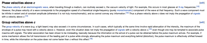

Even if there is phase shift, there is no time delay. What you see may look like it, but no. Even the phase shifted signal responds immediately to input, just the high frequencies are attenuated so perceptually it is different. If you are in the habit of seeing all signals as a collection of sine waves, you may not understand this because the sine wave is a very theoretical concept. Think about it. We interpret phase based on where the crest is. Is this a sane way to look at it at all times though? After all a lowpass does not move the crest by shifting all spectral components back in time - it simply responds to the integral of the sine wave (or whatever the opposite of derivative is). So I think sticking to the high school description of a sine wave will cause confusion because it compromises accuracy in return for practicality.
